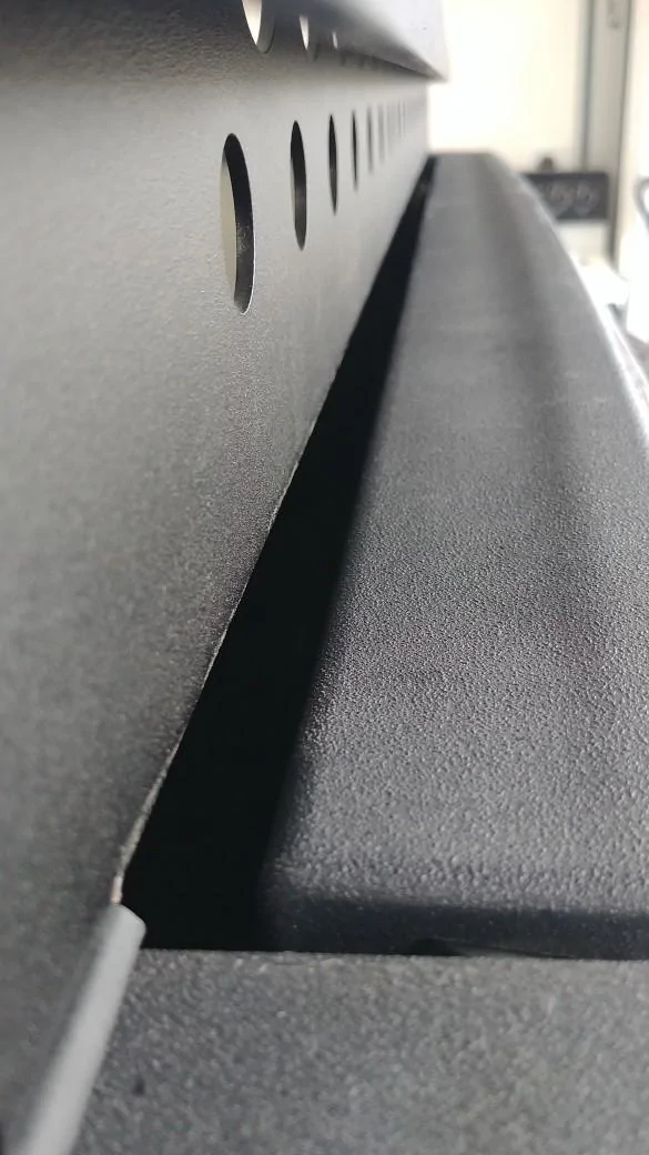

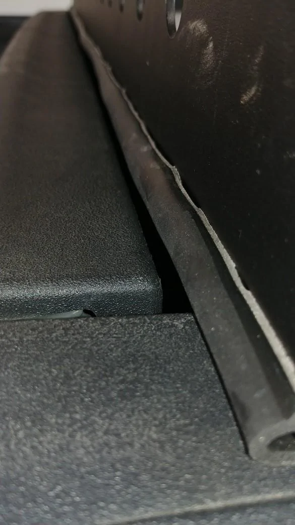

Also, have you guys ever installed on a JT without a bedliner in it? I ask because my truck does not have one and the UD is too short for the rear to seal, at all:
Before adding the weather stipping
Jeep Gladiator JT Gladiator Upper Decker Hinged Cargo Basket Now Available! UDissue1
With the supplied weather stripping installed.
Jeep Gladiator JT Gladiator Upper Decker Hinged Cargo Basket Now Available! UDissue2
Those photos were taken with the UD fully installed. The hings are mounted flush to the front of the bed, so I can't slide the UD back any to get a better seal on the tailgate (and if I slid it back any at all, then it would not seal in the front). I've ordered a 3/4 sear for the rear, but you guys might want to have that as an option on your site for those of us without bedliners.

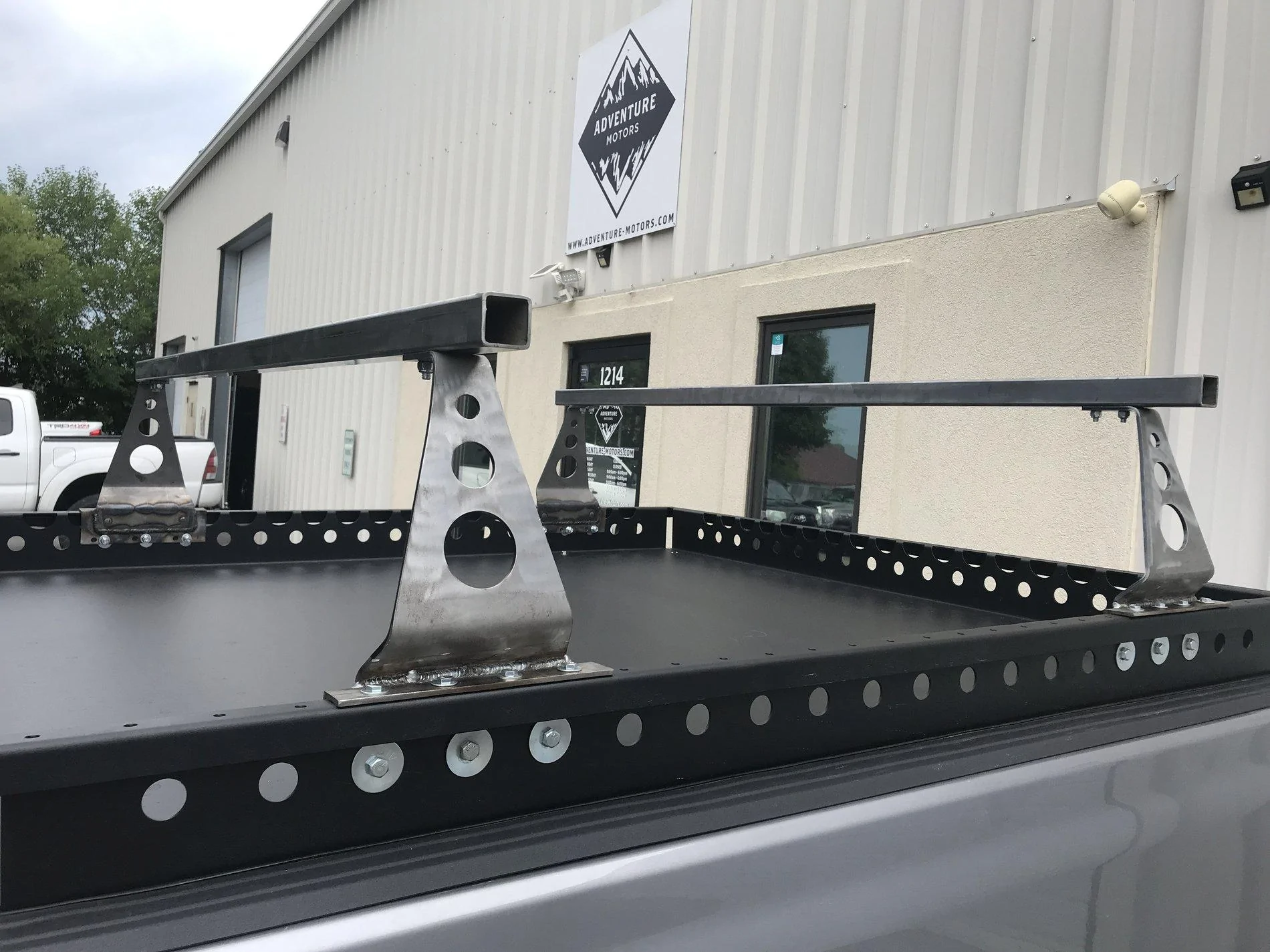

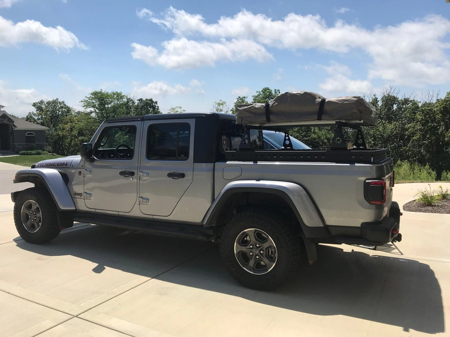

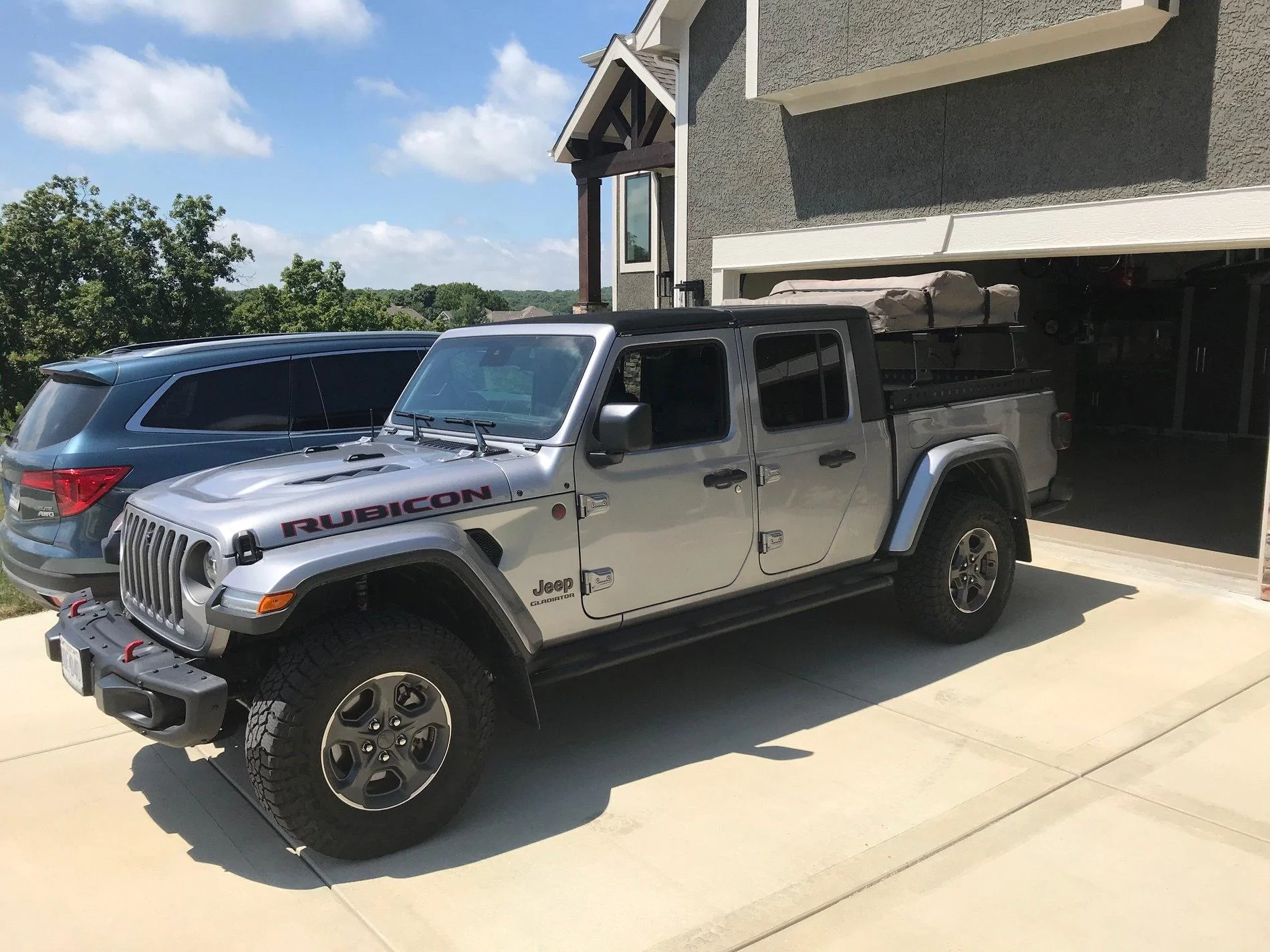

So I finally got my brackets fabricated for my Ace Upper Decker.
I still need to prime and paint the whole set-up (bars, towers, hardware), but here is a pic for now.
The Custom Camping Concepts towers (with cross bars)have been welded to a bracket that attaches into the Ace Upper Decker. Total overkill, but each bracket has 4 bolts on top going into the Decker, and 3 (with washers) in the side holes. It is not going anywhere.
When I reinstall, I will probably not even use all of the bolts - depends on how long it takes me to put them on and take them off!
Once I prime and paint, I'll be getting a Roof Top Tent for this, but I'd also be able to use a Roof basket, or anythign I want with those bars.
Jeep Gladiator JT Gladiator Upper Decker Hinged Cargo Basket Now Available! Jeep with Decker and Bars.JPG

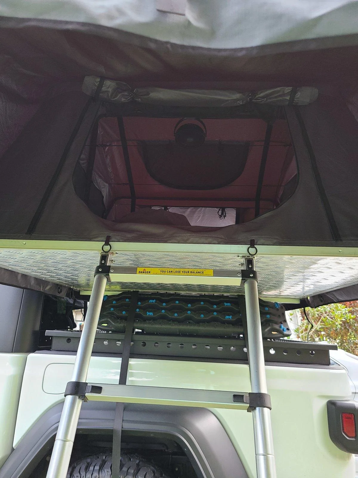

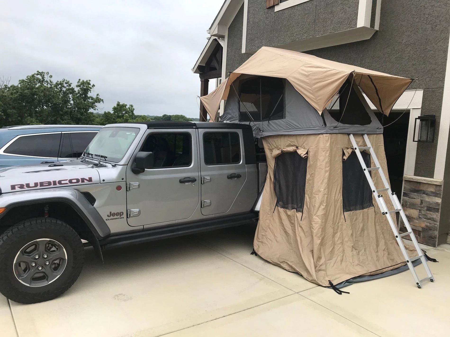

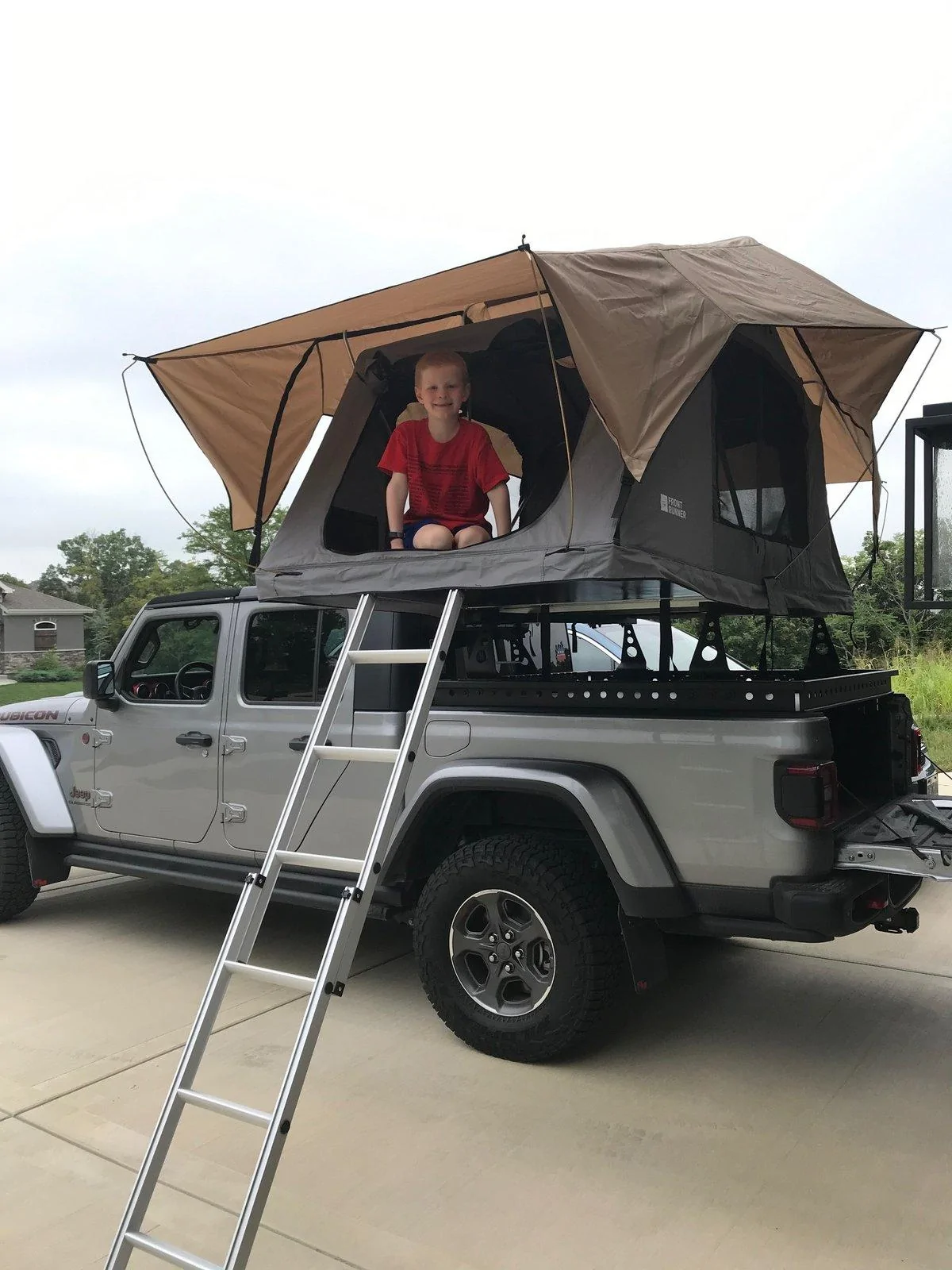

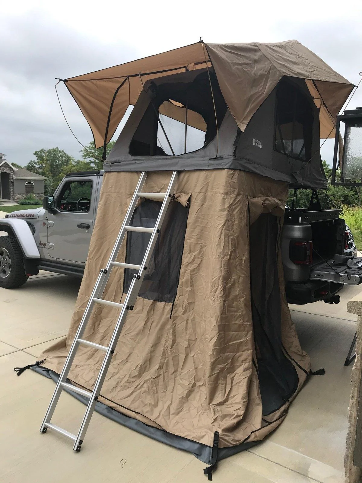

So I have finally gotten my rack parts painted, and my Roof Top Tent arrived, and it's all now put together.
In sum, I have:
1) Ace Engineering Upper Decker
2) Custom Camping Concepts Towers and Bars
3) Welded plates on the Towers that bolt to the Upper Decker
4) Front Runner Rooftop Tent and Annex
It all works great. My only issue overall is that the Upper Decker will no longer stay up all on its own, due to the total weight. I can open it, but I'll need to get something to hold it open if I need it that way temporarily.
All in all, though, I am very happy with the set-up. Driving at speed shows little noise, even with my Bestop sunrider open. Pleny of space in the bed (under the Upper Decker) and on top of the Decker (under the tent). Pleny of visibility out of the back window.
Now just to get out camping!

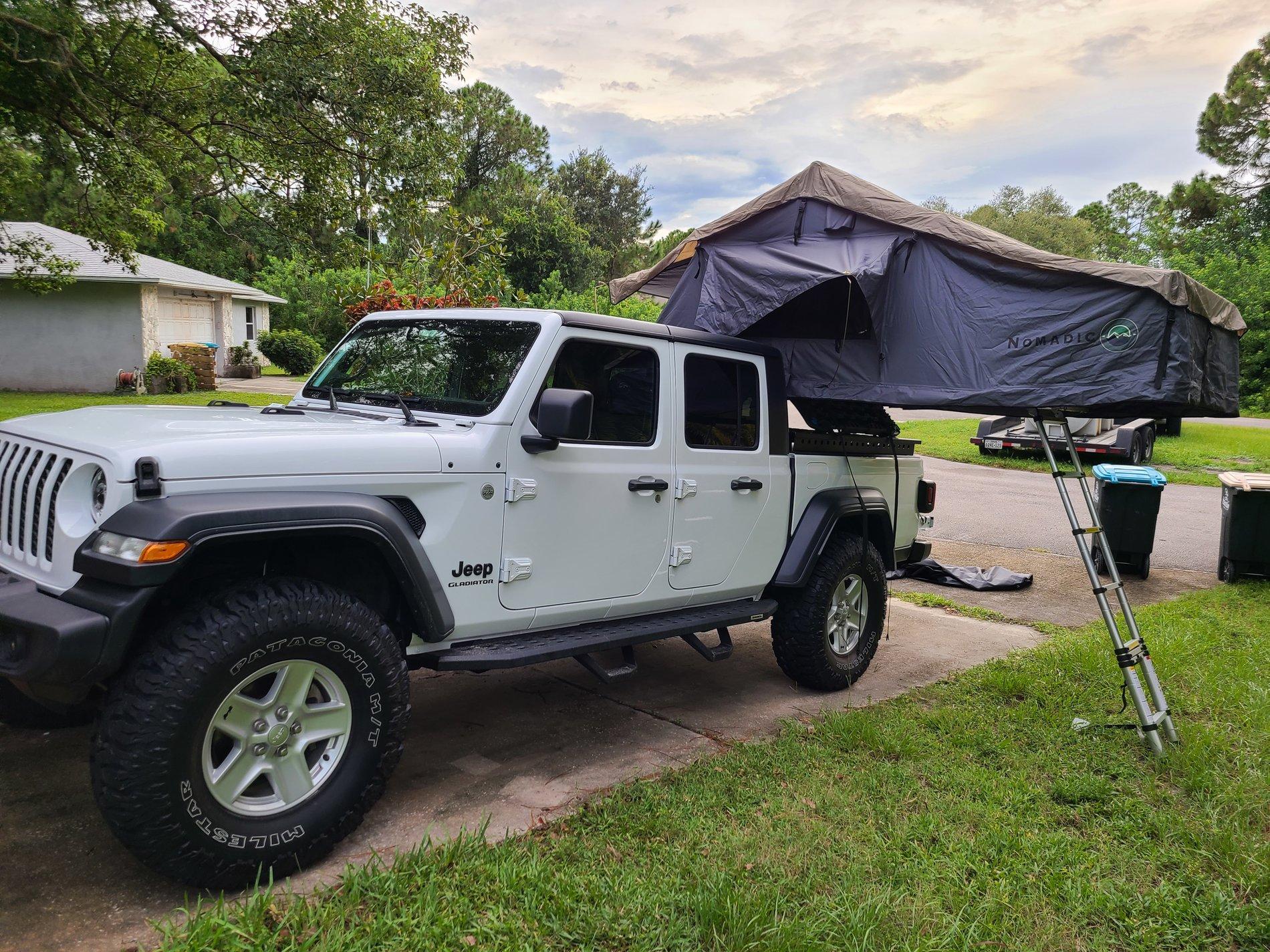

In sum, I have:
Jeep Gladiator JT Gladiator Upper Decker Hinged Cargo Basket Now Available! Jeep Tent Opened
Looks great! Does ur upper decker seal well front and back. Seems they made mine a lil short. Tho I prefer this topper over any others. Enjoy ur trips!

Mine was quite a bit short as well. After installing the rear weather strip, there was still about 1/4" gap between it and the tail gate. I do not have the spray in bed liner and I think that is the issue. From looking at some JTs with bed liners, the coatings appear to be about 1/8" thick. If you add 1/8" to the front and rear of the bed, it would make up the 1/4" gap that I had. I ended up ordering 1" D shaped weather stripping and that did the trick to seal it up.
Photos in post #261 above

I may follow ur lead now with the thicker gasket. I have the bedliner, and i have the tiniest gap most the way. The forward seal i installed as per the video, but i think it should've gone about 1/8" - 1/4" back to make a good seal (towards the radius) maybe I can find another one of those and reapply. Thanks
Sorry, I actually ordered this 3/4" strip. It took about 8 days to get.
