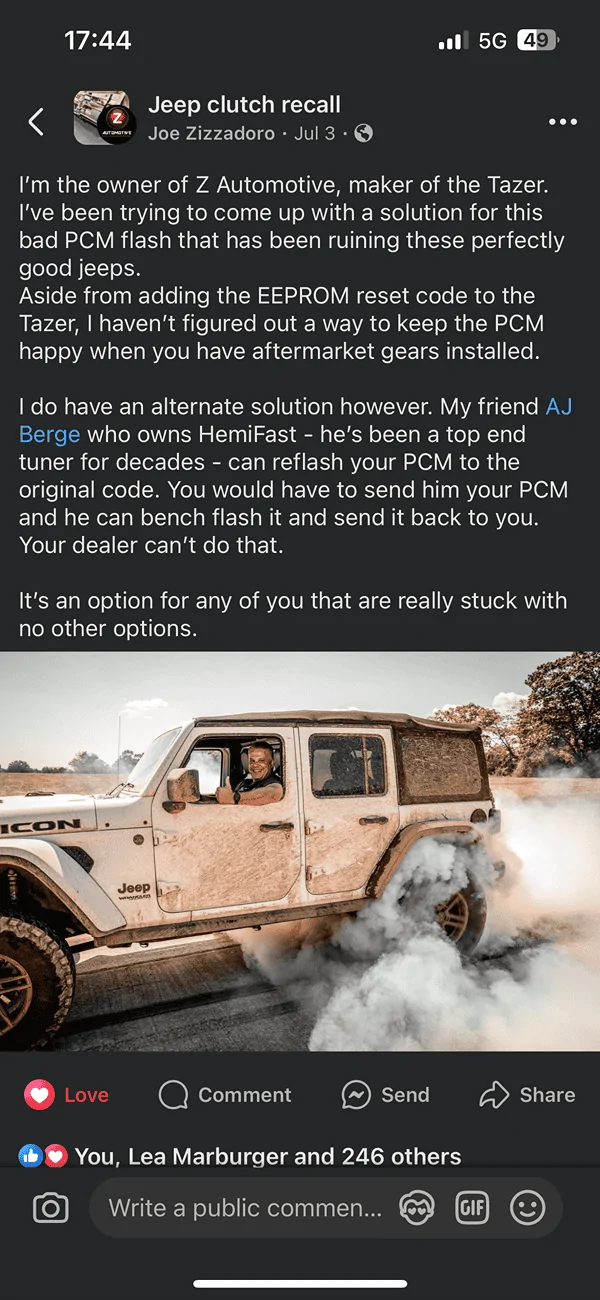

boils down to the computer not being happy. Doesn’t happen all the time but does happen…. At least for me.
Best option to fix that part is to send pcm out for pre recall software so it stops all that BS all together.
do you have a lead on pre-recall software to do this?
I’m bummed that aftermarket clutches which presumably fix Jeep’s initial failings are still subject to the half assed nanny fixes they attempted rather than make a good system in the first place.
See photo it’s Hemi-fast. I think I’ve seen 1 person say they sent out and got it back and worked great so far been a few weeks.
