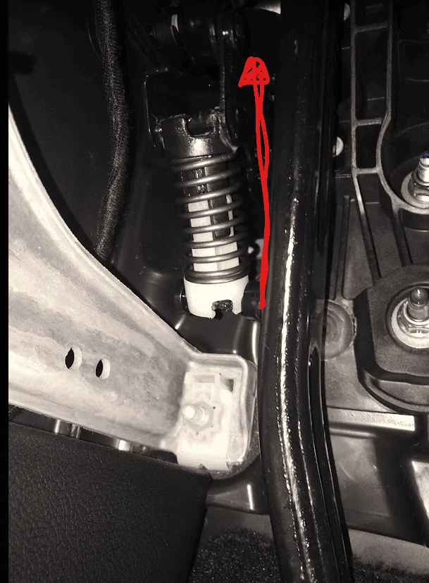

Been running the lighter spring for about a week now. I only had 2500 miles on my JT when I did the swap so my factory spring was still really fresh. So far I, prefer it over the factory spring. The most notable positive is at the very top and very bottom of the pedal stroke there is no longer the drastic "slapping" action that is more obvious in Dirk's video of the pedal assembly off the vehicle. This makes for a much more consistent pedal feel and I can detect the clutch engagement point a bit better. Only downside from my perspective is the spring is lighter and makes the overall feel of the clucth slightly lighter as well. But we all know the only solution for that problem. I like perfer my clutches feel like I'm pushing on a diving board. Overall very nice easy install and budget option to improve driveability.Clutch Assist Spring Testing
From a recent clutch installation on a Gladiator with 62K we were able to get more testing done and gain more data points to consider. First, we focused a lot on the pedal assembly and testing the assist spring.
Installation is super easy. If you don’t like it, take a couple minutes, and change it back. You may want to change it a couple times just to be sure you are not imagining anything in your analysis.
I am not saying that this will solve the OE clutch issues of the JL/JT, but maybe this will improve the driving experience with the stock clutch.
