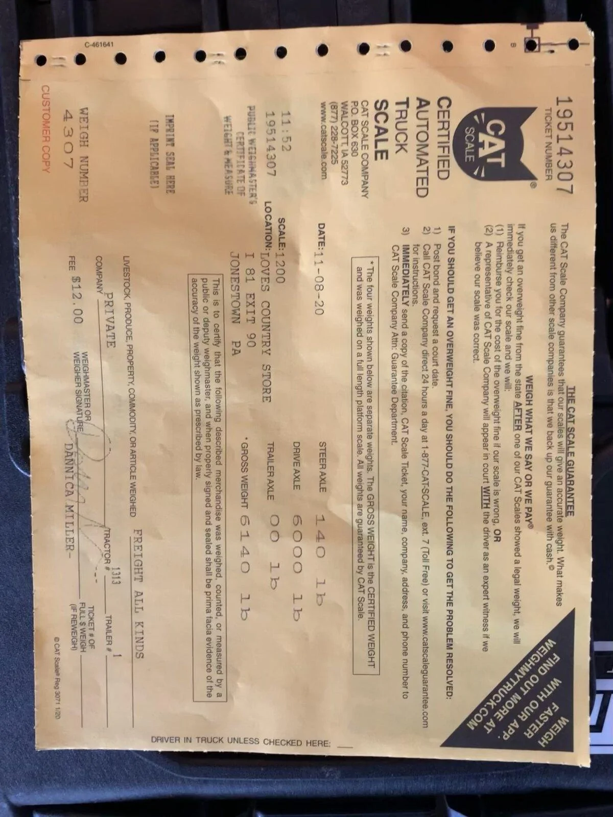

This is A Gas JTR with Steel Bumpers, Winch, Steel Sliders, an aluminum bed rack (front runner), onboard air, dual battery, camping gear for 1 night, typical recovery gear, and 1 passenger, 5 120lb wheel/tires.
Jeep Gladiator JTR Diesel Payload 65424AC9-DB24-4BF3-B2F2-74C88C7F559B
After that weighing experience I made a spreadsheet and swapped to all aluminum everything (except sliders) and started removing anything I could to save weight. Rubi bars, brackets, etc. Also swapping wheels around soon.
I highly recommend a spreadsheet, you can get weights for almost every part out there and do your own math.
