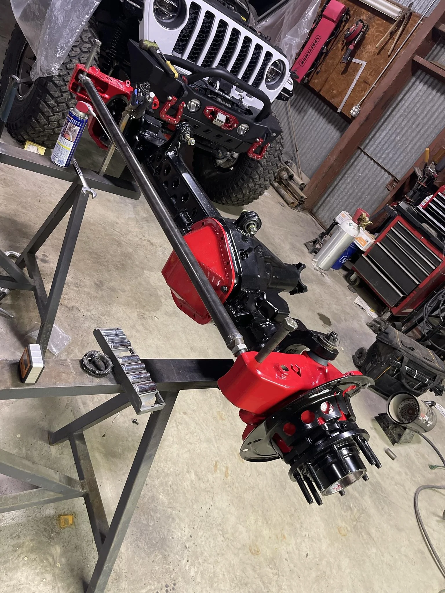

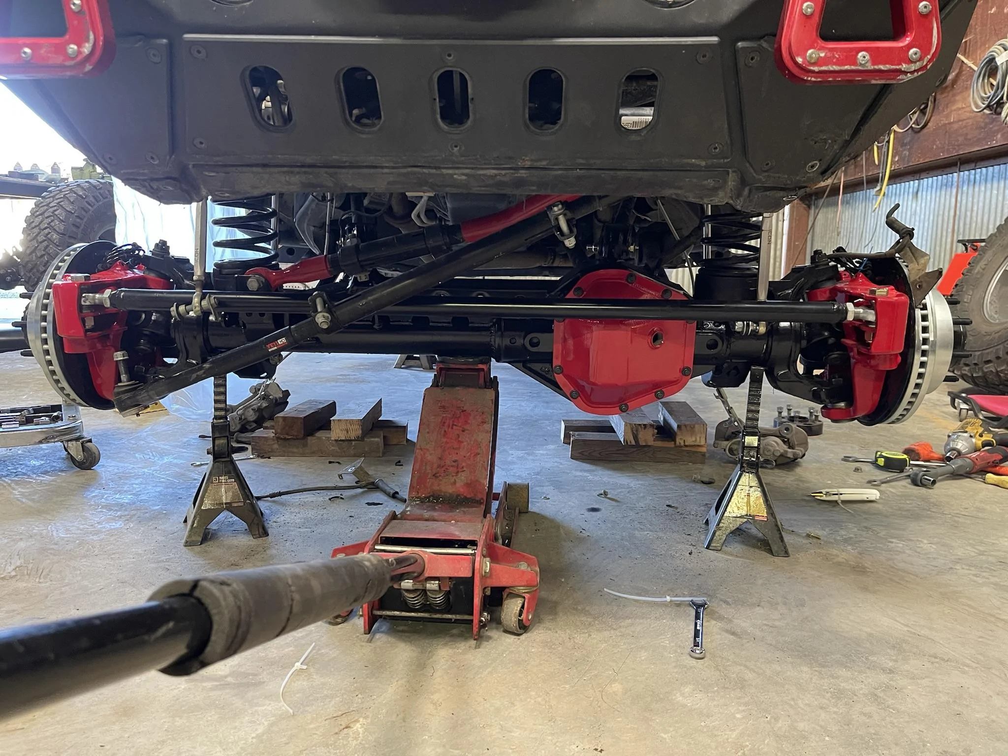

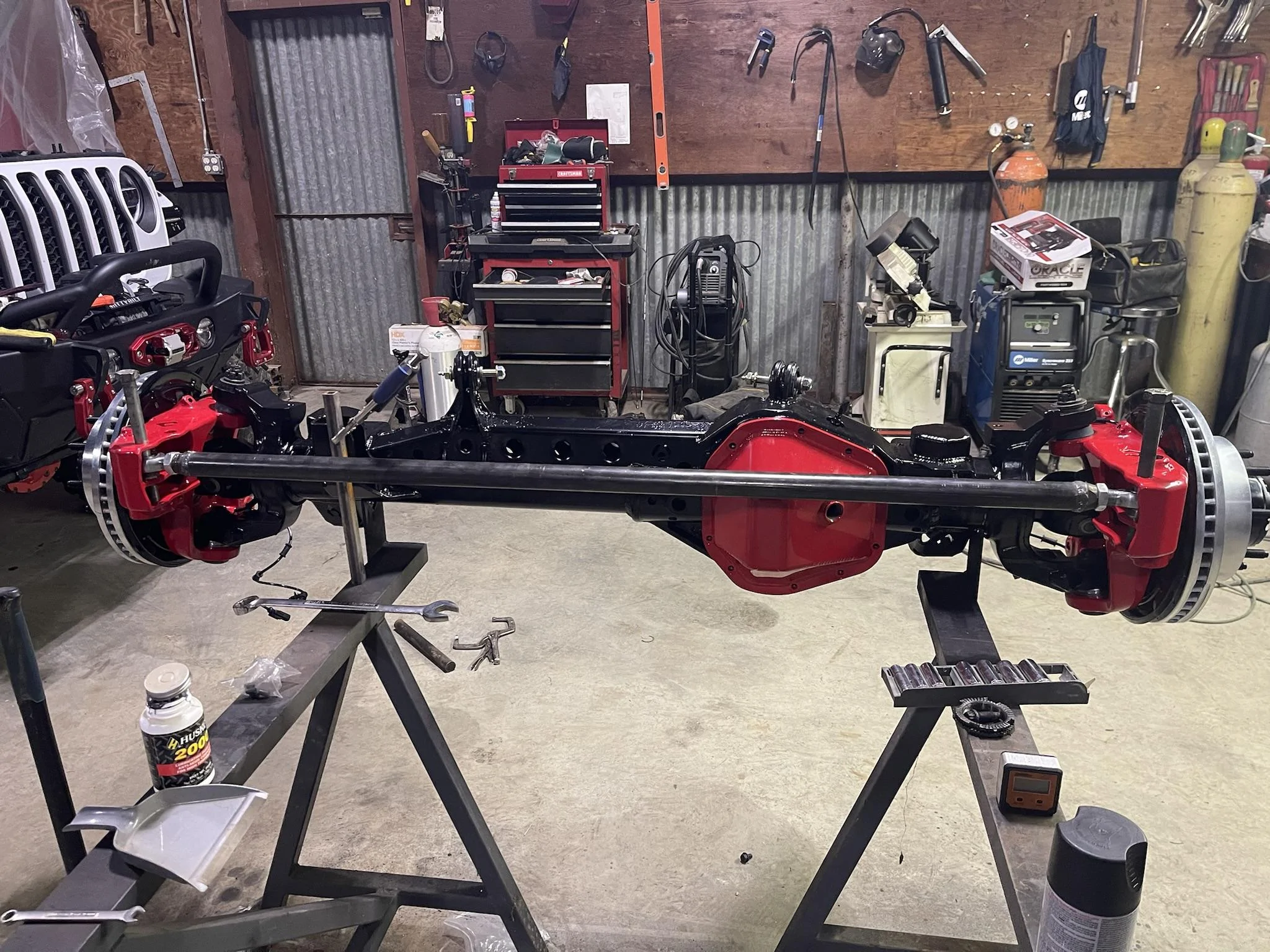

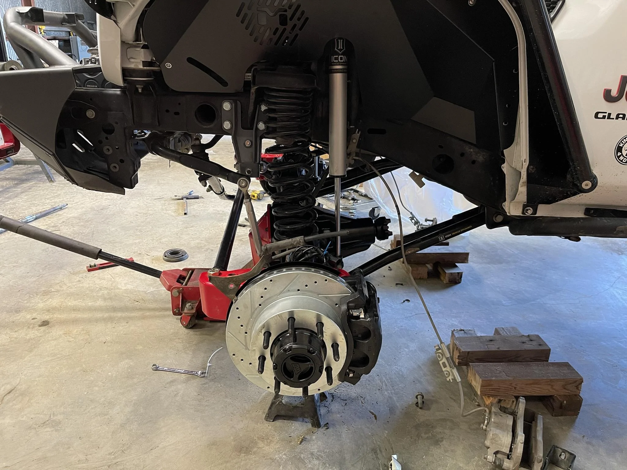

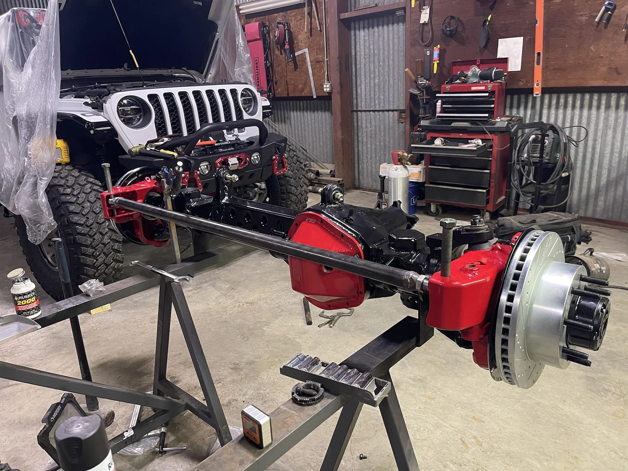

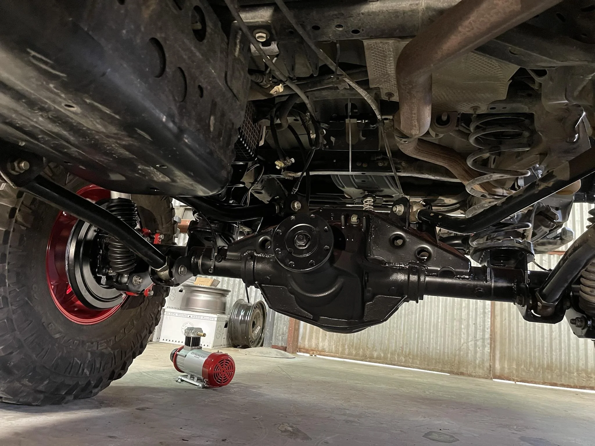

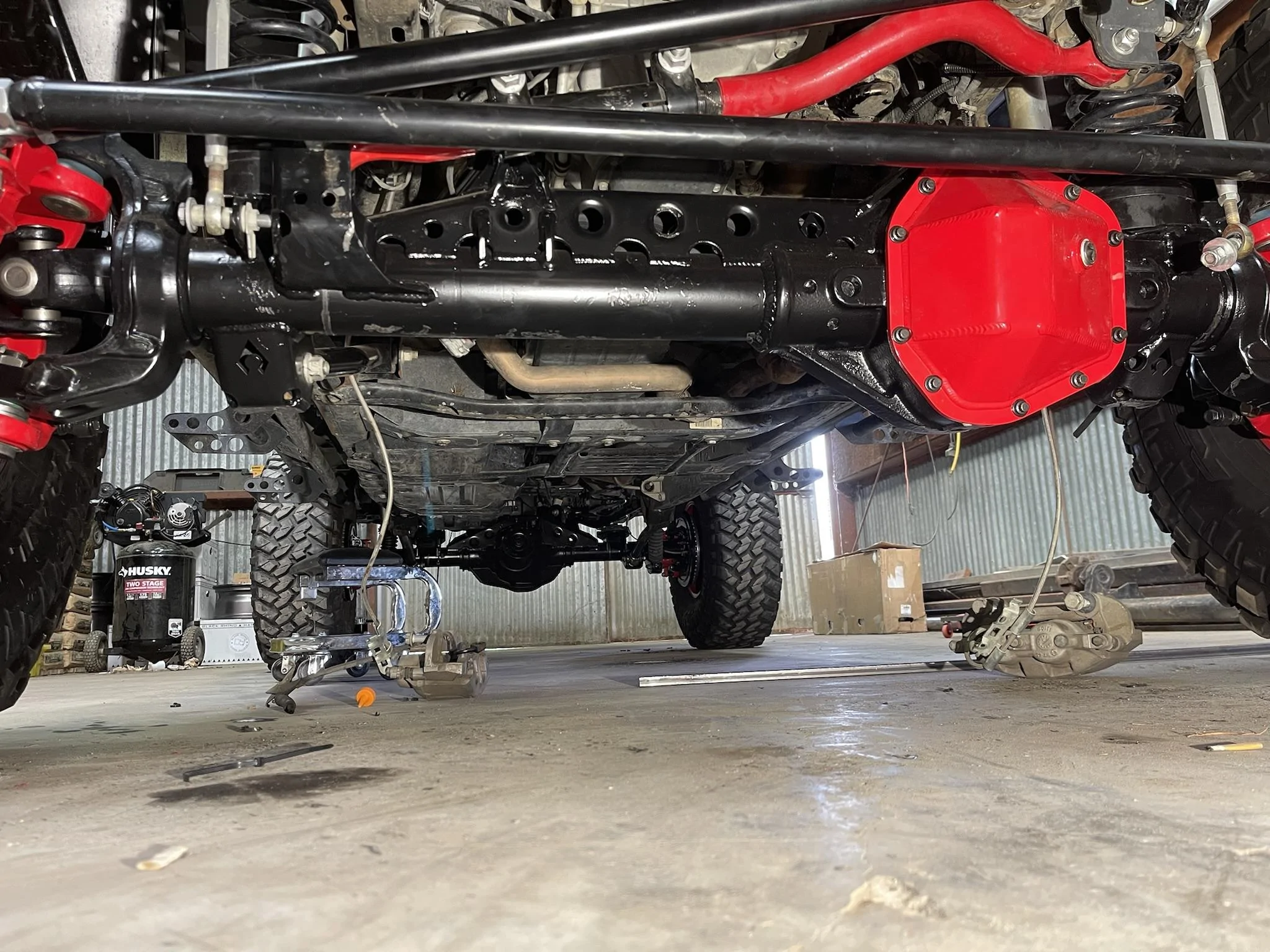

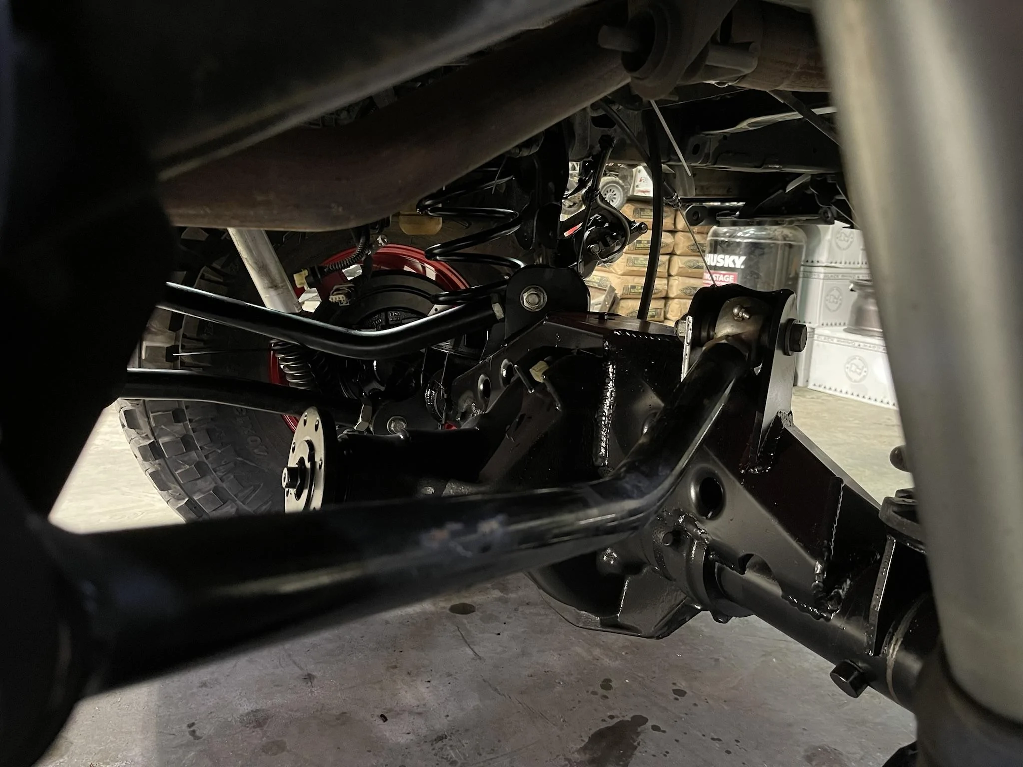

Hello Everyone. I am finally in the install phase of my axles. front one is on and rear will be assembled and installed by this weekend. here a couple progress photos to keep everyone updated.

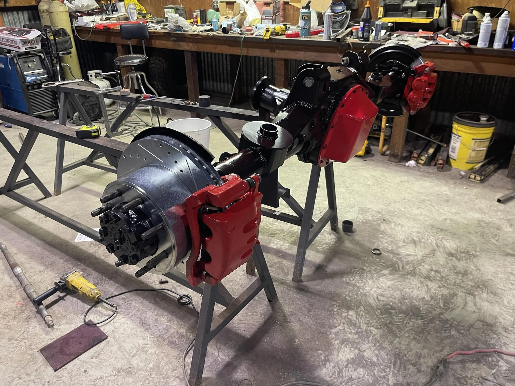

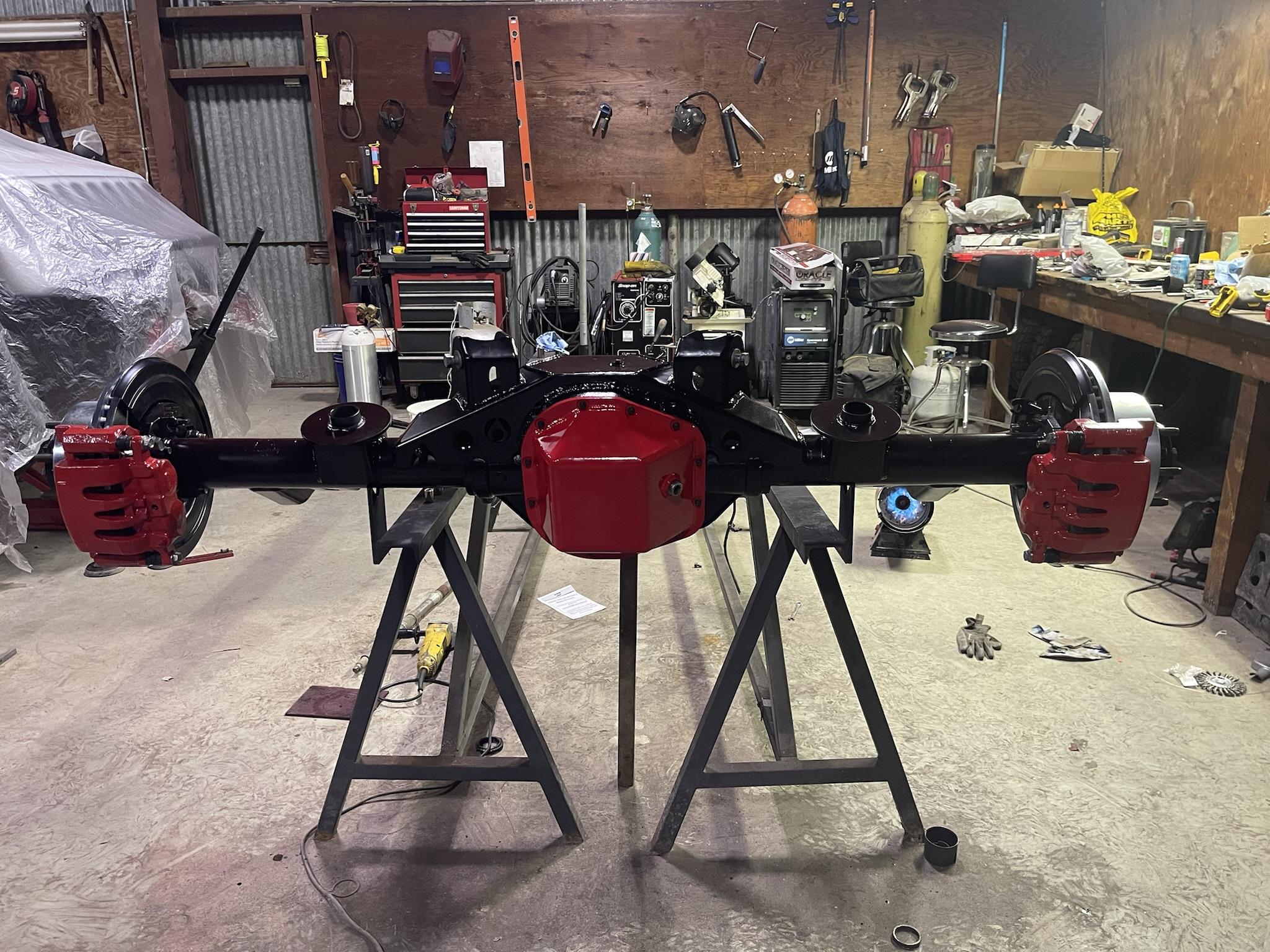

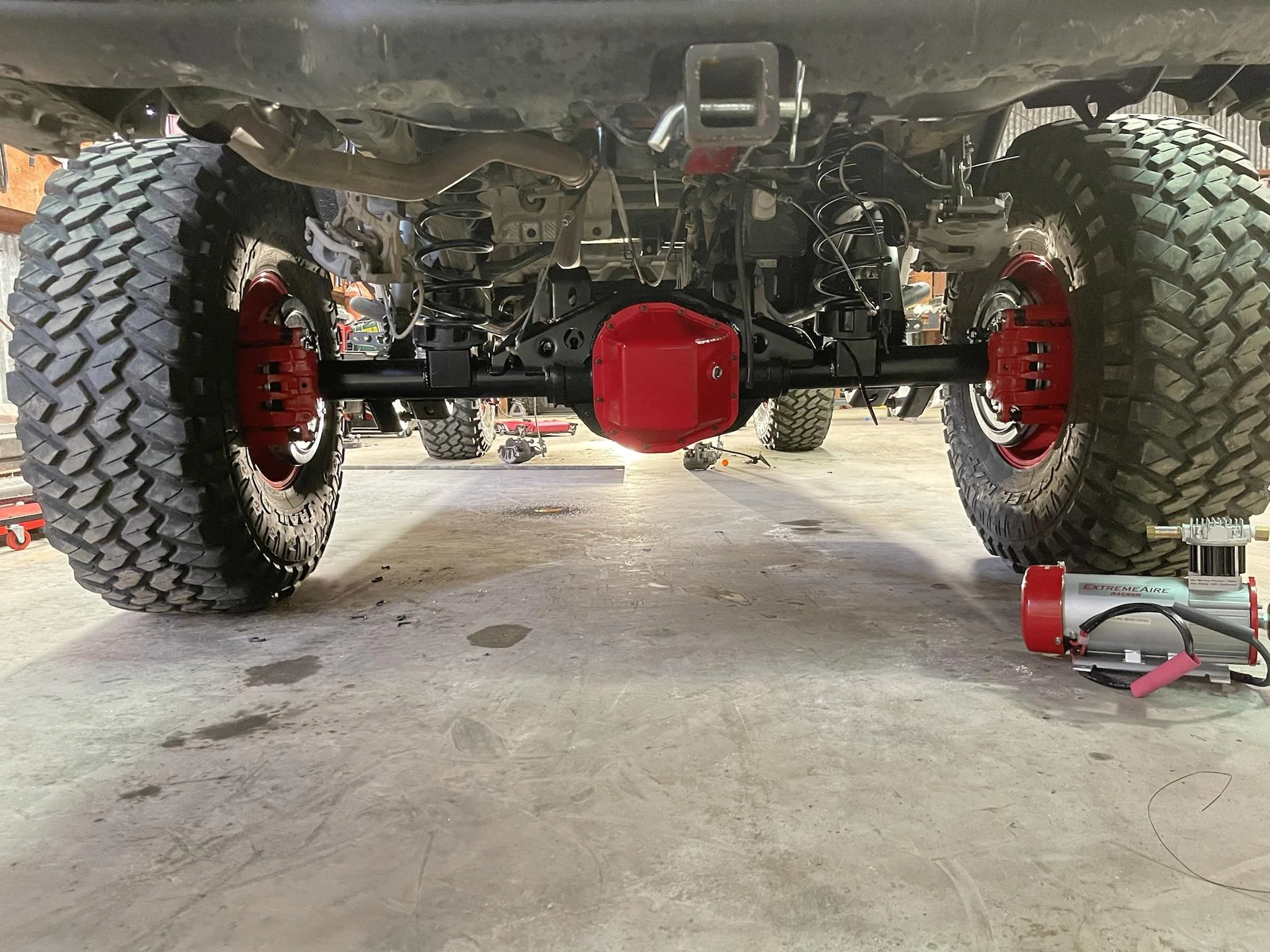

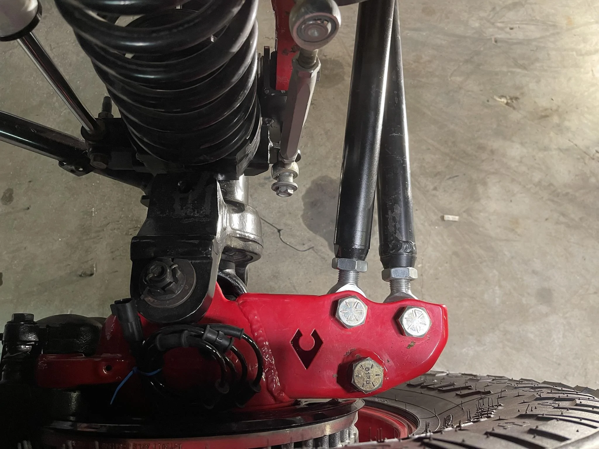

Just Finished assembling the rear axle last night. I noticed this morning when posting this that I installed the Rotors on the opposite sides. Ill get them swapped before installing the axle tonight.

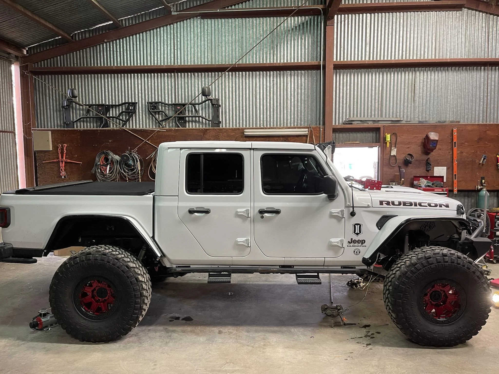

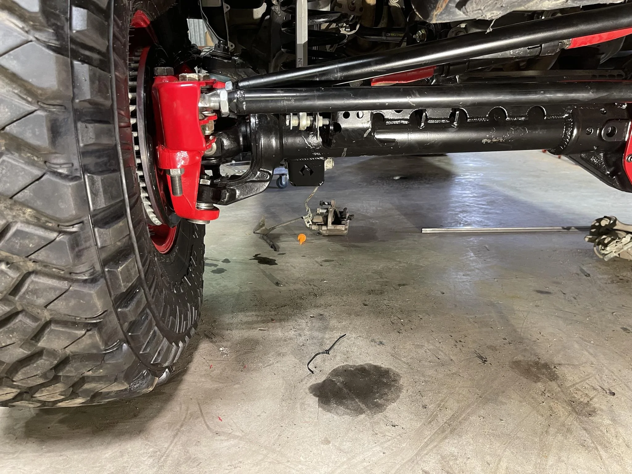

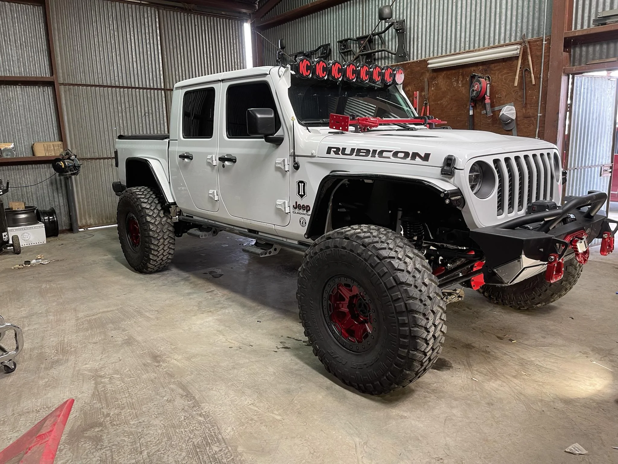

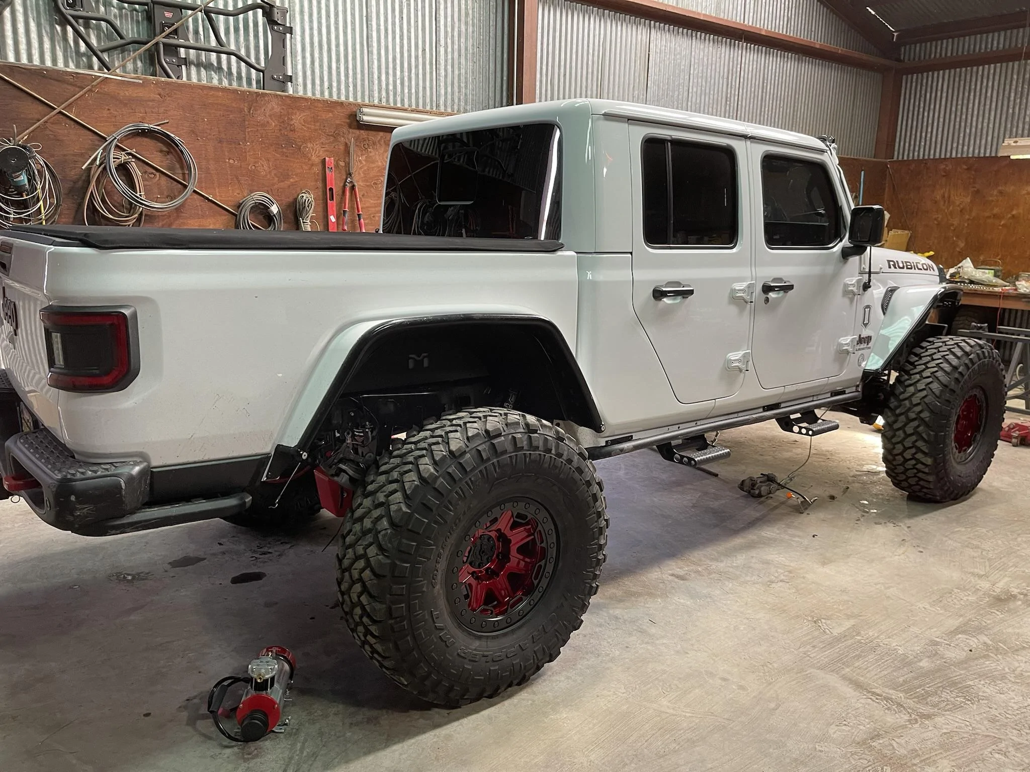

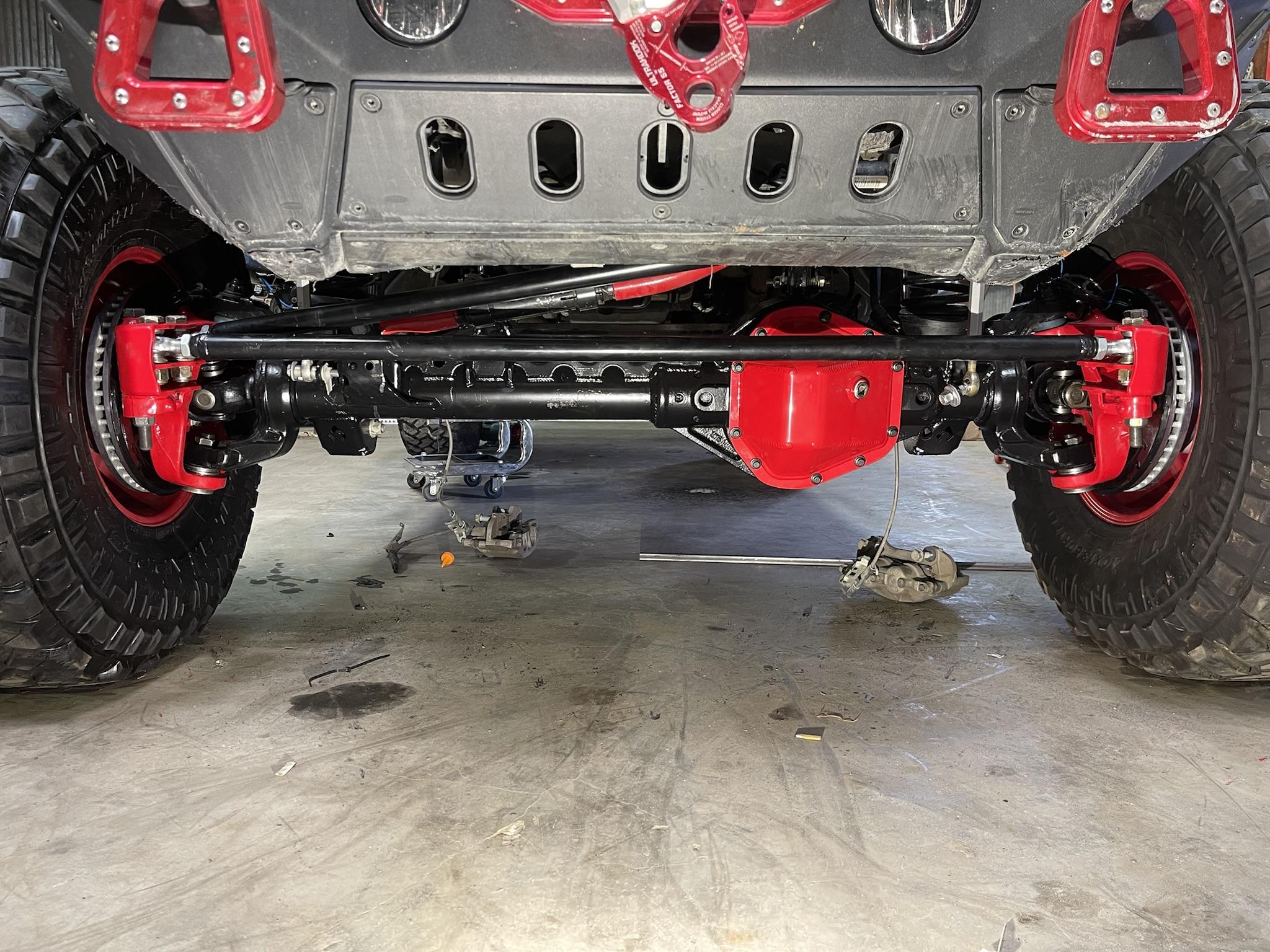

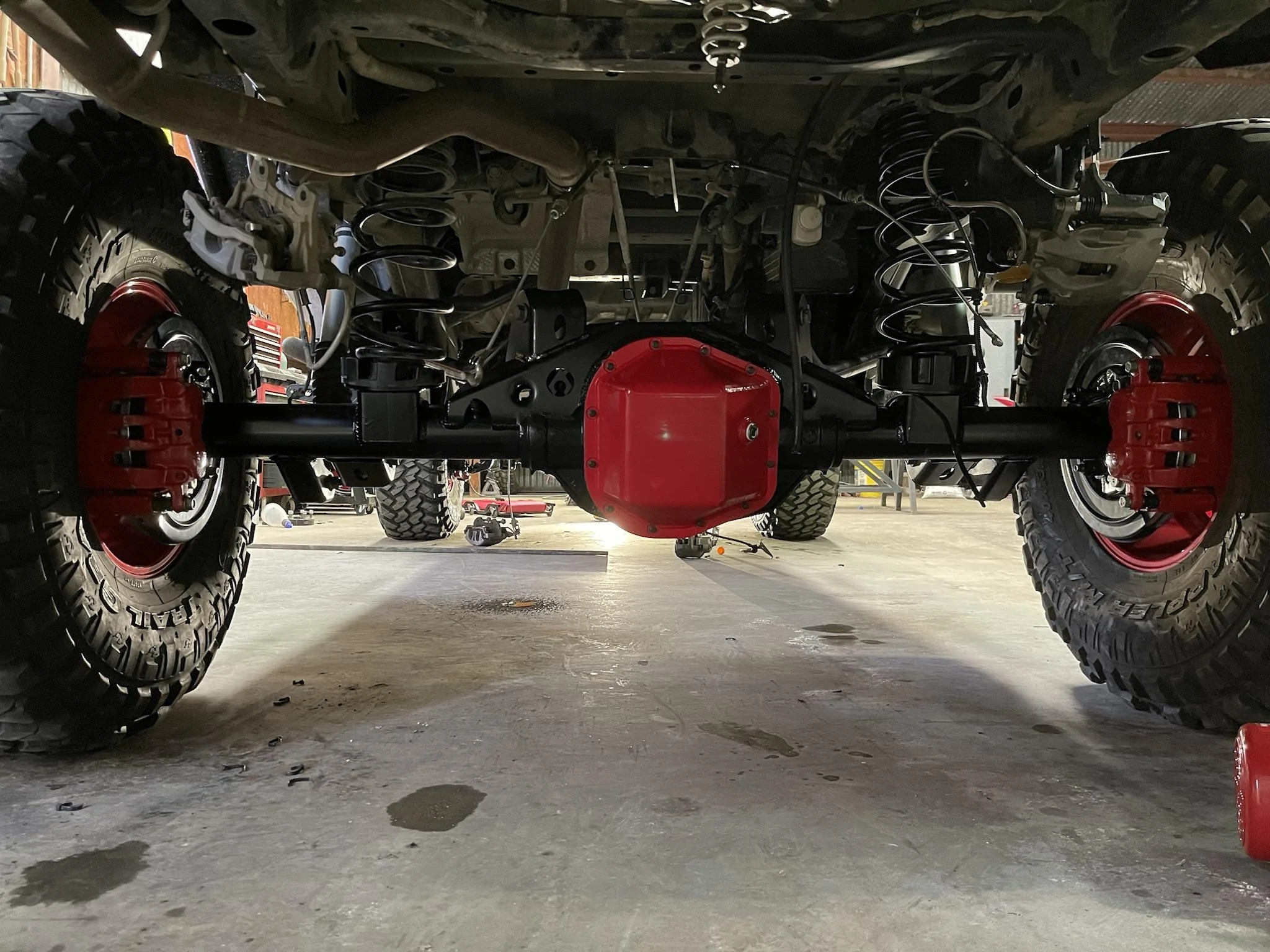

Hello All. Finally got these all assembled and installed. Mounted my Existing tires on new wheels this weekend too. Waiting on my new Drivelines from Adams Driveshaft. I've been looking around locally to see if someone can custom build me some brake lines to go from jeep to ford.

Excuse my disaster of a shop. ?
No need, when I moved and sold my house I gave up garage and 12Ă—24 shop for none.?
Looks good.
