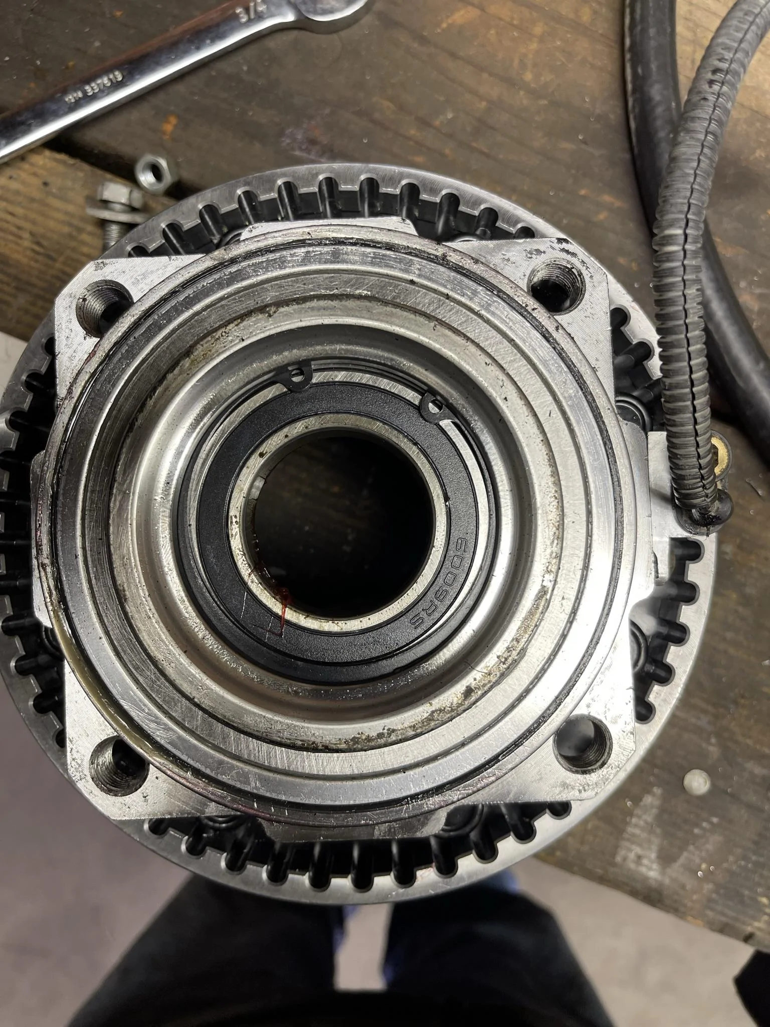

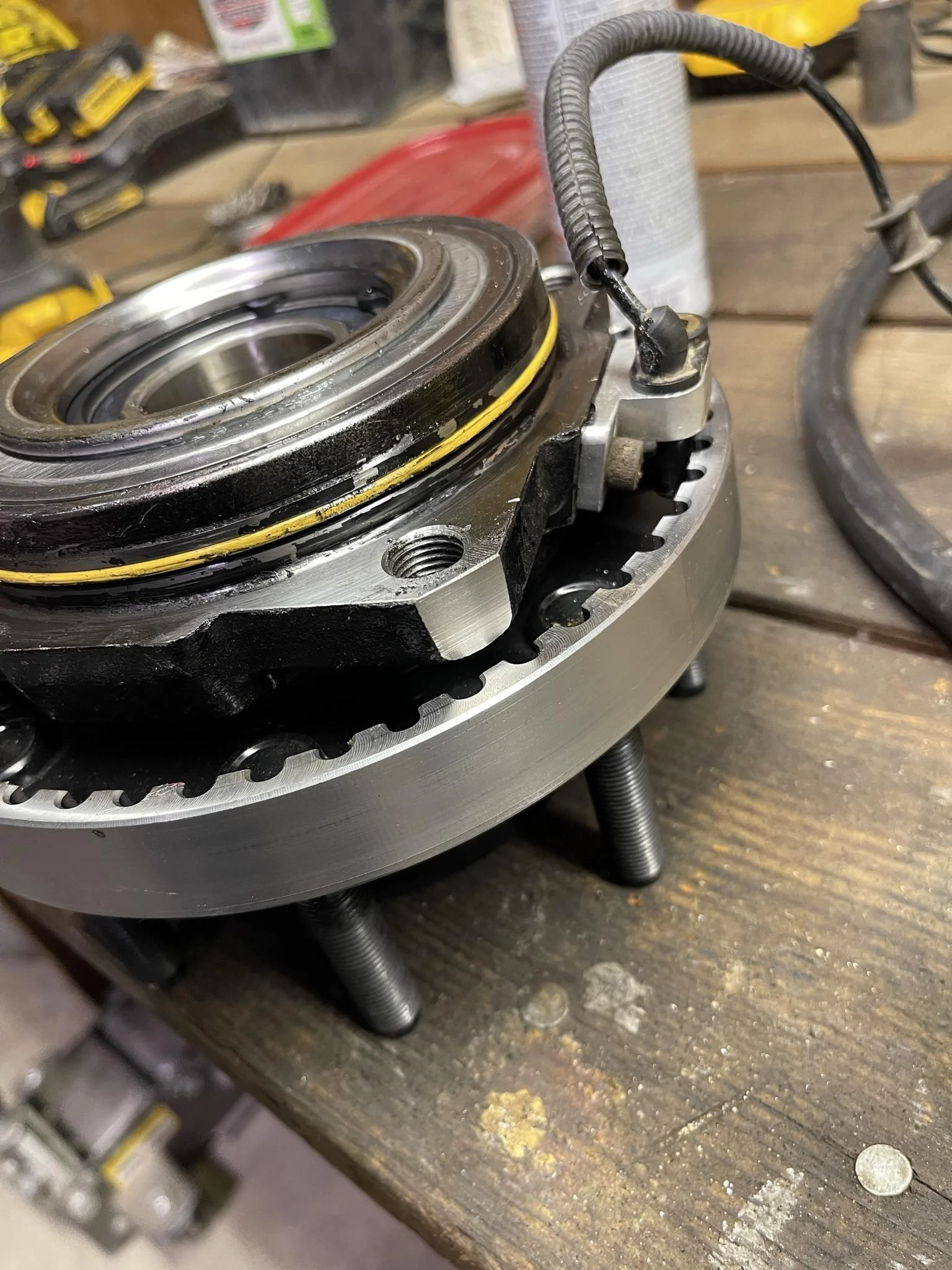

Ok so here is what the new front exterior 52 tooth tone rings look like installed with Factory Jeep ABS speed sensor installed. I can't see this not working. I have both front rings installed on the front. I will be installed the new 52 tooth rings on the rear hubs tonight. Keep your fingers crossed for me. Oh, I almost forgot. depending on what Unit bearing you have it may be necessary to trip the corners of the mounting flange in order to slide the ring over. Im sure a grinder would have worked just fine but I have a large engine lathe handy at home so I simply chucked them up and shaved the corners off for clearance.

Nice work with the lathe! Looks sweet.
