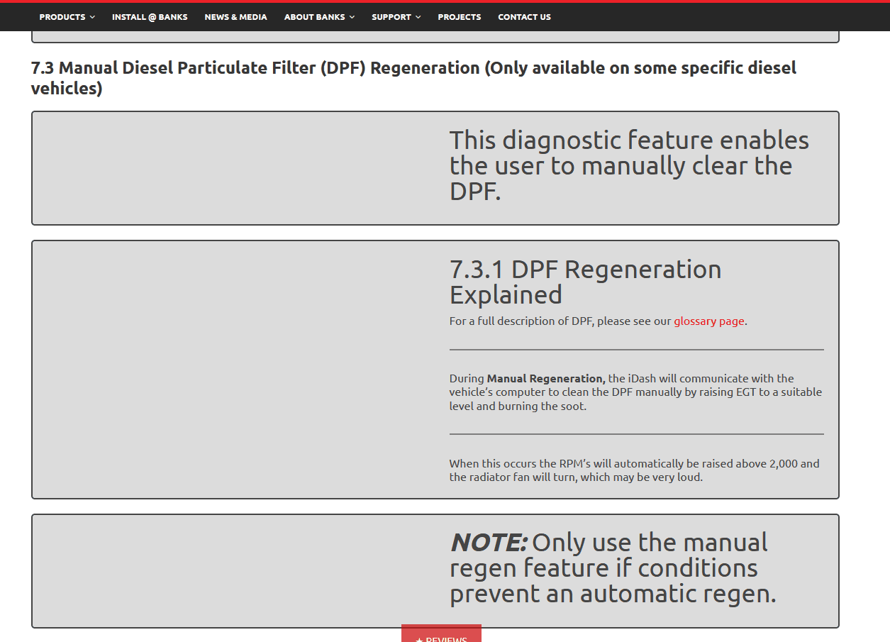

Thinking hard about getting one of those. I like that you can force a regen with it and not have to go to the dealer. (if I read that right)
Deleted member 47279
I never heard that. It tell you the soot level and you can drive further to push it down. But never a manual regen option.

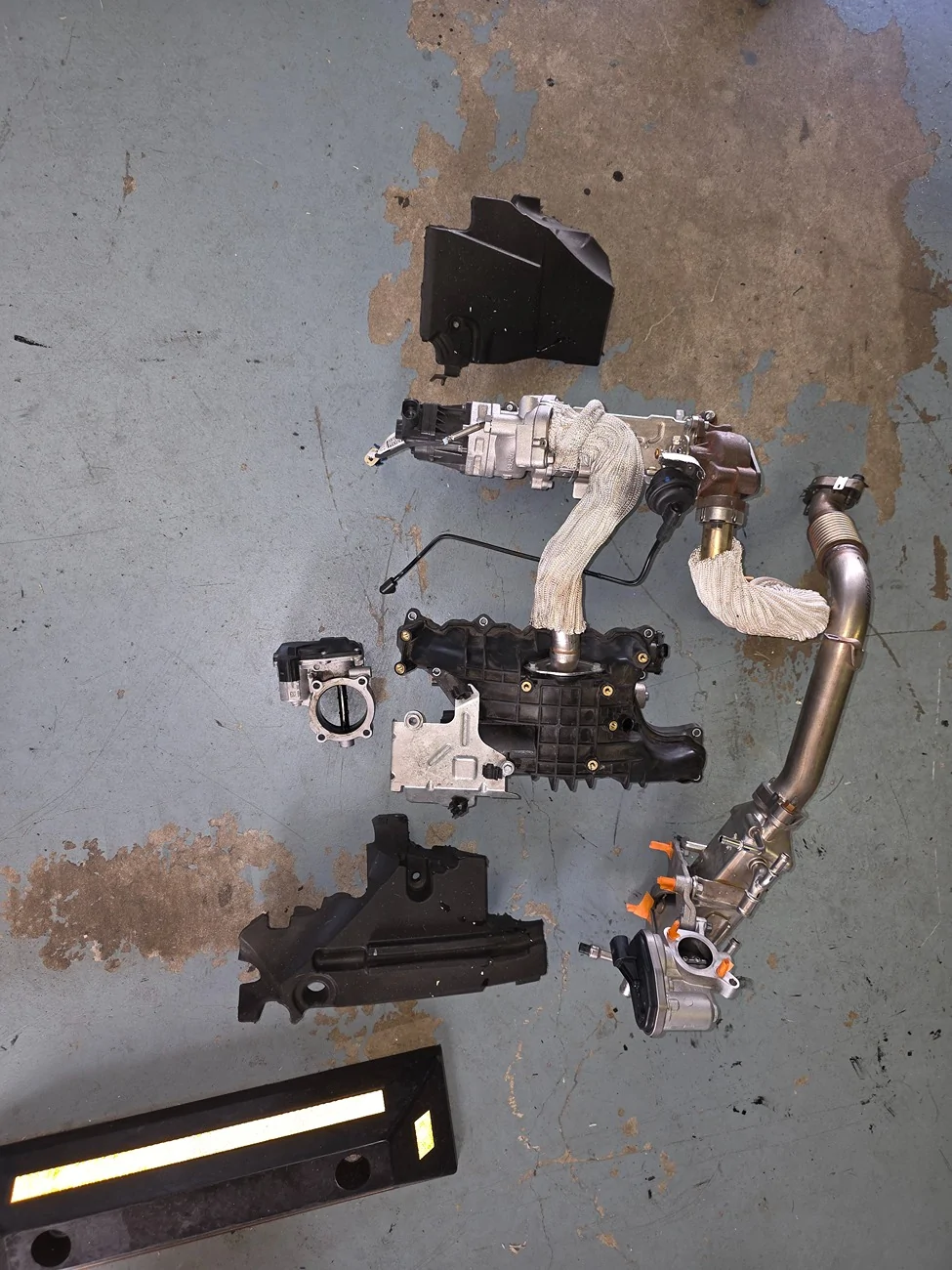

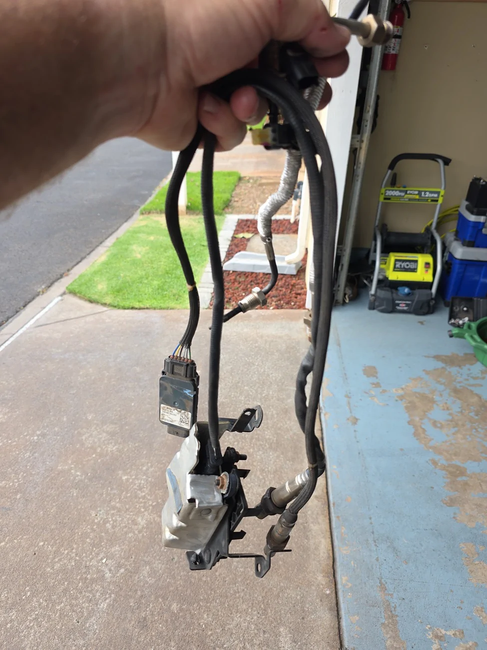

He kinda can. It does not say in the manual or by Jeep that the Gladiator should not be modified to this degree... heck, they should expect their buyers to do exactly this and account for it in their engineering. If they make it much harder than it already is, they will lose a large customer base.
Even the mall crawler customers hate the diesel as they keep running into the regen issue much more than the people who actually use and run and abuse their trucks.
In Germany, we have had several people return their Gladiators because of regen dpf nonsense and a few because the ad blue system kept making problems and another few because filling up the tank on the diesel kept giving issues. All either explained away by the dealership or going in for weeks, coming out and in a short time the same problem followed by extended stays at the dealer...

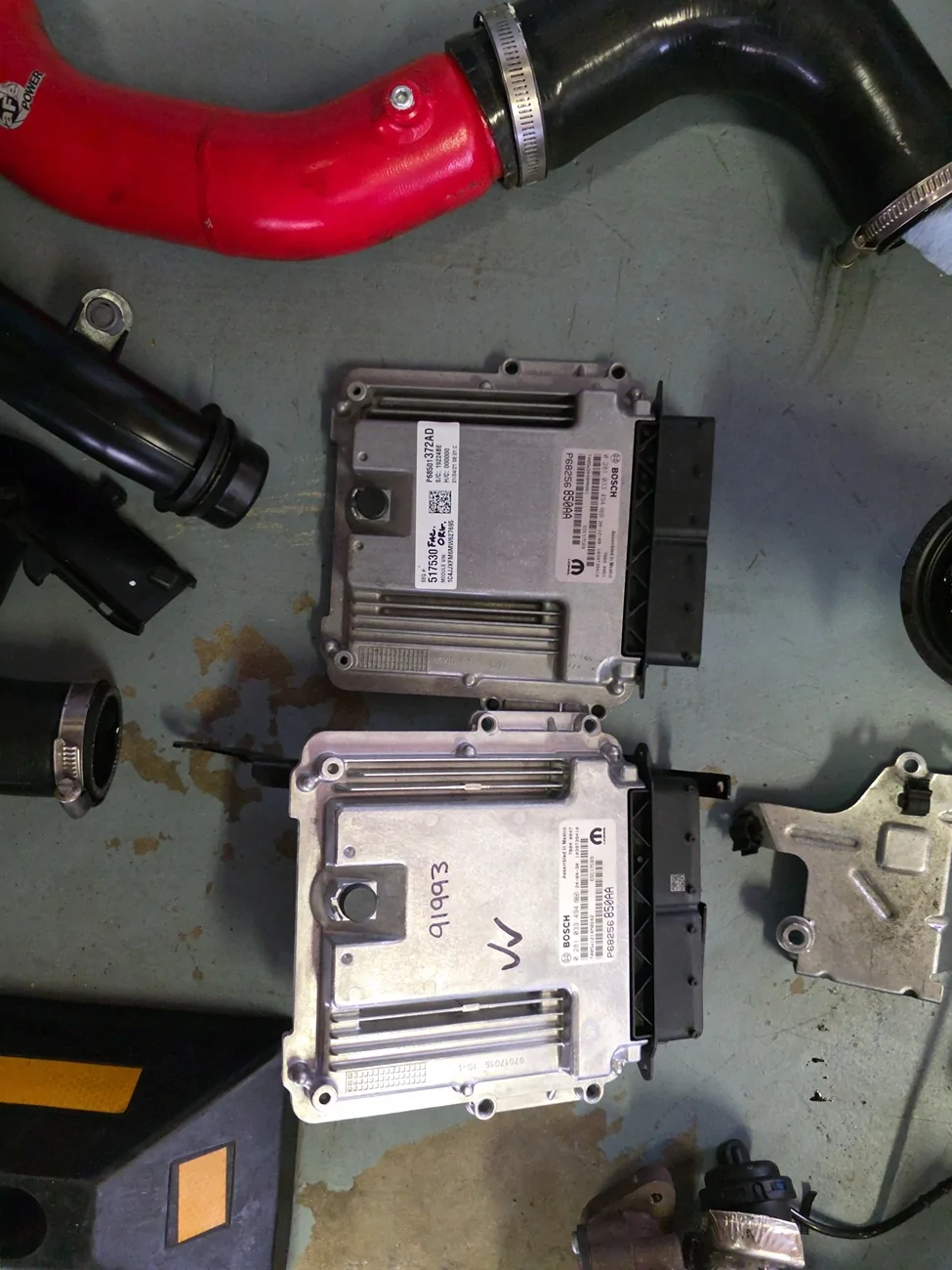

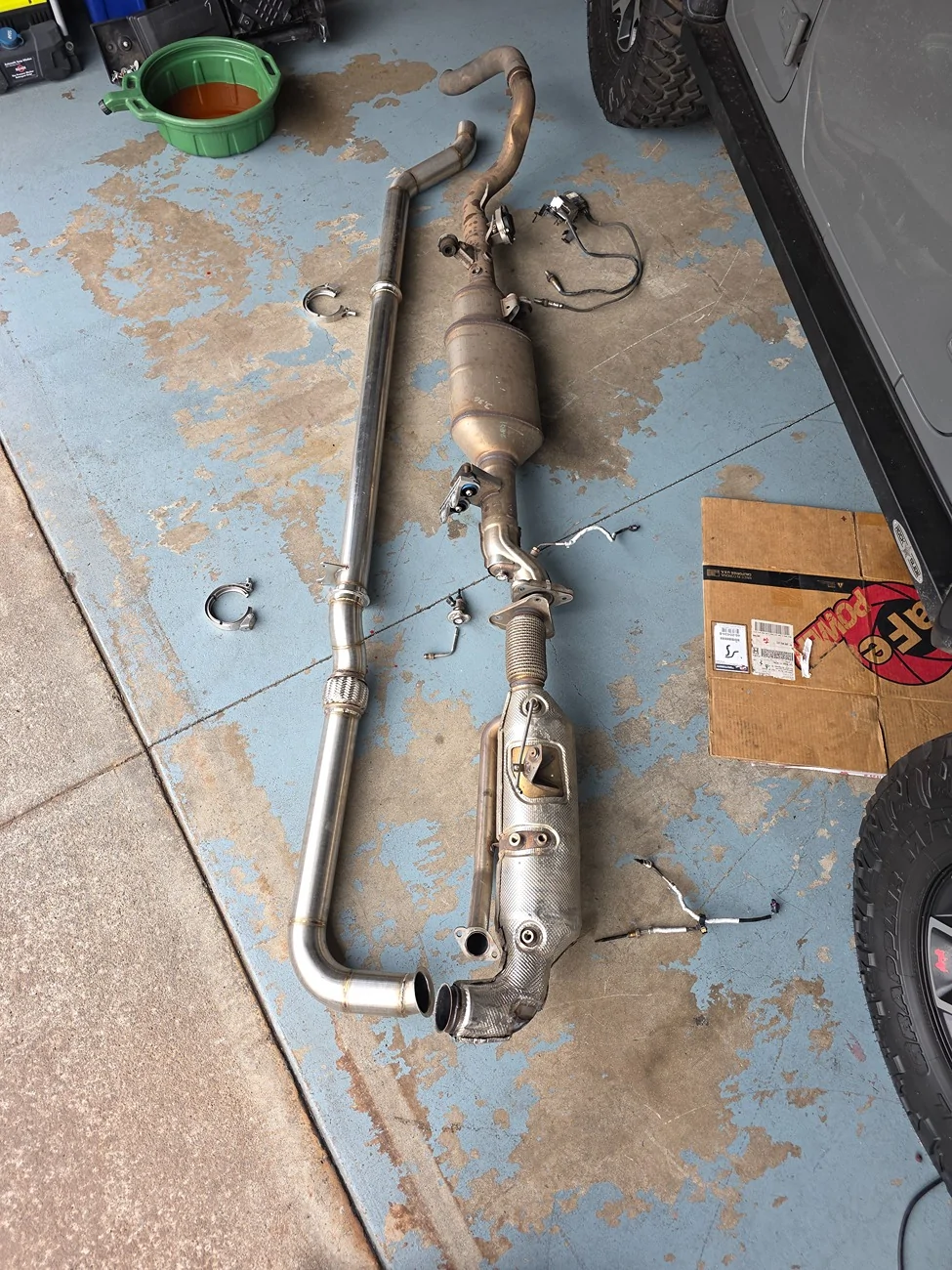

Here's the fix. Delete it completely. I know some folks have to consider state inspections etc. I have completely deleted my Wrangler and it has never ran so good.
