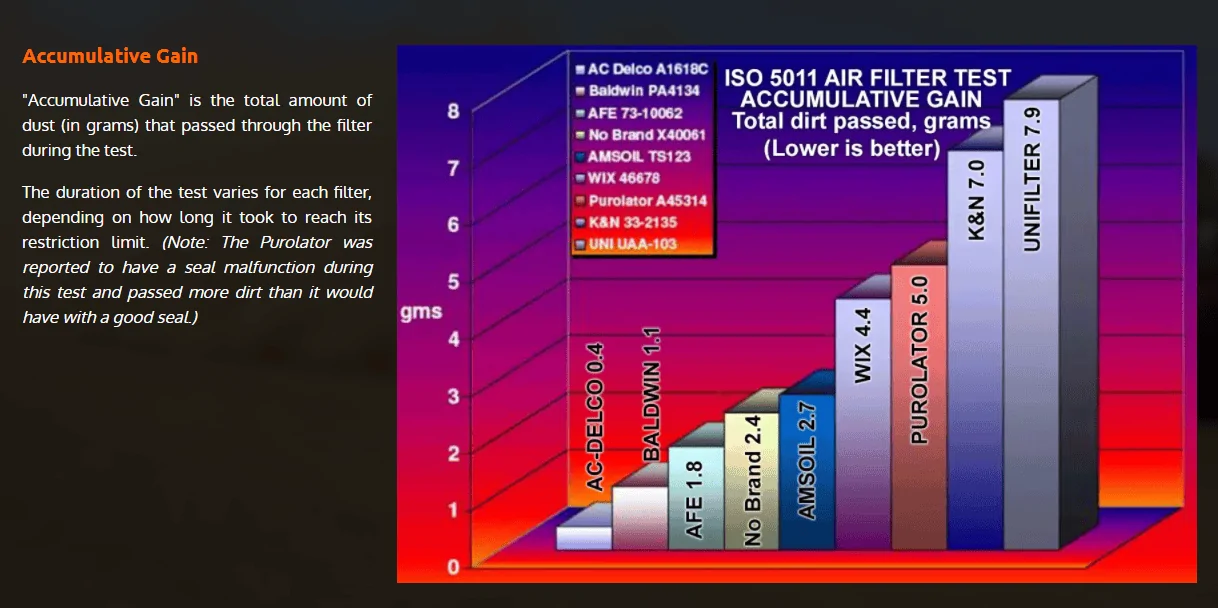

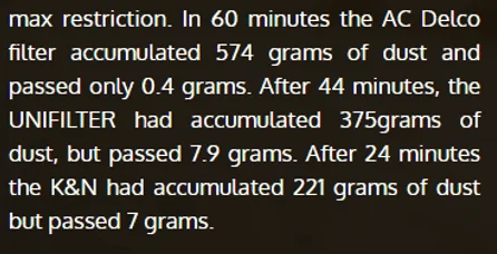

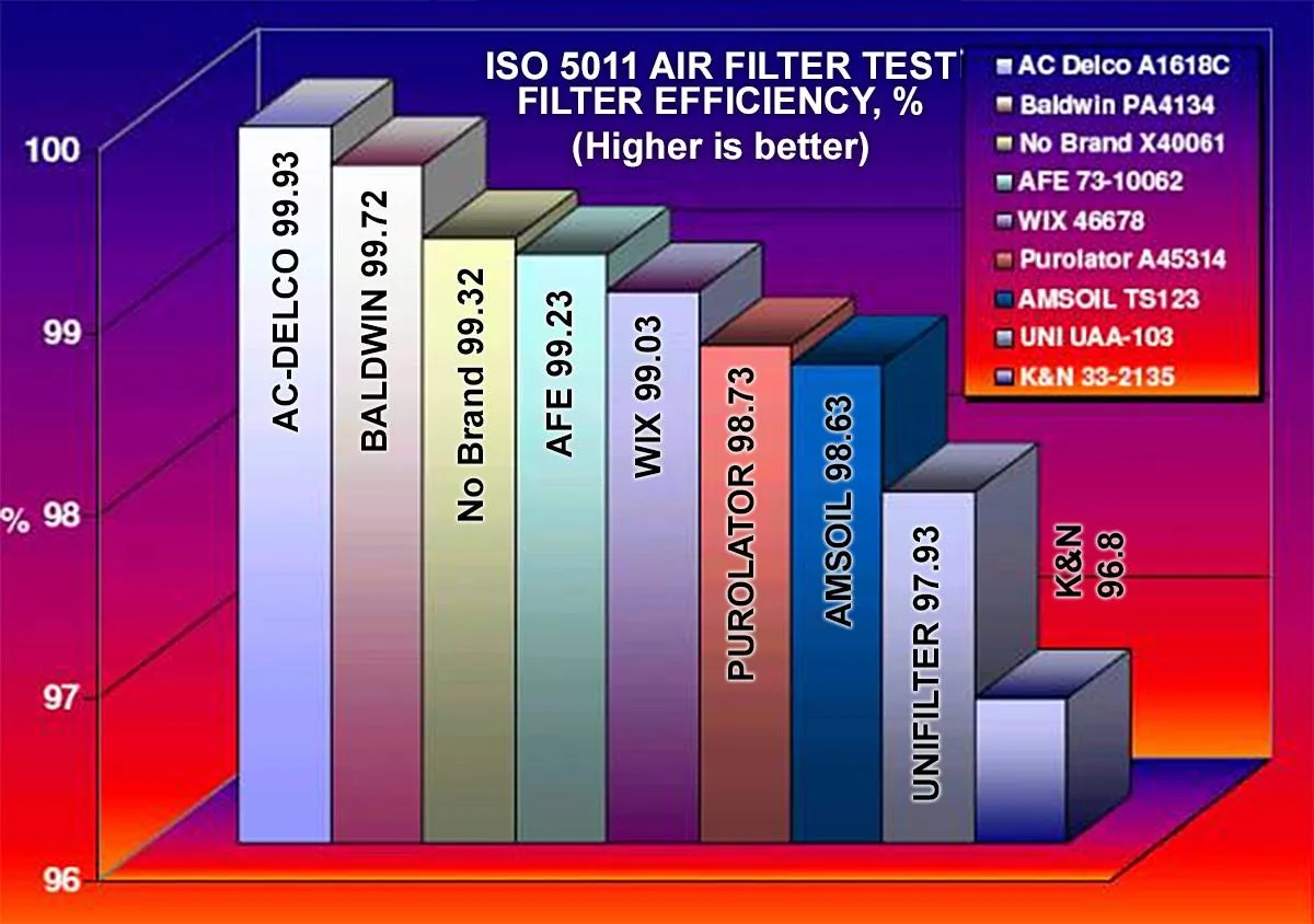

Sure, that's handy, being able to bang the dust out, rinse and go (but if you don't re-oil, it's even worse than the charts below!) Not following their cleaning process and oiling will make them pretty much useless.
Jeep Gladiator K&N vs MOPAR engine oil filter total-dirt-passed
Jeep Gladiator K&N vs MOPAR engine oil filter ISO5011-efficiency
Jeep Gladiator K&N vs MOPAR engine oil filter 1657558140776
In 24 minutes, K&N passed 7 grams of dust while the AC passed .4 grams in 60 minutes.
