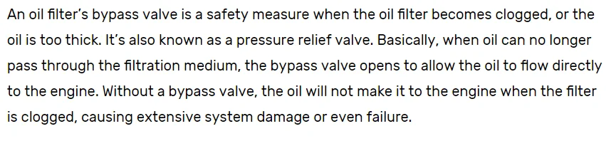

Note the top sentence here from a filter manufacturer -

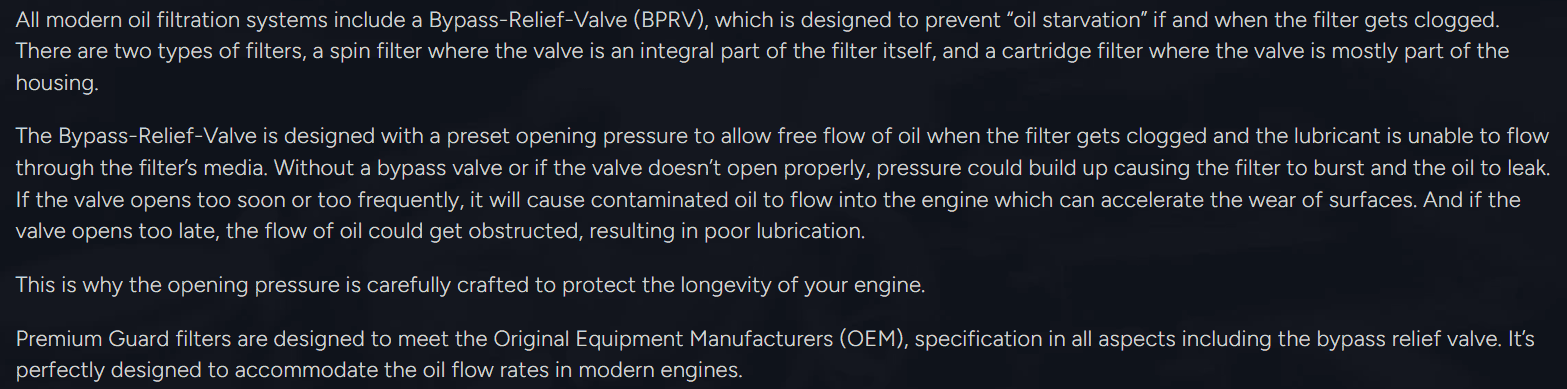

And from another - "when the filter gets clogged". Not when there's high PSI.
