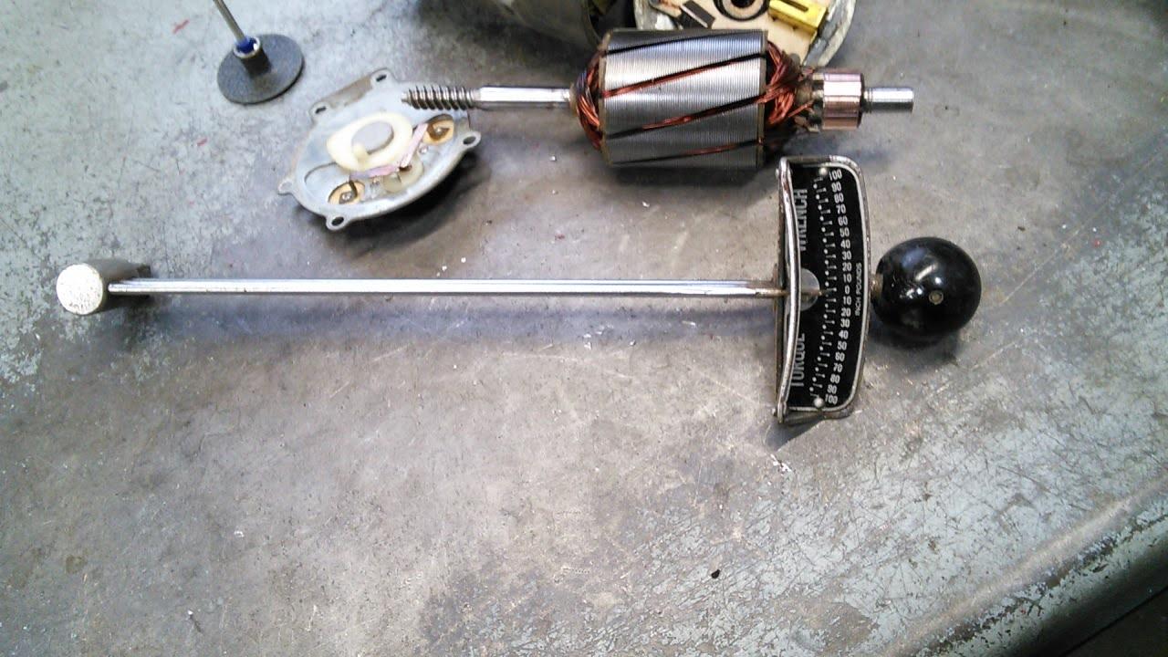

All this talk about torque wrenches and calibration......... the old-fashioned beam type needs no calibration ever if you simply take care of it and not run over it with your 4" lifted Jeep on 37 with a load of bricks in the back.
Seems to me that anytime those things get rounded it's because some gorilla before over-did it and the next guy had to use a 3/4" drive set and breaker bar to get it loose, or they aren't grabbing the correct wrench.
How can it be so complicated?
It's a Jeep.
Come change the oil in my 73 if you love tight spots and not even being able to see under the vehicle. Don't use a metal filter wrench, it sits 1/2" away from the alternator output cable and that's hot all the time.
I've got a drawer full of torque wrenches and a pegboard with 3 beam types and a special click-type for transmission use and even though I've done thousands of bolts and nuts over the decades and am generally extremely close to correct on many - I still check myself now and then, silly and a bit, well.......... not to.
Needs no calibration ->

I have always wondered if temperature can cause different readings. If the torque wrench is 20f or at 85f, would the torque reading be different. All mine torque wrenches are kept at 70f.
Unless you are torqueing something on Venus, temp variations are nominal on most torque wrenches. Elastic modulus of most tool steel varies roughly 1% per 90F degrees.

Good to know. I can stop thinking about it.
