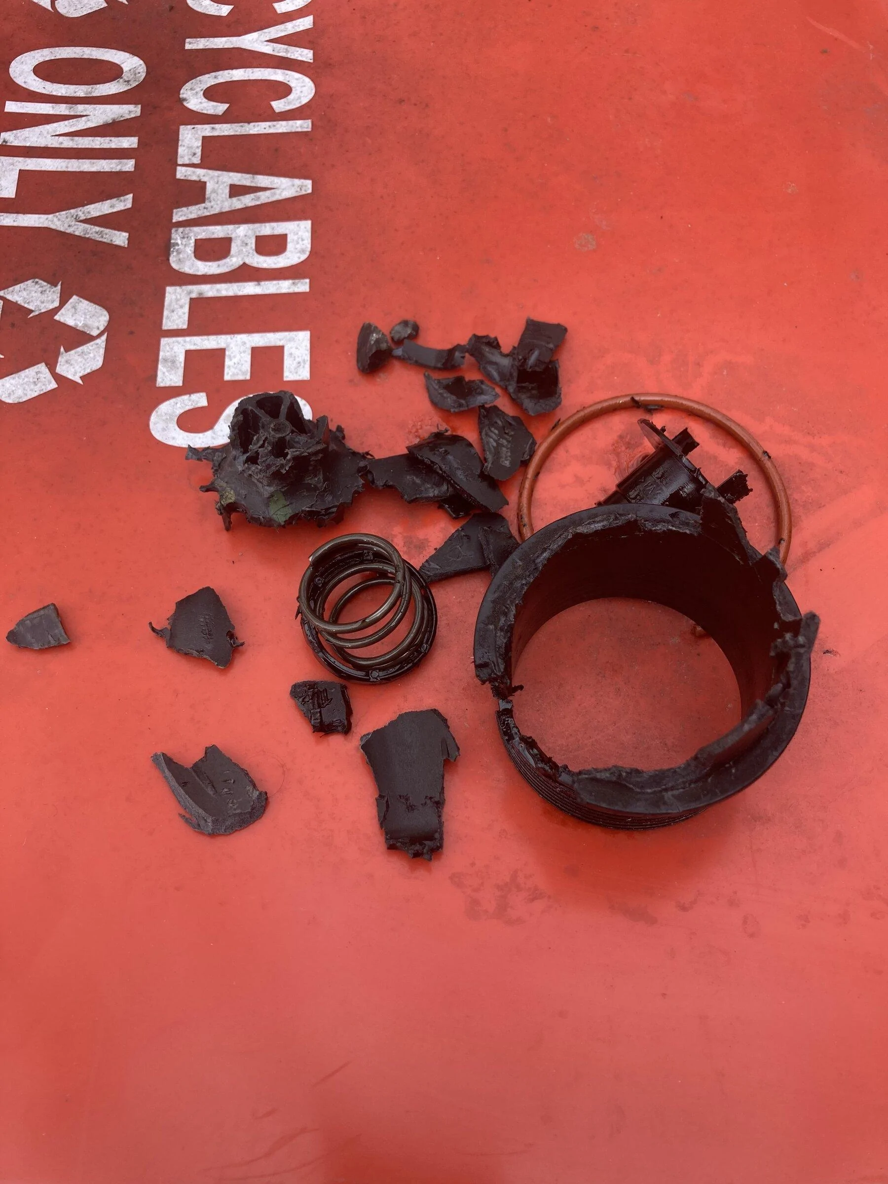

UPDATE!
Yea went the drill and chisel out method. It wasnt so bad...you drill a circle to get the top off and filter out...then carefully chisel down to the gasket/ring...once there it unsticks and able to twist it out.

Wow, that’s something.

UPDATE!
Nasty. Glad you got it out. You were probably WAY more careful than a shop would have been.
