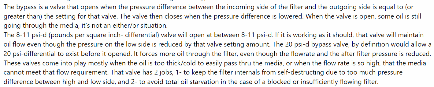

I think people are forgetting what a bypass valve is for and what it does. It will not open under normal conditions.
It opens when there's a pressure differential between the two sides of the filter material.
This prevents a clogged filter from preventing oil getting to the engine.
If the filter is dirty or the oil too thick, it opens, allowing oil to bypass the filter media to at least protect the engine.
So in other words - that bypass won't open unless there's a need for it to open. On a new clean filter and the right viscosity oil, it may never open.
It's a FILTER bypass.
It has zip to do with oil pressure.

That's NOT oil pump pressure, that's differential between the two sides of the media.
It's a filter BYPASS - literally bypasses the filter media in event of a plugged or restricted filter.
Your filter's bypass had better not be opening when the engine is running, otherwise oil is not being filtered.
You can look this up.
If your filter's bypass opens, your filter is dirty or the oil thick.
The pressure at which the filter's BYPASS opens is the pressure difference between the two sides of the media. Doesn't matter a lick what the pump is putting out.
250
40,610
54,280
At 70psi it will be open
Only if that media can't flow enough oil.
And it's not PRESSURE, it's VOLUME that matter then.
Pump pressure won't matter, the volume flowing through the media matters.
Go ahead, check out BITOG forums.
Even at 70 psi, if the flow isn't so high that the media can't handle it, it won't open the bypass.
There must be a pressure differential to overcome the spring of the BYPASS before it will open, regardless of pump pressure.
It's basic hydraulics.

Here's a good example from another forum on the topic -
Jeep Gladiator Baxter Performance oil filter adapter 1712716465367-cj
