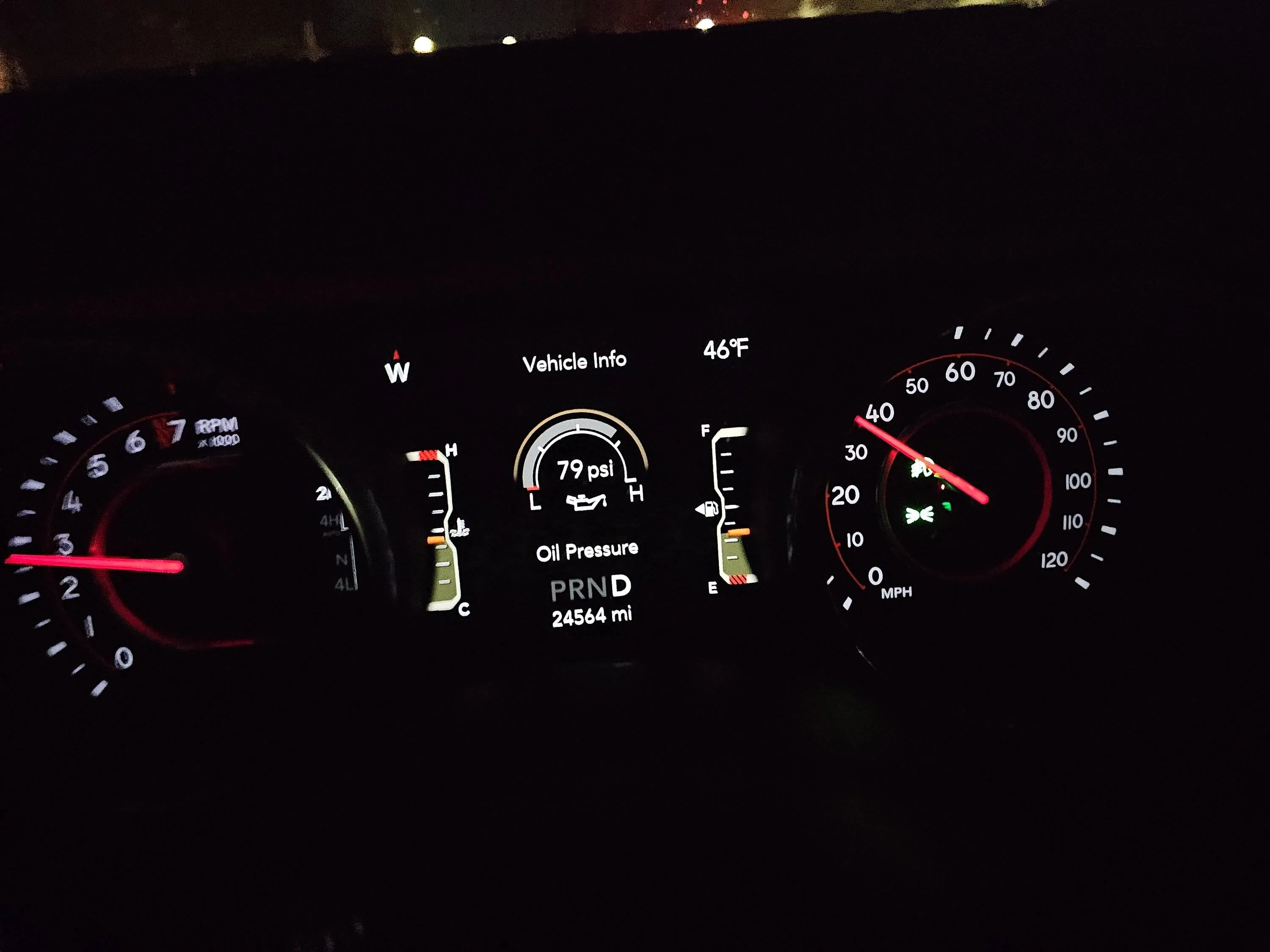

Without even trying on my way home from dinner. Stock no Baxter adapter yet.

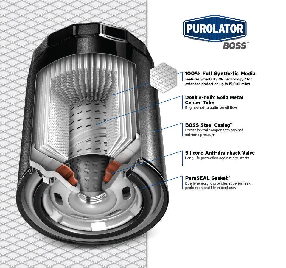

With the Baxter you have two anti drain back valves
One in the Baxter adapter and one in the oil filter
The factory has NO anti drain back valves
Do this simple test
Let your jeep set over night and then remove the oil filter
You wont find an oil filter dripping in oil and filter housing full of oil
What you will find is an almost dry filter and filter housing
Most of the oil from the filter housing and oil cooler has drained back to the oil pan
So now when you start your motor not only do you have to fill the oil cooler and filter housing put you also have to push all that air out of the oil galleys and that's a lot of air

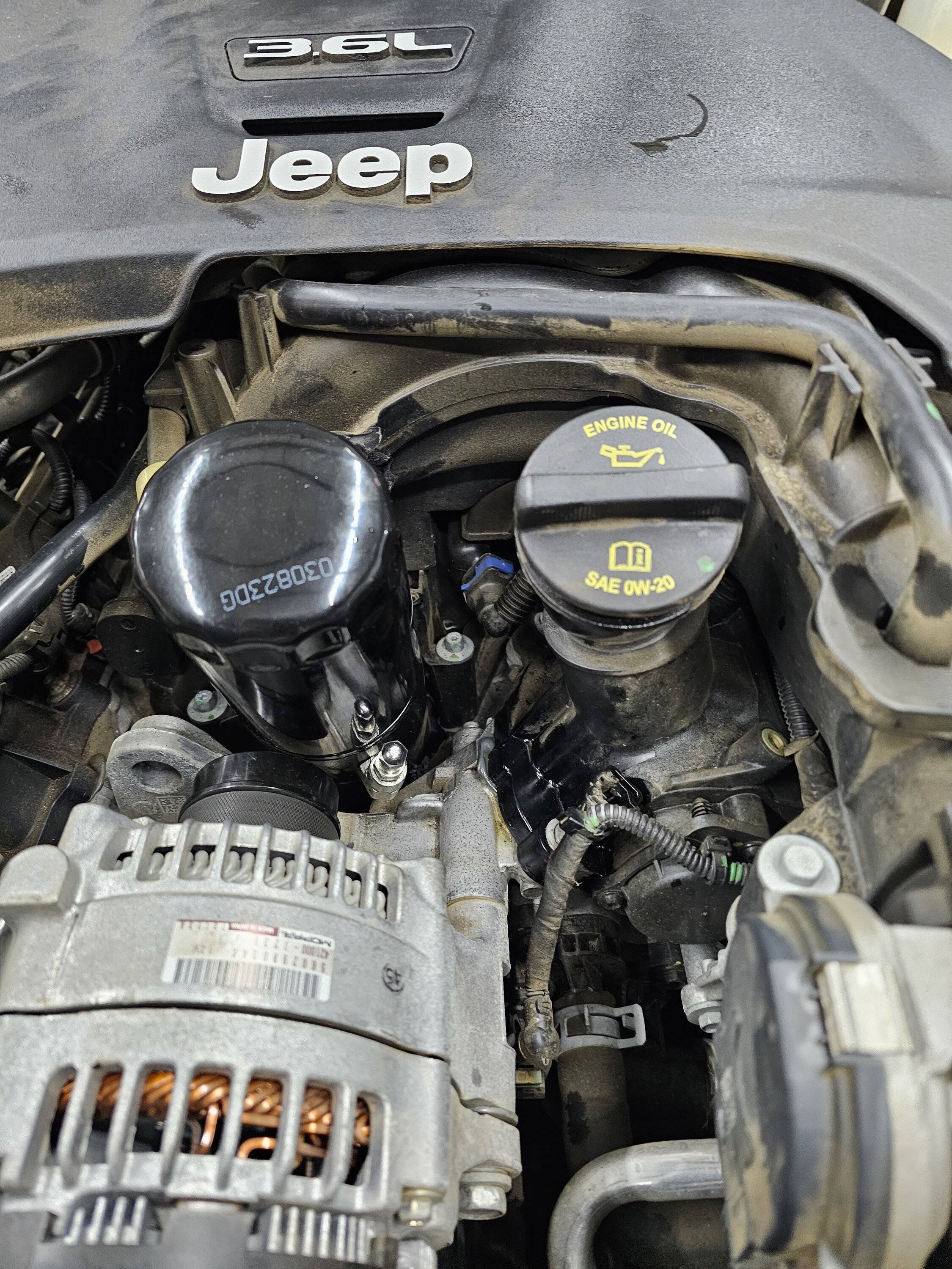

Got mine installed to day. Oil pressure seems to be the same as before. No warning lights or any issues so far. I'll run it and report back.

Once I pressurized the system then let it idle for a few minutes, I was 1-quart low actually. I drove it around a bit and let it sit again. Still one quart low so I topped it off. Total system holds 6 quarts, I will let it sit for a few days to see if the level goes over.

1qt seems like a significant volume difference. The baxtet doesn’t appear large enough to support 1qt by its self but I haven’t held one ?‍♂

Filter itself holds a lot and everything that is no longer draining back down. When you check the oil it's not running? So with out baxter it takes a min for the whole system to drain back down. Baxter system doesn't let so naturally you will be low when checked.
