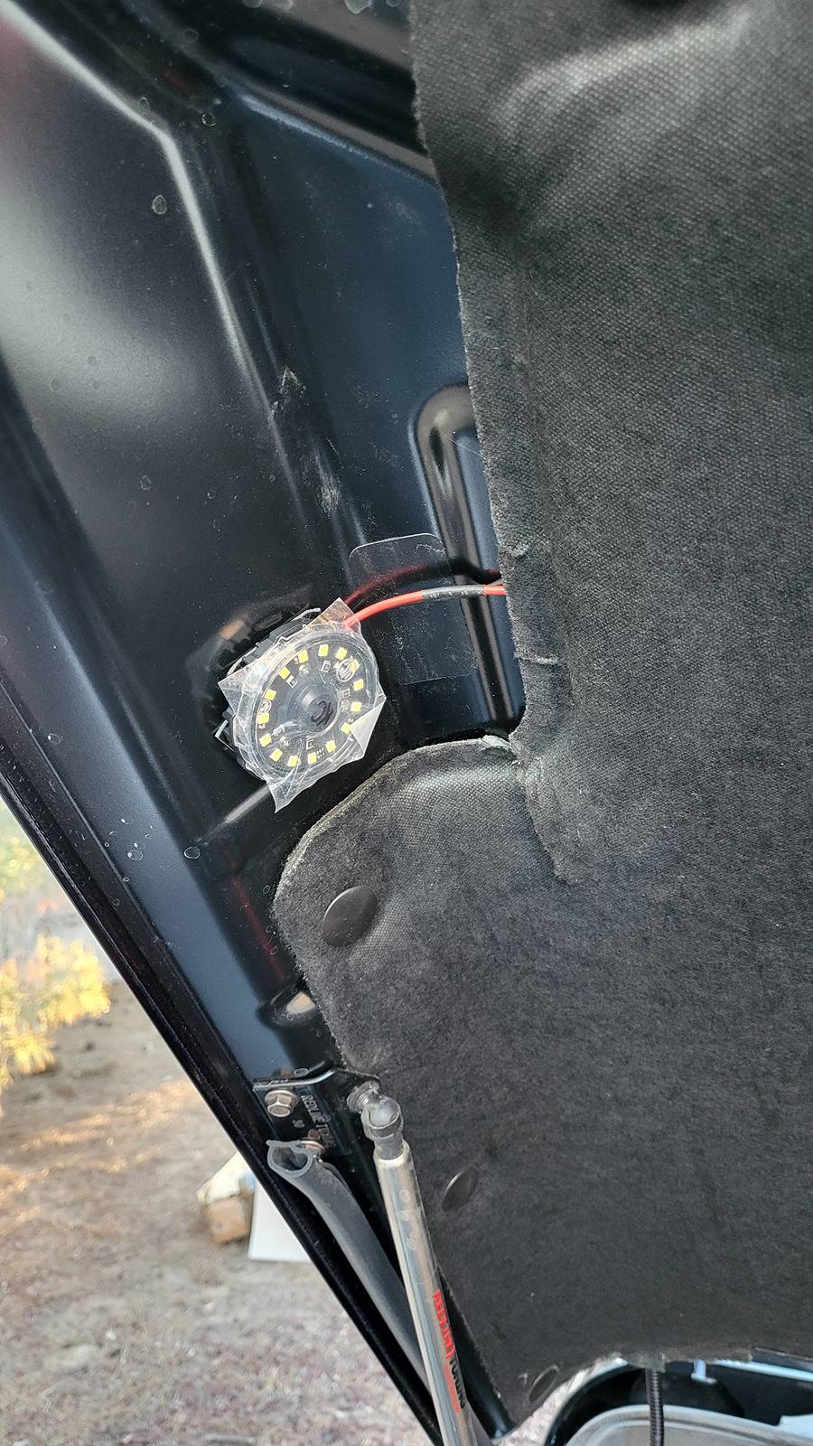

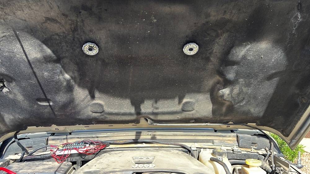

First off, DO NOT use a magnet set up. Magnets are affected by heat and lose their attraction as they get hotter. The sun beating down on the top of the hood and the radiating engine heat will cause them to let go. I know...I tried doing that with 25# Rare Earth Magnets on my 2016 JKUR.
Second, I won't naysay the VHB tape idea. I use it for a lot of things on my build and it has worked well but the reality is that tape will eventually fail.
Here is IMHO the easiest thing to do and I have done it on all three of my current jeeps...the oldest being installed in 2016 on my JKUR:

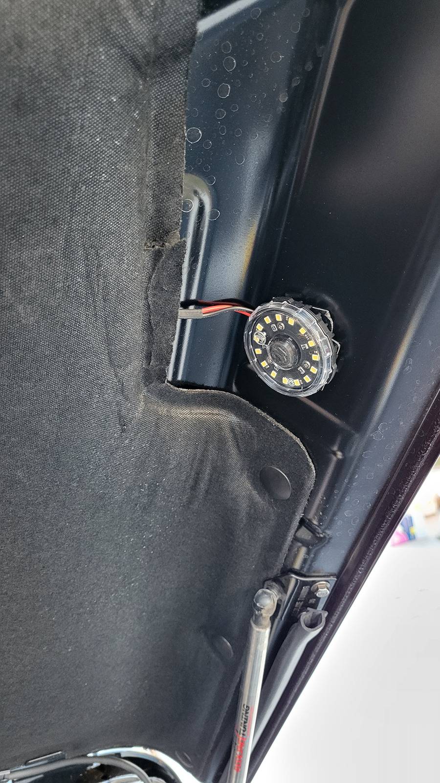

There are two push plugs holding the center of the matting to the underside of the hood. Remove them, trim the heads to match the hole in the KC Cyclone light (or find some that are the right side) and push them back into the hood with the lights attached:
I trimmed the matting around the holes a little for a better/tighter fit and ran the wiring down behind the matting. On the JTR I hooked to Aux 4 and on my two JKURs I bought a Mopar bracket for the hood open sensor and just mounted a toggle switch there.
So far I have had these lights installed this way 7 years on one Wrangler, 5 years on another Wrangler and 3 years on the Gladiator and they haven't missed a beat.

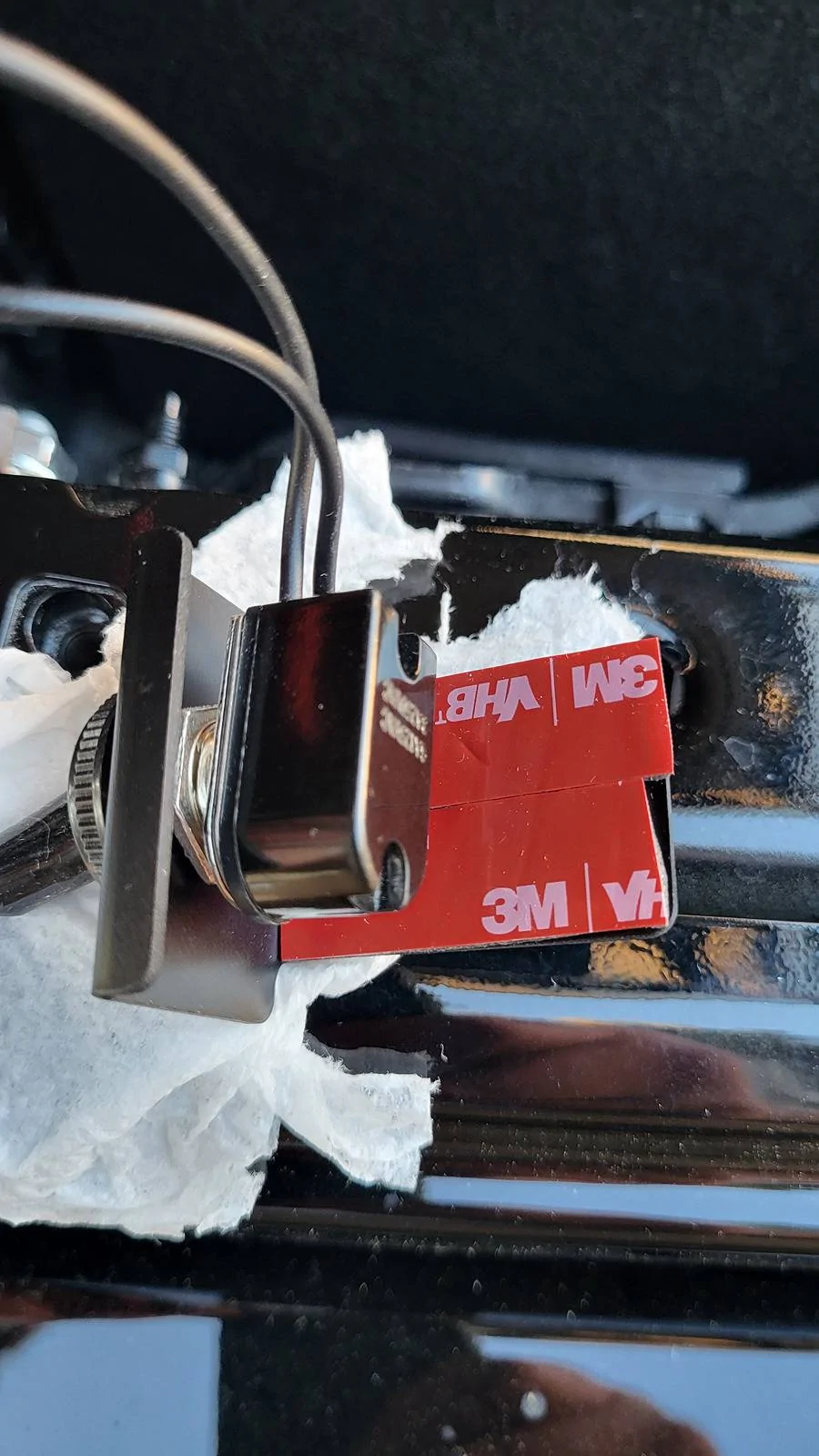

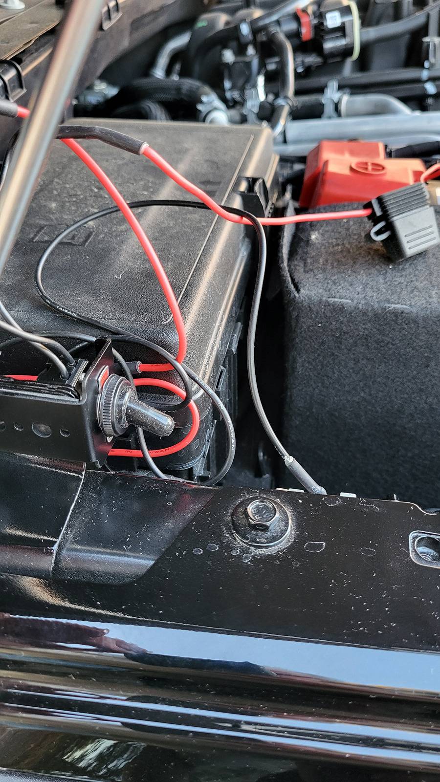

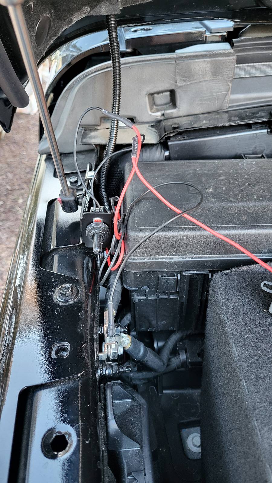

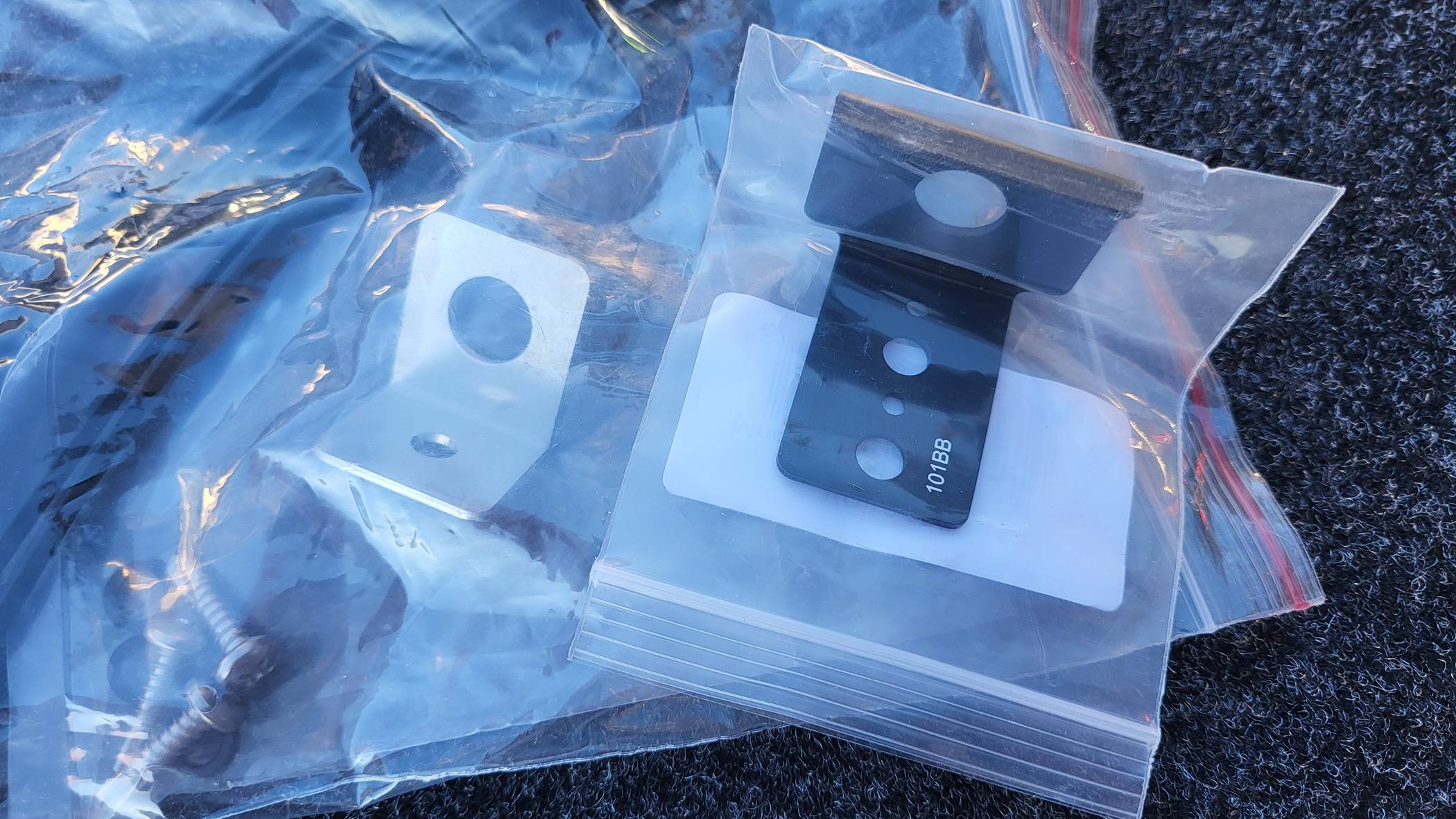

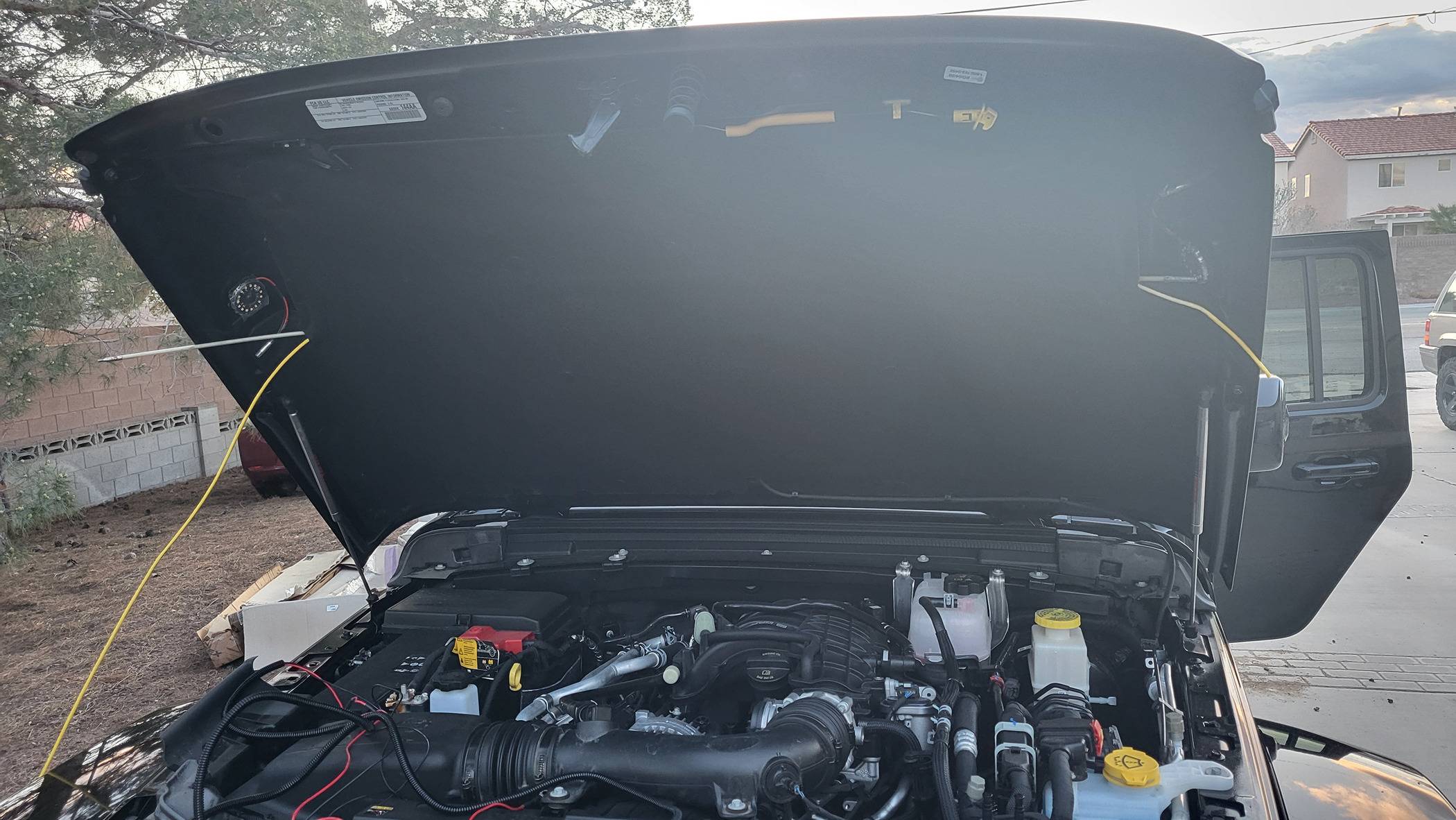

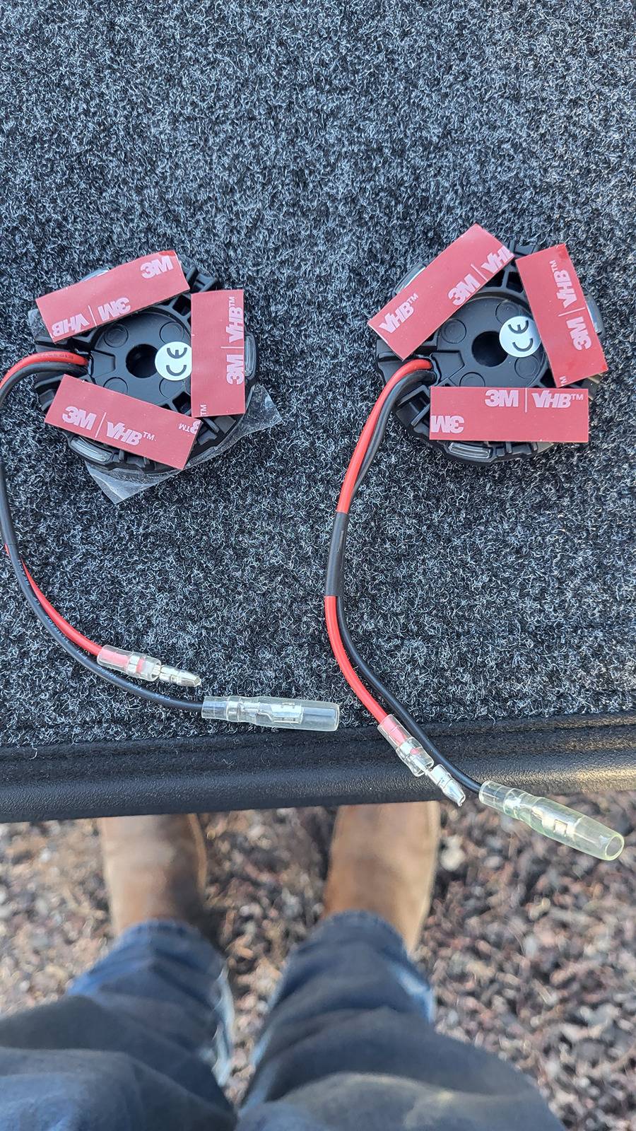

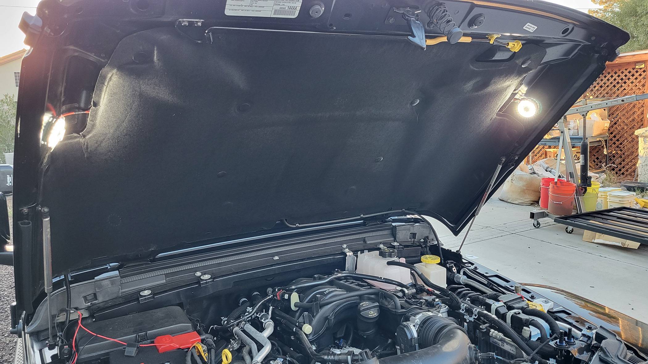

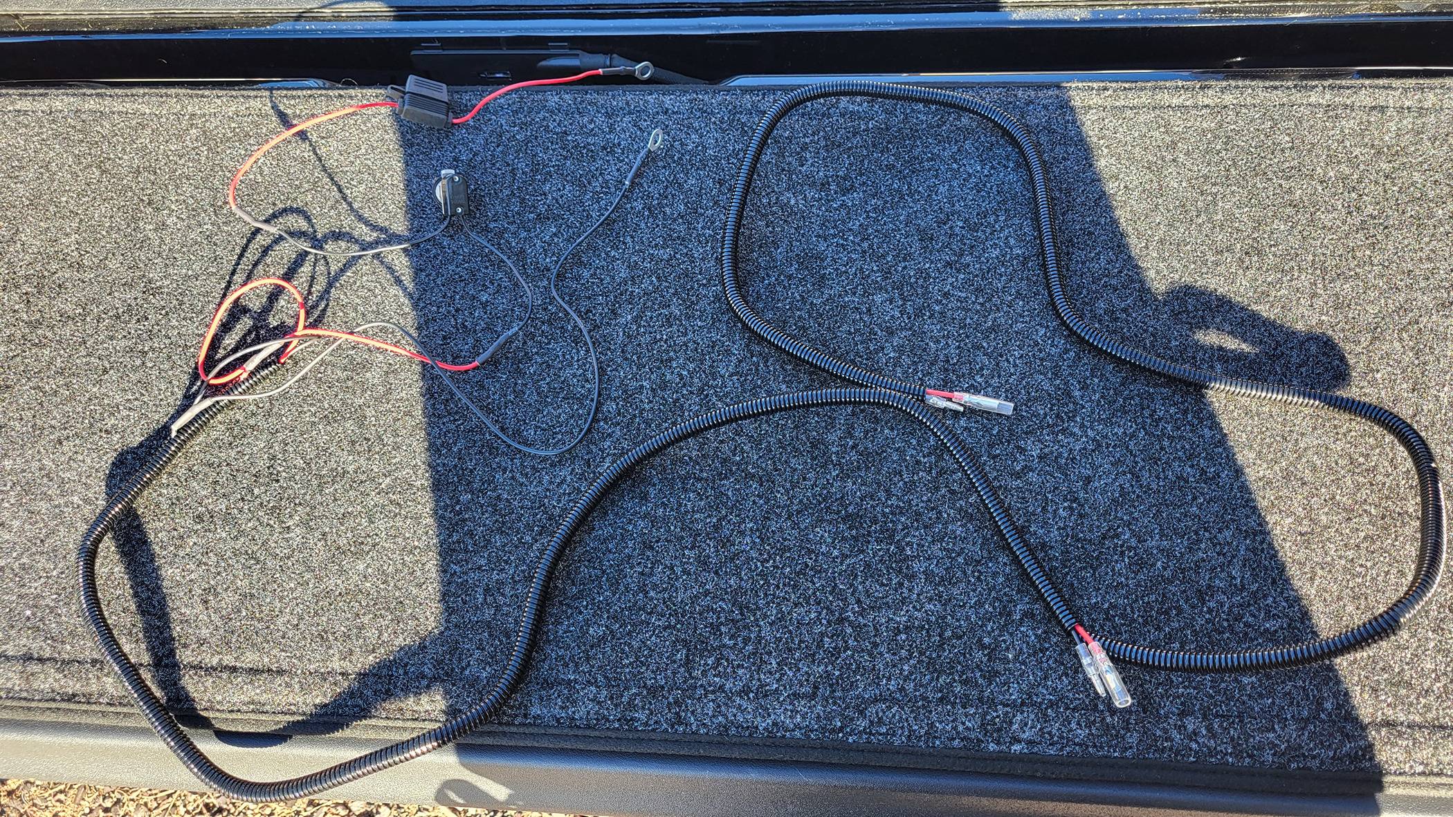

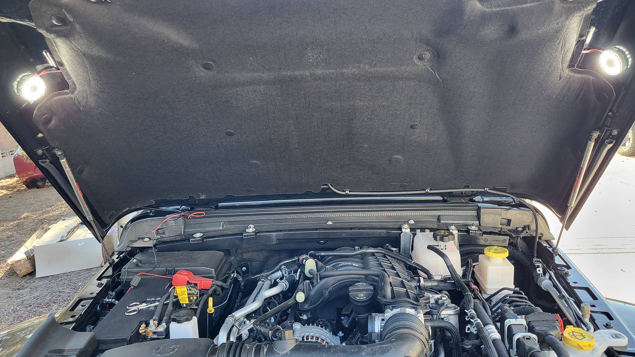

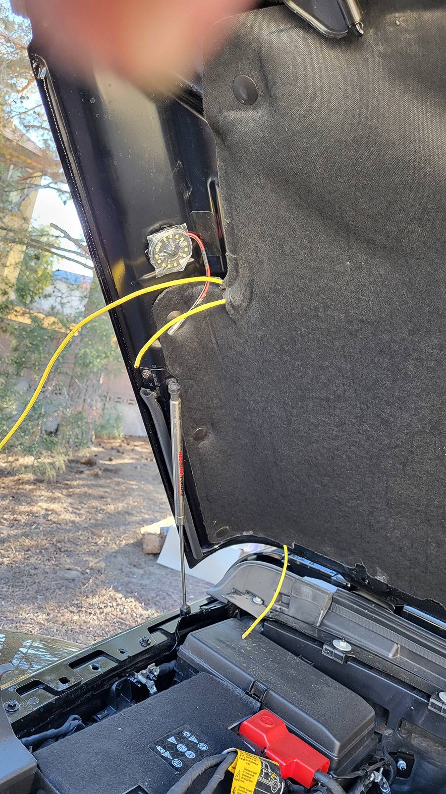

I installed the new set today. I roughed up the insulation a bit sticking my hands under it, but it seems okay. I ran some cable under the insulation to pull the wire through. I bought a better bracket to mount the switch. It could be screwed in, but the 3M VHB tape is quicker and easier. The wiring isn't finished, I'll do that when I install the cables for the winch and third battery.

I didn't want to mess with pulling the plugs. I thought about it, to make it easier to run the wire under the insulation. But the tape worked good for the first set, so my laziness won out.
