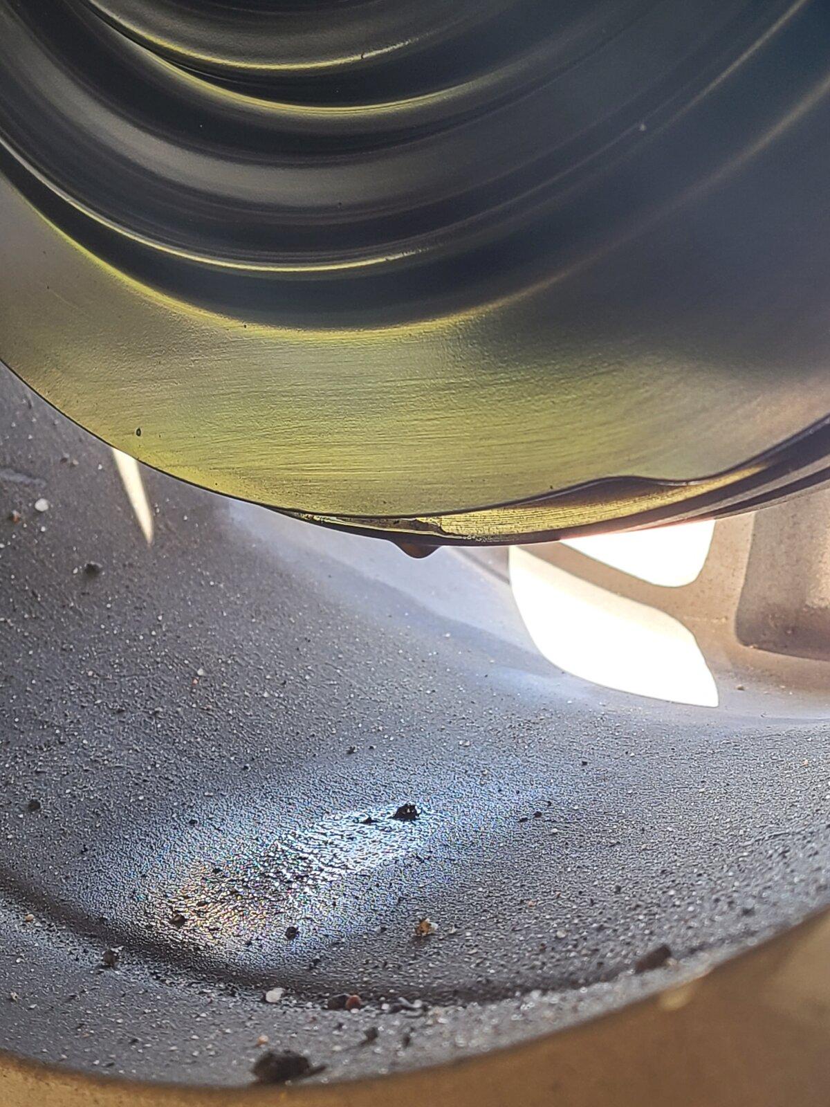

Update:
After having the repair done, leak reappearing, being told it was the vent and then residual water (4 visits total). We put it on the hoist, cleaned everything up, and took this picture about 24 hours later. Chrysler Canada said dealerships are independently owned and they "can't force a diagnosis". So looks like I will be driving twice to the next closest dealership (approx. 2 hrs Way) to get diagnosed and fixed ?‍♀

Update:
Edit: Sport S 80th Anniversary Edition

My biggest issue is how can the dealer figure out if it's a seal issue vs overfill from factory or vent issue? I mean you can check the level of fluid and possibly the vent, but do they do this prior to pulling it apart?
40,483
53,965
Factory overfill? Don't know how you overfill these since it's full when the fluid runs out the fill hole and you'd have to have it tipped forward and keep filling it and put the plug in. In the vehicle to check for that is so simple I bet my grandson could do it - pull the fill plug out - if fluid runs out it's too full, if fluid doesn't run out, it's not too full. 30 second check.
Not sure how they'd get one too full - keep pumping and put the plug in super fast before the extra runs out?
If the vent passes air - it's not plugged or a problem. These don't heat up in seconds - it's not like they need to pass 100 cubic feet of air in 2 minutes.
IF it's leaking it's almost always an issue with the seal area - that can mean shaft, seal, bearing, etc. but in all the years I've worked on cars/trucks/differentials/transmissions, checking the vent was as simple as looking at it or blowing air through it. There was a nipple on the axle tube, a hose on the nipple running up into a frame area or high up on the chassis and a simple check valve at the end of the hose. That, too, was about a 30 second check. These are not that sort of vent any more but still about as easy to check.
In other words, there's about 3 possible issues - fill, vent, seal/bearing/axle.
The first is all but impossible unless you are really trying hard to over-fill, the second unlikely but takes seconds to check, and that leaves you with the axle seal area (seal, bearing or axle itself, perhaps even AXLE TUBE issue)
Thank you for the insight. I'll check the first 2 and leave the 3rd to them. My dealer says they have not seen any others with this issue as of yet.

So I've been reading jeep blogs, many other bits of info on axle seal leaks and talking to my mechanic friends, and it does seem diffs can be over filled as they should not be filled to the fill hole, but about
1cm below it at axle tube level and the new gore valves can be restrictive in comparison to free flow valves, but offer much better protection for off road use. Pressure can cause axle seals to weep or leak due to them being the weakest spot when pressure builds up. So there could be a combination of issues, and in these blog posts some had leaks that slowed or stopped after leaks began, prior to repair and or after changing the valve or modifying it. Some continued to have leaks after repair/replacement of the axle shaft. I can only wonder if it's the valve and slightly over filled diffs and the seal on the passenger side just being the weakest spot. The gore valve is quite restrictive when I removed mine to check it out and my diff flowed out about 2-3 oz. when I removed the fill plug until it was level with the fill hole on flat ground. Checked with a level. Idk. I didn't drive mine for 3 days Temps were 90-100 degrees checked each day was completely dry, temp dropped to 60s and I checked day 4 and had some leakage again without moving it. Could temp changes outside cause enough pressure to make it weep? Wish FCA would figure it out. @JeepCares Any new info on this problem?
