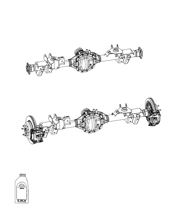

Yes, I have. Initially they blamed the leak on leftover oil seaping into my parking brake shoes. But after they replaced the parking brake shoes the leak appeared again. My JT is at the dealer right now getting the entire rear axle assembly replaced ( 68422837AF - not just the right rear side this time)
The housing and all??? Wow
Yes that’s correct:) I think I’m the first one who’s gone thru this full housing replacement. Just got my Jeep back from the dealer earlier this evening. It took less than 2 days for the swap.
So far it seems like everything was put back together properly. Braking feels a bit different with all brand new rear brake/parking brake shoes.
