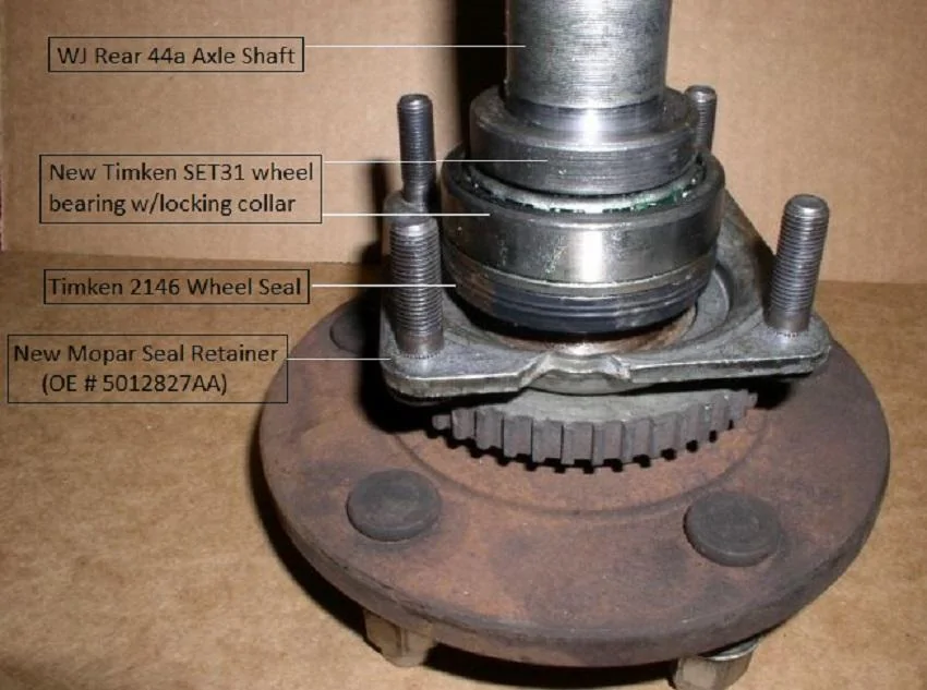

Talked to my service department on Saturday and they pulled it in the shop looked it over and drove it. Told me it’s ok to drive for now. Part had a tracking number 10/13 but never shipped and nobody knows where it went. I brought it home and this morning pulled the passenger side wheel, brake caliper, and rotor off. Fairly oily on parking brake shoes and brake pads. You can see where the outer seal has pulled away but I couldn’t see any oil there. Anyway I put it back together and drove it some. It’s not making any noise at all like it was when I parked it and quit driving it back on 10-6. Here’s a couple pictures I snapped.
That’s not the seal you see there, it’s a dust shield. The seal is behind the retainer, which is behind the dust seal from the perspective of the photos.
Yup - what he said.
For reference - this is an OLDER Dana axle from a WJ, but gives the order of things - generally speaking - and shows that you can't really see the seal when all is installed. It's behind the retainer and in the case of the JT - a shield.

Yup - what he said.
3817615d1555050501-rear-axle-seal-leak-dana-rear-44a-axle-shaft-new-timken-set31-bearing-seal-se.jpg
Yeah kinda figured that out due to how dry it was there but wet behind it. I just figured it was the outer part the bearing being pushed out because the bearing is starting to fail maybe. It’s been making a noise that sounds like the tire rubbing the fender liner but it’s not. Thanks for the information and picture guys??
