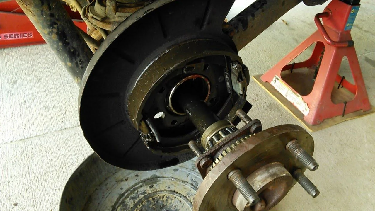

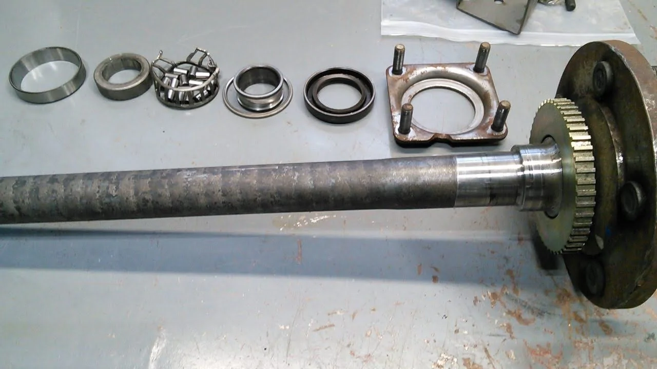

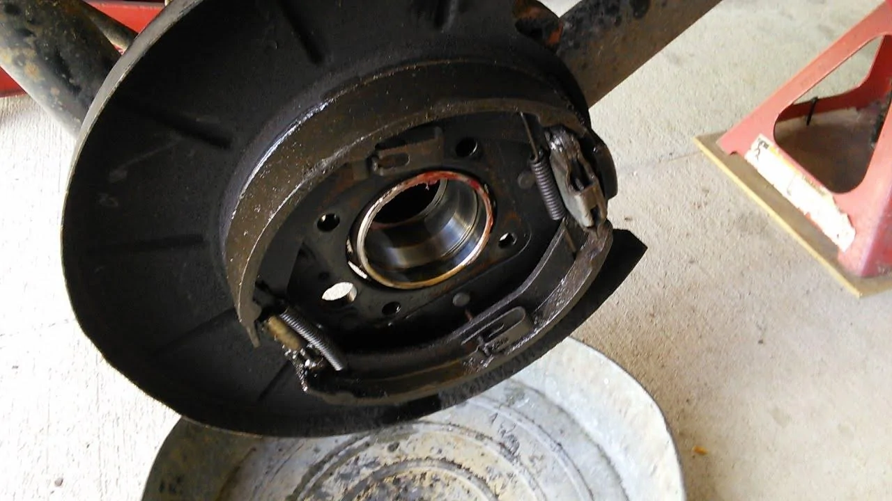

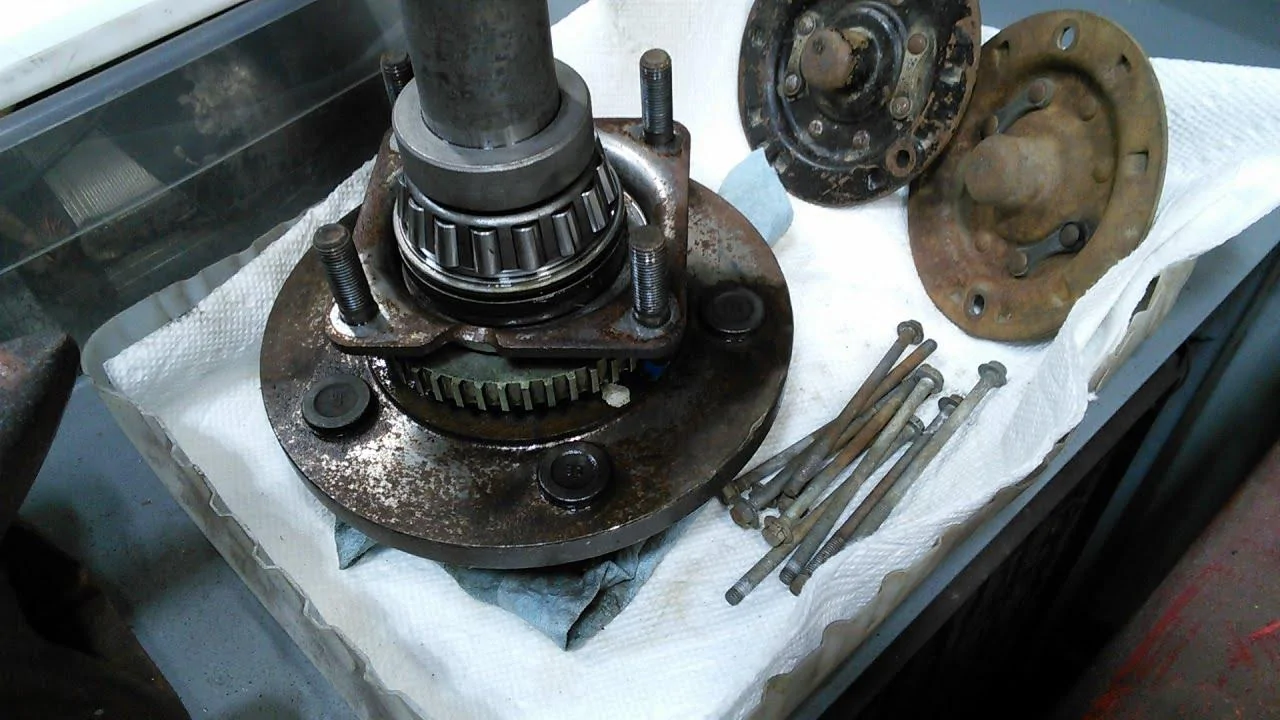

This is an older one, much worse leak. Fluid totally covered the parking brake and was getting to the others, but not quite.
Jeep Gladiator Leaking axle seal? IMG_20201011_141633
Axle checked out great - no runout, no scarring, size was perfect, bearing had broken and seal was worn.
Jeep Gladiator Leaking axle seal? IMG_20201011_154604
Housing was also fine - unsure why the outer part of the bearing actually broke but a small flange part of the outer "race" had snapped off. Didn't impact the bearing itself. Perhaps a shock like hitting a bad pot hole or something.
