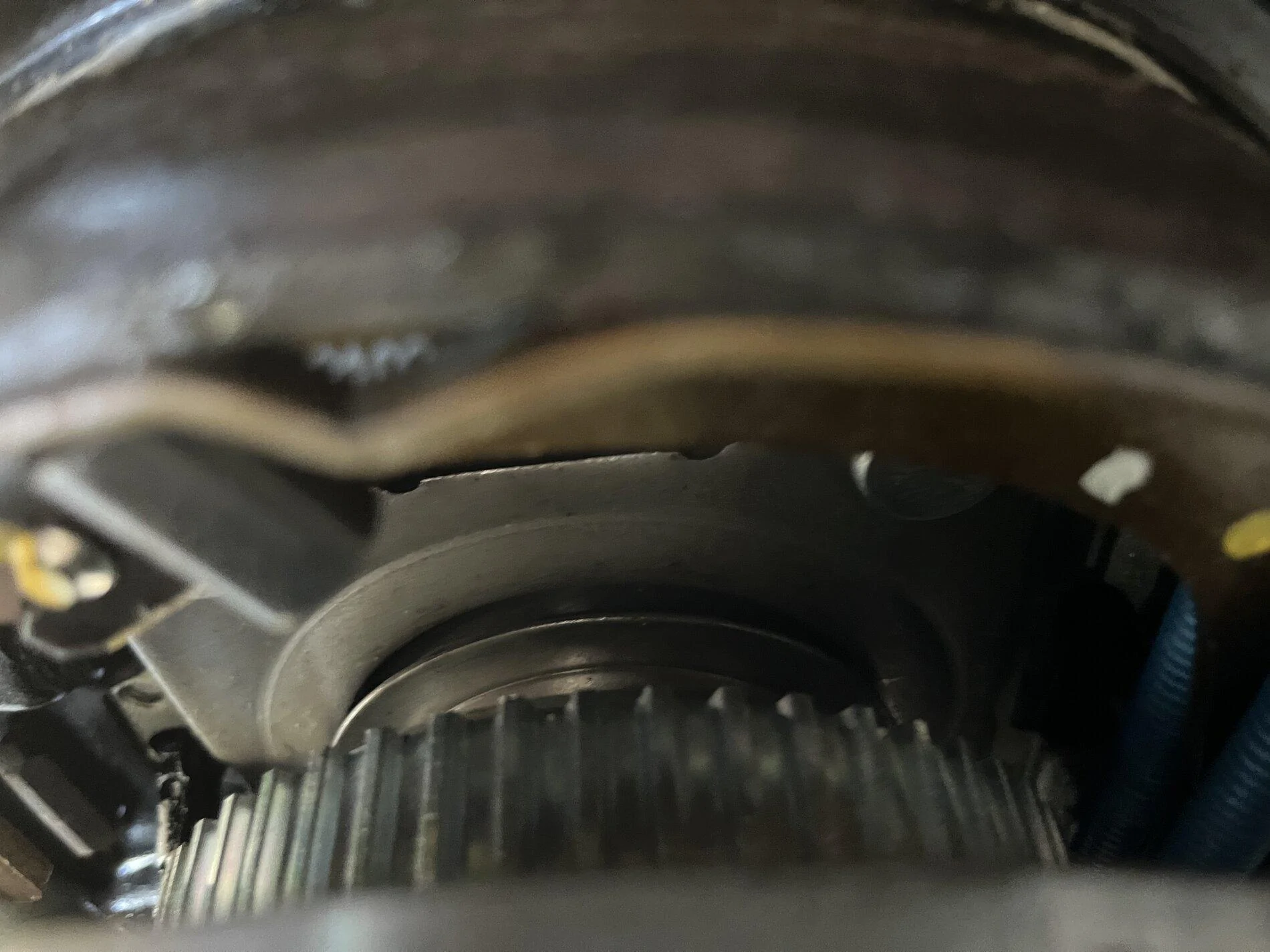

So there’s this guy that got a new pull off shaft because someone was upgrading their axle shafts. So he was swapping it out but before he put the new one in he felt a little sharp piece of metal. Slag from the manufacturing process?
pic out of focus and can't really see much....but yeah a sharp edge left over from machining could certainly mess up a gasket/seal. This could be the closest thing to a possible explanation we have seen so far....at least in my opinion.

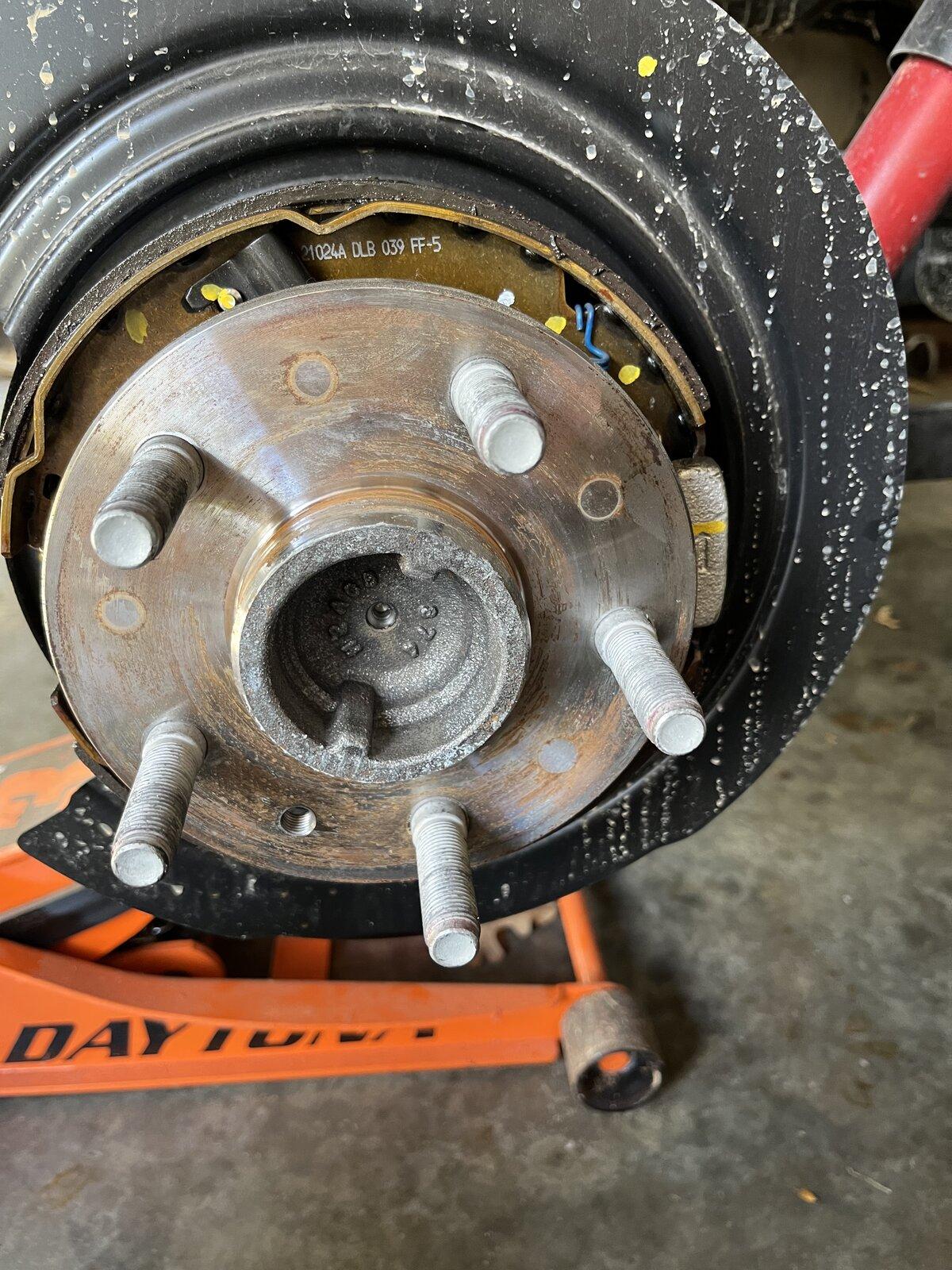

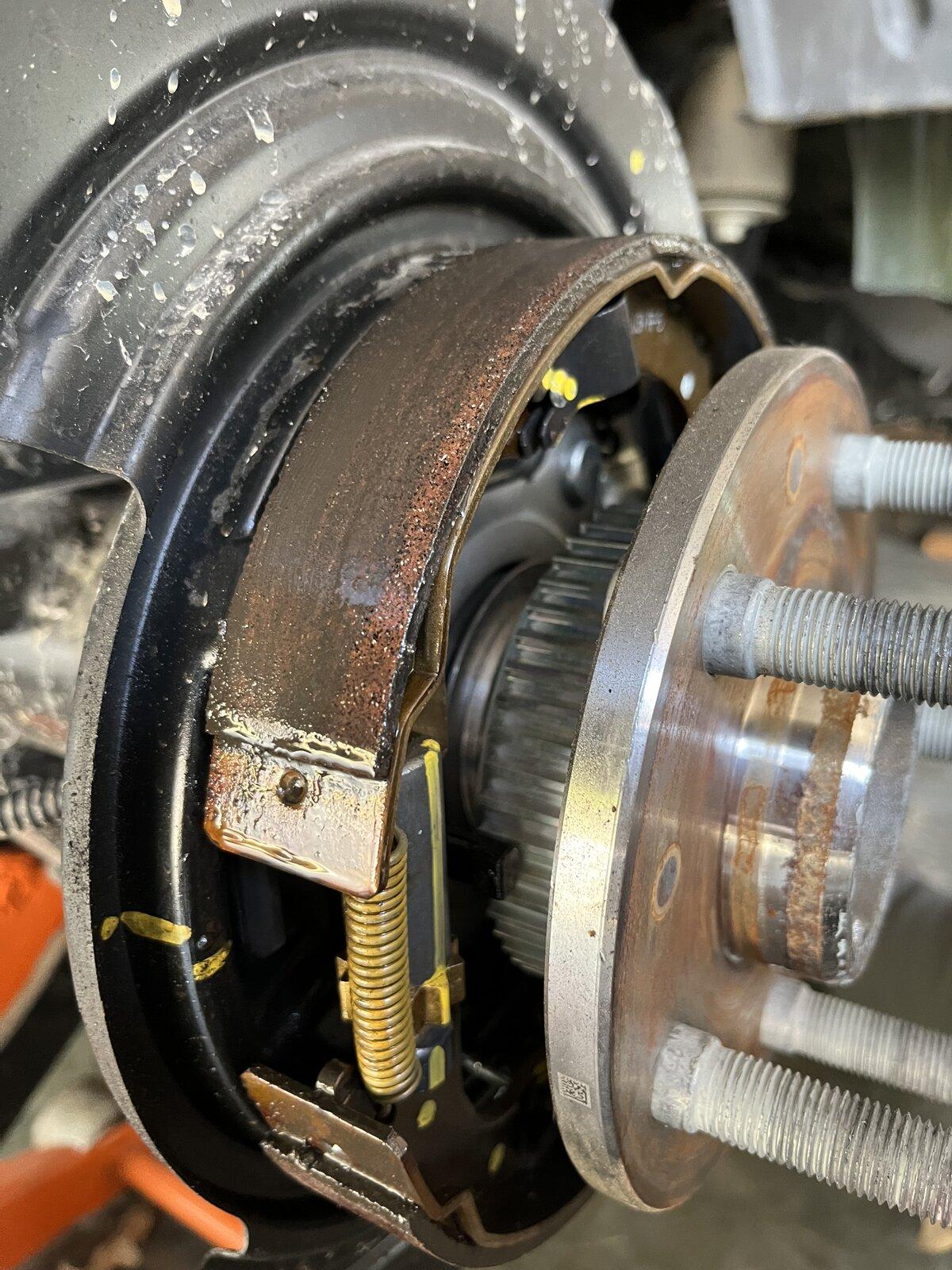

Talked to my service department on Saturday and they pulled it in the shop looked it over and drove it. Told me it’s ok to drive for now. Part had a tracking number 10/13 but never shipped and nobody knows where it went. I brought it home and this morning pulled the passenger side wheel, brake caliper, and rotor off. Fairly oily on parking brake shoes and brake pads. You can see where the outer seal has pulled away but I couldn’t see any oil there. Anyway I put it back together and drove it some. It’s not making any noise at all like it was when I parked it and quit driving it back on 10-6. Here’s a couple pictures I snapped.

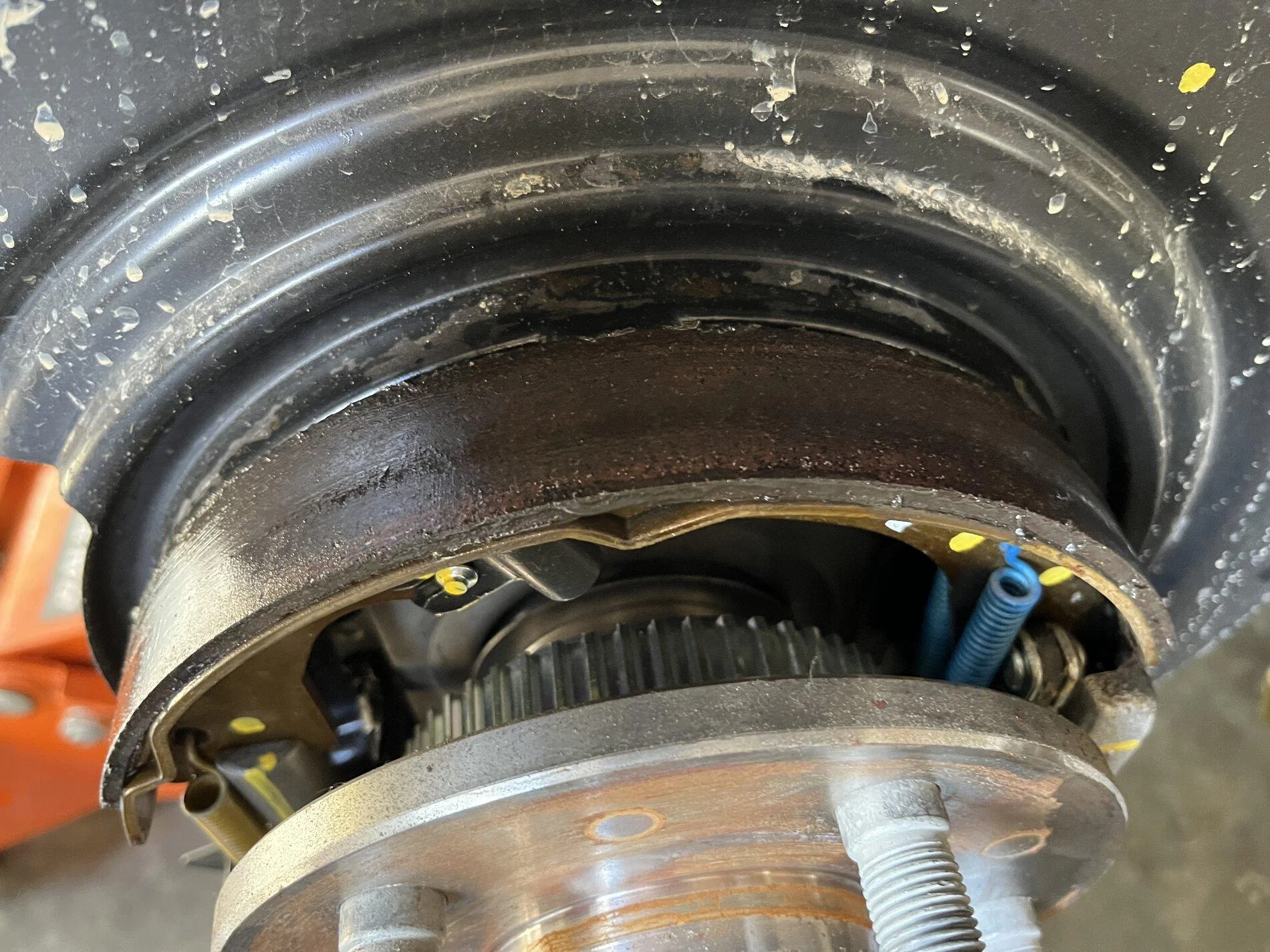

My 2021 Sport S ecodiesel gladiator (built 10/2020) was into the dealership for service a few weeks ago. They did an oil change/ tire rotation under the jeep wave plan. The didn't mention any issues when i picked up the truck. Last night I was installing aftermarket wheels and tires. I noticed the inside of my front passenger wheel was black from grease when i took it off. when i got around to the rear passenger wheel i noticed some grease as well. Drove the truck home last night and now there is already grease on Rear Passenger wheel. I called the dealership frustrated this morning because this wasn't brought up 2000 miles ago when they had the wheels off. I have a service appointment set of for 11/9. I am stopping by today to have them inspect it and so they can get parts ordered. We will see how this goes... This will be the jeeps 2nd major warranty issue in the last year. I had the starter replaced with 300 miles on the truck.
Stopped by the dealership and they confirmed what i thought. Luckily i am still able to drive it while i wait. I spoke with my father-in-law who has the gladiator that came off the line directly in front of mine and he checked and has the same issue. Seems like Jeep should be doing something proactive about this. Or at least having the service departments looking for this when they are in for service.
