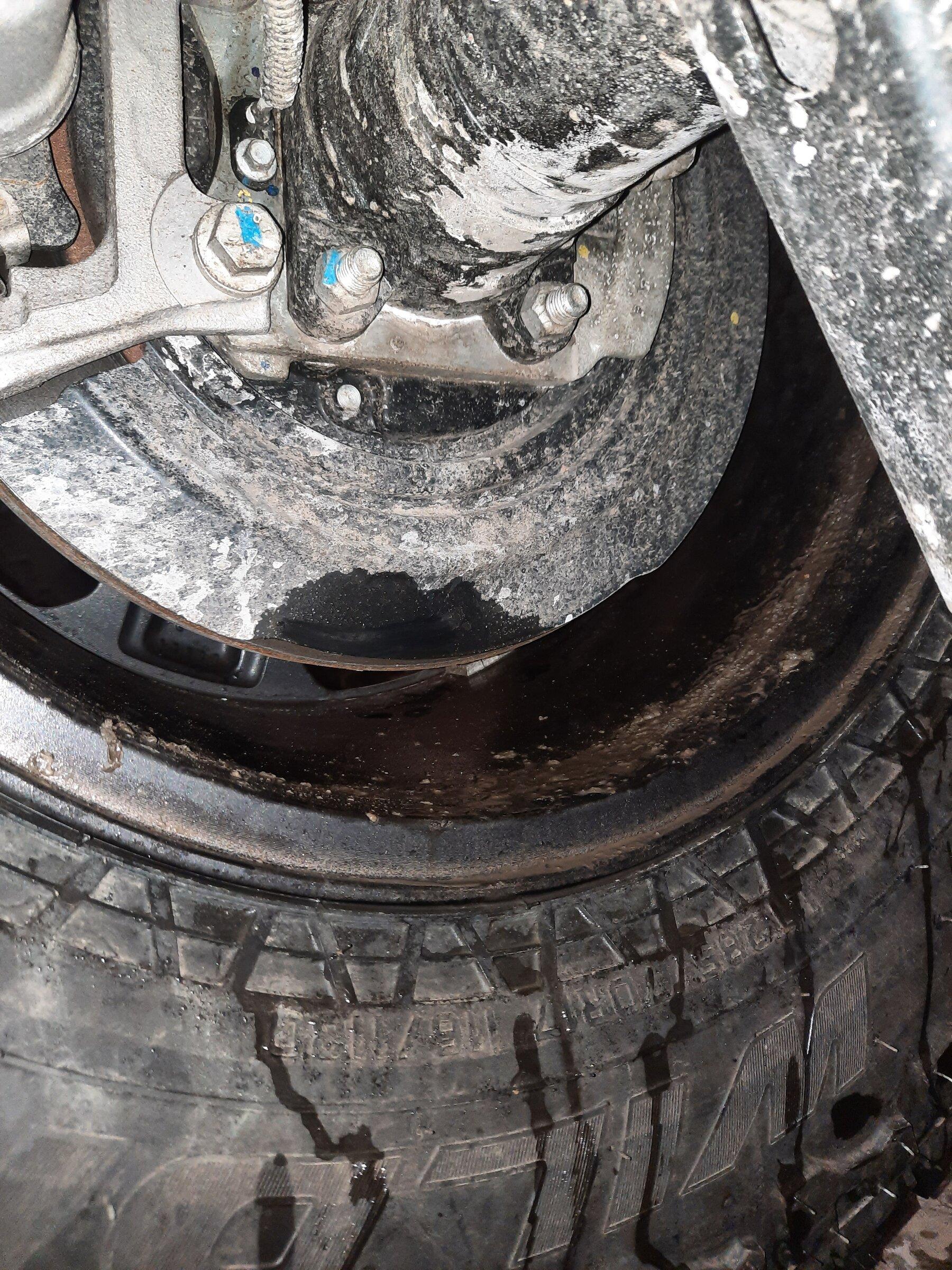

Womp. Was really hoping I'd be one of the lucky ones. Noticed this last night. 1000km (600mi). I had 37s on for a week, maybe a couple hundred kilometers. I was swapping the stock tires back onto it and found this. Driver side rear axle leak. Built October 2021.
Driver’s side?? You’d be the first one, yes??
Driver's side yeah. As for being the first, I don't know. I didn't read through this entire thread, but the posts I did read were all passenger side. Maybe I'm a trailblazer! Do I get a hat, or something? Lol
Wall of fame Justin!!. All the theory white boards are wiped and we all have to start over! THANKS A LOT! LOL You sure youre not driving one of those right hand driving models?
