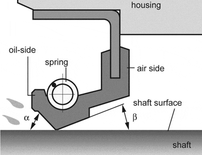

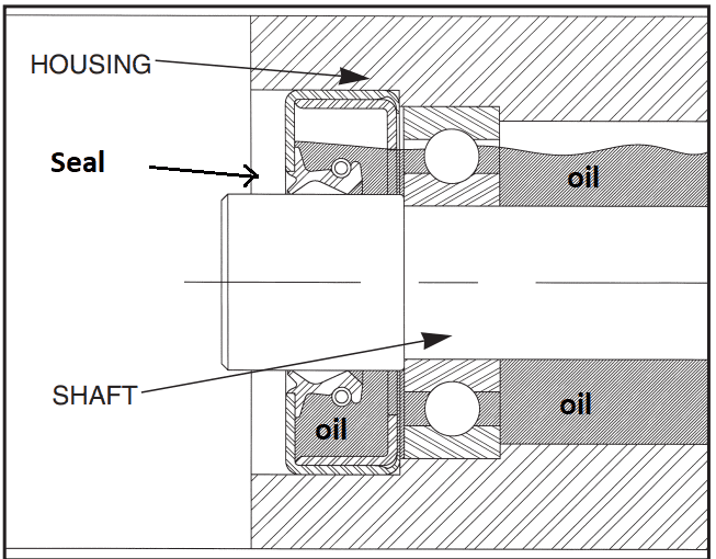

No, you don't want oil to "condition" seals or make them swell at all.
Sorry, I strongly disagree on that.
That's for old, hard seals. New seals are supple enough. You don't need or want swelling. If you soften them too much with such things they actually "grab" the shaft and wear faster and get hotter.
I've been dealing with axles and seals since I was in my mid-teens, cars and trucks of all sorts, including the big power company boom trucks, and including 1910s stuff. A good seal needs nothing at all but a good lubricant like any other moving part. Why the hell would you want to soften an already flexible seal that's being forced against the shaft with some real pressure?
This isn't a case of lube not "conditioning" seals. That I will bet on. Only the companies selling lubricating products will throw that out at customers. The last thing you want is anything that makes seals softer unless they are aged and hard.
Now if these SEALS have a problem that's different, but a good seal will last well over 100,000 miles with any good lube, and not need conditioning. The reason they eventually start leaking is age (they get hard) and/or wear.
I've replaced axle seals and rebuilt transmissions after someone put "seal fixing products" in them.
There's already tension on the seal against the shaft - you don't want more (read up on seal design and engineering) A standard lip type seal actually will hold back at least 7psi as it sits right out of the box and as pressure builds, the lip is pressed harder against the shaft, increasing the seal's sealing power.
The damn oil companies try to sell product by convincing them they need "Seal conditioning" and that's just marketing bunk. I will never put anything that claims to soften seals or condition them in a vehicle that is A - under warranty, or B - fewer than about 100,000 miles (and I want to stretch some life out of it).
Seals don't need conditioning. We've gotten by many decades with ordinary plain hypoid lube without solvents and "seal conditioners". Why would it be "needed" now? To sell fancy oils, convincing the unsuspecting public that it's what they need.
As a guy who has made his living fixing leaks, rebuilding axles, transmissions and engines, and putting lube and fluids back in, keep that stuff away from my vehicles if it claims to soften seals or "condition" them.
Here's another reason that's not the issue - only the right seal. Think about it - ONLY the right. That's a lube issue?
Why not the 2020? You think they changed hypoid lube to something without solvents to soften seals?
The why not the front?
Why not the left?
You have a sharp seal edge against the shaft surface, in most cases it's being forced against that shaft with a spring ring. Any internal pressures force the sealing lip against the shaft even harder. If you soften the seal, you flatten that sealing lip and make it LESS effective, you don't want more surface against the axle, that reduces the sealing force. You want a thin lip of rubber against the shaft - that means the pressure is higher on that thin lip for a better seal - otherwise the seal's sealing surface would be flat, not sharp.
(my college prof would be in full defense mode right now regarding seal conditioners. We were warned in no uncertain terms - only as a last resort on an already leaking seal - as a band-aid. )

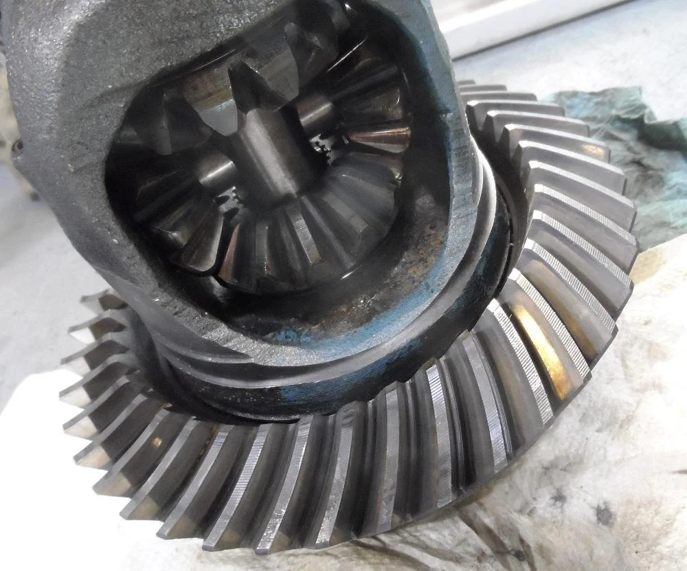

The right side is the "drive wheel"? Really? Care to explain how the differential works for those of us who don't know what a "drive wheel" is?
249
40,519
54,122
Good point that I missed. That's an old-fashioned thing that came from?????
The ring gear is bolted to the carrier. The carrier turns the spider gears that are pinned to the carrier. Those in turn, turn the side gears (those on the inner ends of the axle.)
As long as the resistance to turning is equal on both wheels, the pressure to make them turn is the exact same.
I could never ever figure out what a "Drive wheel" was having worked on many and to this day, sometimes look at them all torn apart and try to figure - how is one any more than the other since the spider gears are pinned to the carrier and push with the exact same, identical force on the side or axle gears.
Best I can figure is because when someone lays some serious torque down, that driveshaft is pinion clockwise as you look at it from the front. That torque is going to want to twist one side of the axle housing down and the weight on the other side will be lessened under very heavy acceleration. It's why a drag racing friend of mine used to run individual lines to his air shocks, so it could put more air in one side than the other to help prevent the twist. Some of these guys literally twist the chassis and for many cars (back to AMC again, AMX, Javelin) you can buy frame rail connectors to prevent twisting the body under the extreme twist. But normally, normal driving, it's not an issue, there's no more force on one than the other other than the tendency of one side to be shoved down harder under very heavy acceleration, high torque applications. But really, there's no drive wheel or drive axle.

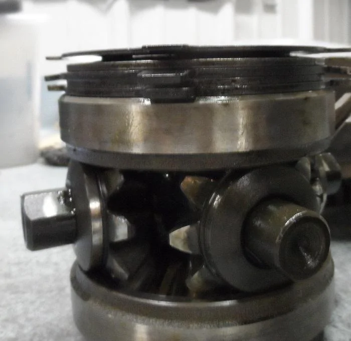

Can't recall which carrier this is - maybe out of one of my AMCs, perhaps an Eagle, but can anyone show a reason those carrier gears would put any more force on one side gear over the other?
Jeep Gladiator Leaking axle seal? misc-camera_4-16-17 037
Even with this style limited slip - the forces of the carrier gears are applied equally to each side gear or "differential gear" because the teeth are the same, the distances are the same, the same forces are applied exactly equally in all directions, forcing the clutch plates together equally on each side, locking the axles together. That means the forces have to be the same to each axle to apply the clutches equally - if it was open, same thing, forces are applied equally.
(it's a limited slip I rebuilt not long ago)
