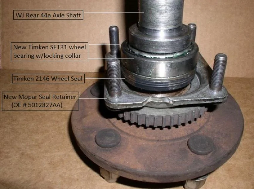

I don't know how removing the axles would destroy the seal.
The seal is on the axle, then the bearing is pressed on. Removing the axle pulls the seal out by the bearing shoving it out. It likely distorts it at the very least.
It's possible to remove bearing, remove seal, put on new seal and bearing and put it all back in but that's more labor, more time, and few shops these days deal with individual parts.
They'd not want to put the original bearing back on because the risk is high of damage taking it off and going back on with it.
This is an earlier Dana 44 from a Grand Cherokee, but it's the same concept.
Retainer goes on, then seal, then bearing is pressed on, then a retainer collar is pressed on.
Note this seal type seals against the housing by those rubber ribs on the circumference of the seal. EXTREMELY unlikely to leak unless it's damaged going in. A bit of lube on the outside of this type of seal keeps it safe going in. Never use lube on the seals with the metal outer shell and red sealer on the outer rim or circumference of the seal!

Like I said, I'm no expert! But now I know! Lol
248
40,502
54,076
As a machinist you'll get it really easy.
Doesn't hurt for people to know what's going on with things like this leak stuff, the more you know, the better equipped you are to tell when things are right - or not.
