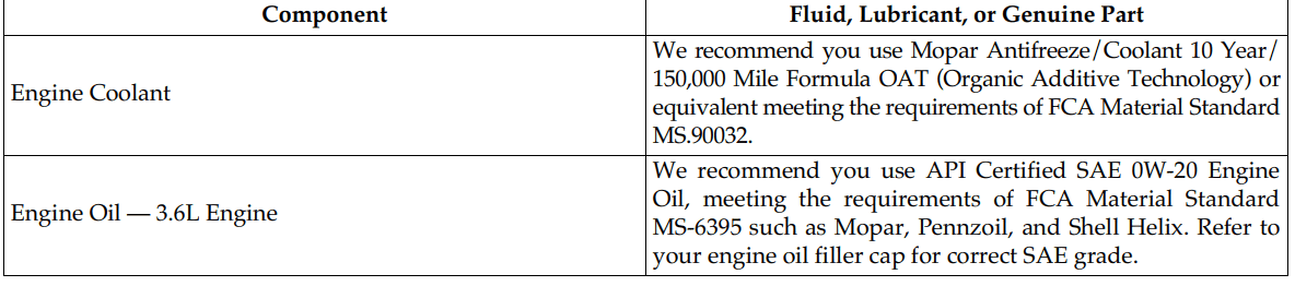

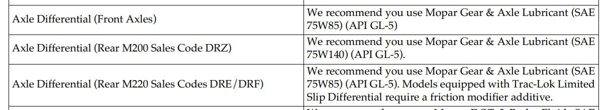

This thread makes me so happy that I have an early 2020 build. I had Yukon 5.13 gears installed last fall with Lucas HD gear oil. I could just imagine the problems I would of got myself into.
I hope you don't have warranty issues with that because the way Jeep has been working on some things, they might just fight you having used Lucas when they don't say "or equivalent" in their charts.
For engine oil, they seem to be fine with anything that matches their specs.

Note some words lacking in the chart above - (or equivalent) but are included in the chart below -
Jeep Gladiator Leaking axle seal? 1645389464073
