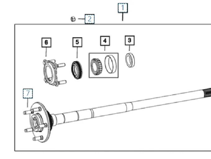

Here is the actual Gladiator rear axle parts book diagram. Note it looks just like what I posted.
The seal is on the very outside. The bearing and sleeve certainly do not slide freely on the axle! Can't happen or the axle would slip out. I've done a few Jeep axle seals - granted, not the gladiator, but the setup is the same and in the same order.
Retainer is 6 - slide that on first. It holds the axle in the housing by pressing the seal against the bearing (4)
then the seal (5) slides onto the axle.
Then the bearing (4) is pressed on with the wide side to the seal, the narrow side of the cone away from the seal. The other ring you see there is PART of the bearing, it's the "cup" or "race" and does slide into the axle housing. It is not rubber nor rubber coated.
3 is the steel retainer ring that is PRESSED on the axle after the bearing is PRESSED on. Nothing floats freely on the axle.

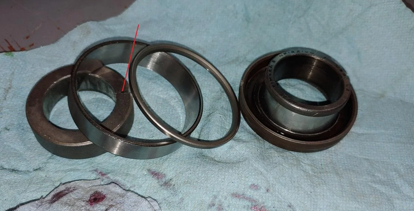

Here's another Jeep bearing I replaced. The line points to the bearing retainer I cut to relieve pressure and pop everything apart.
Jeep Gladiator Leaking axle seal? axle-bearing
