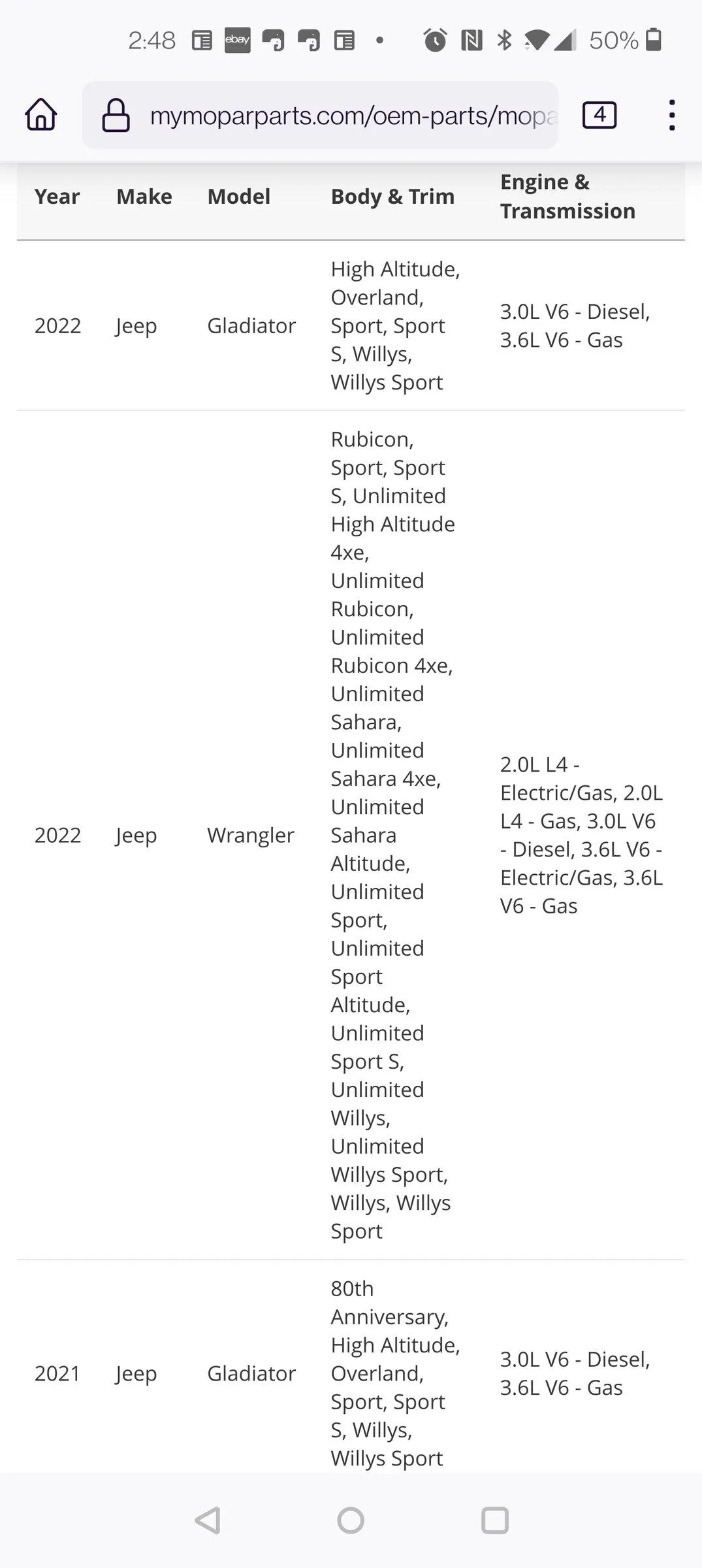

Quick search of that part number and comes up for wranglers.
I had mine replaced and part number was 68471168AA.
Not sure if wrangler axel shafts are compatible with gladiator shafts.
Edit: Just confirmed on the mopar site that it can be used on gladiators 68474094-AA
Looks like an older version I suppose or maybe I have the older version ??‍♂
That part is for both 4xe Wranglers and Gladiators.
Lol yep saw that too and made an edit on my post.
Can't help but wonder what the difference is between the 2 part numbers.
Which is the latest and greatest is the question I have now
