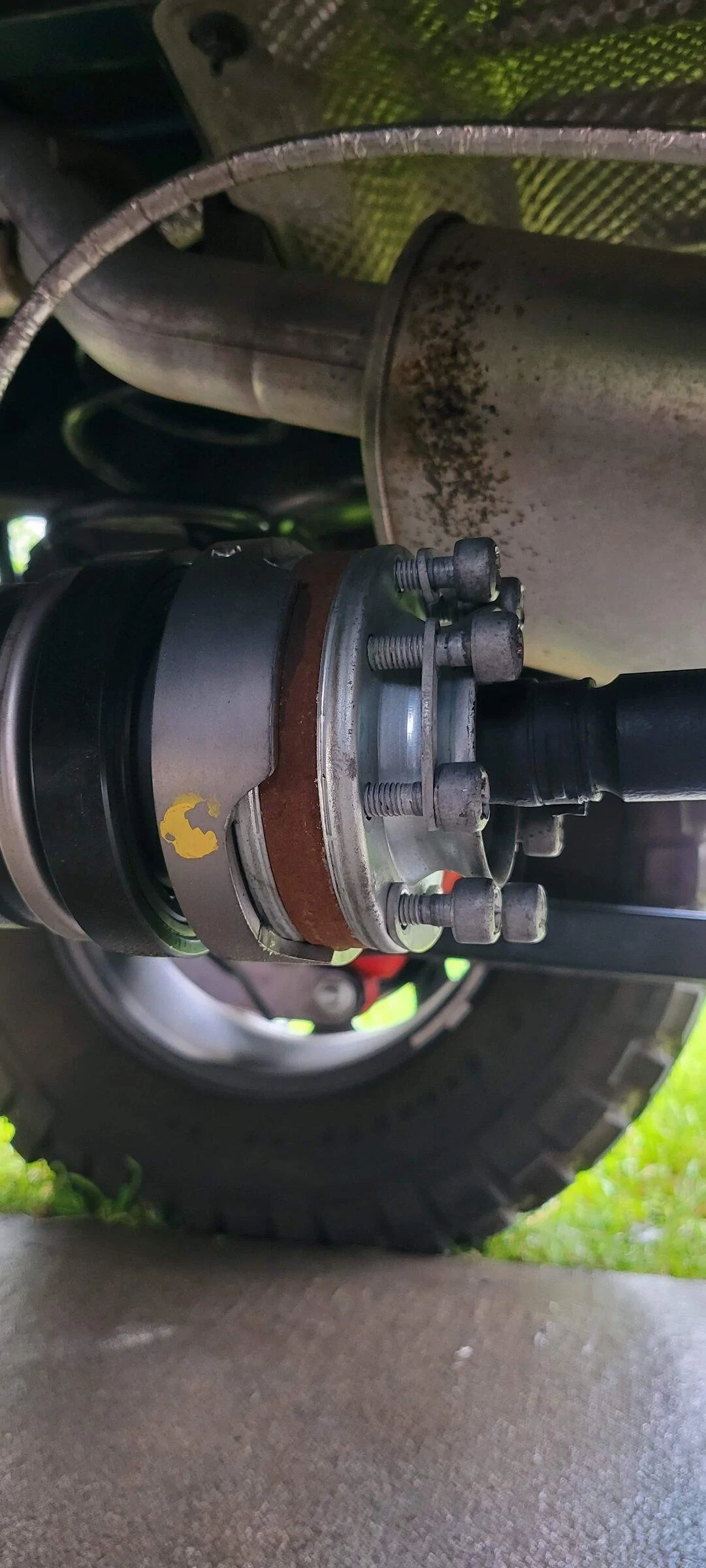

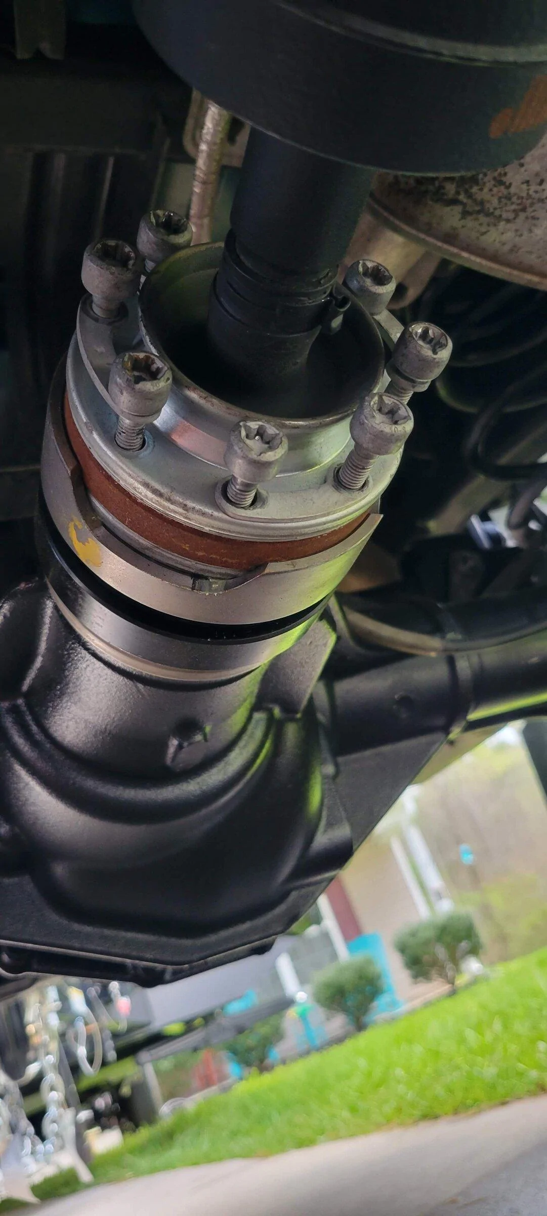

After having the second housing replaced, I could hear a slight "clunking" sound anytime I stopped then started driving again. And I've never heard it before, So when I got home I crawled under the truck just to look over everything. Then I found this gem right here
Wow.........
Glad the driveshaft didn't come off during highway speeds.

Wow.........
I was towing a camper home from storage, to go camping 3 hours away. Luckly my oldest got sick an hour before we were going to leave. So that's when I crawled under there to take a look. God was looking out for us for sure!
Was this same day after picking it up or driving it awhile?
So i picked it up 3/28, and i drove it home and parked it. Since im getting rid of it, ive been driving my DD anywhere i go to keep the miles off of it and to try to keep it from leaking again. My lawyer is going back and forth with FCA so i cant do anything until thats settled. So ive drove it 3 or 4 times but ive only put around 70 miles on it since it was replaced. I found this on 4/7

HOLY CRAP, BATMAN!
Seriously? Imagine tooling down the interstate in heavy traffic at 70 mph and that baby let loose.............
At least full driveshaft destruction, possible t-case damage, who knows what else, not to mention the safety factor.
Say no more- keep it between you and attorney. This is beyond nuts.
That's scary I had the same symptom when I dropped off for my axle repair. Brought it up and never heard anything about them fixing it but the sound has been gone ever since...
Not a lawyer but what are the realistic chances of financial compensation for something that "could" have happened but did not?
Sounded like he had other things going BUT maybe I read that wrong......... this is just something that may, or may not, play into the grand picture if there were other issues.
No financial compensation but if there's a question that there were past screw-ups that caused damage, etc. or that they've not been able to fix things, if there's any question as to blame - this is a "add it to their history of incompetence".
I'd also be saving the pictures as if there's something goes wrong in the future, and he's denied warranty because of damage to bolts, flange, whatever - here's proof it was the dealership screwed up.
They not only didn't torque those bolts, they didn't even bother to tighten any of the bolts to "snug".
