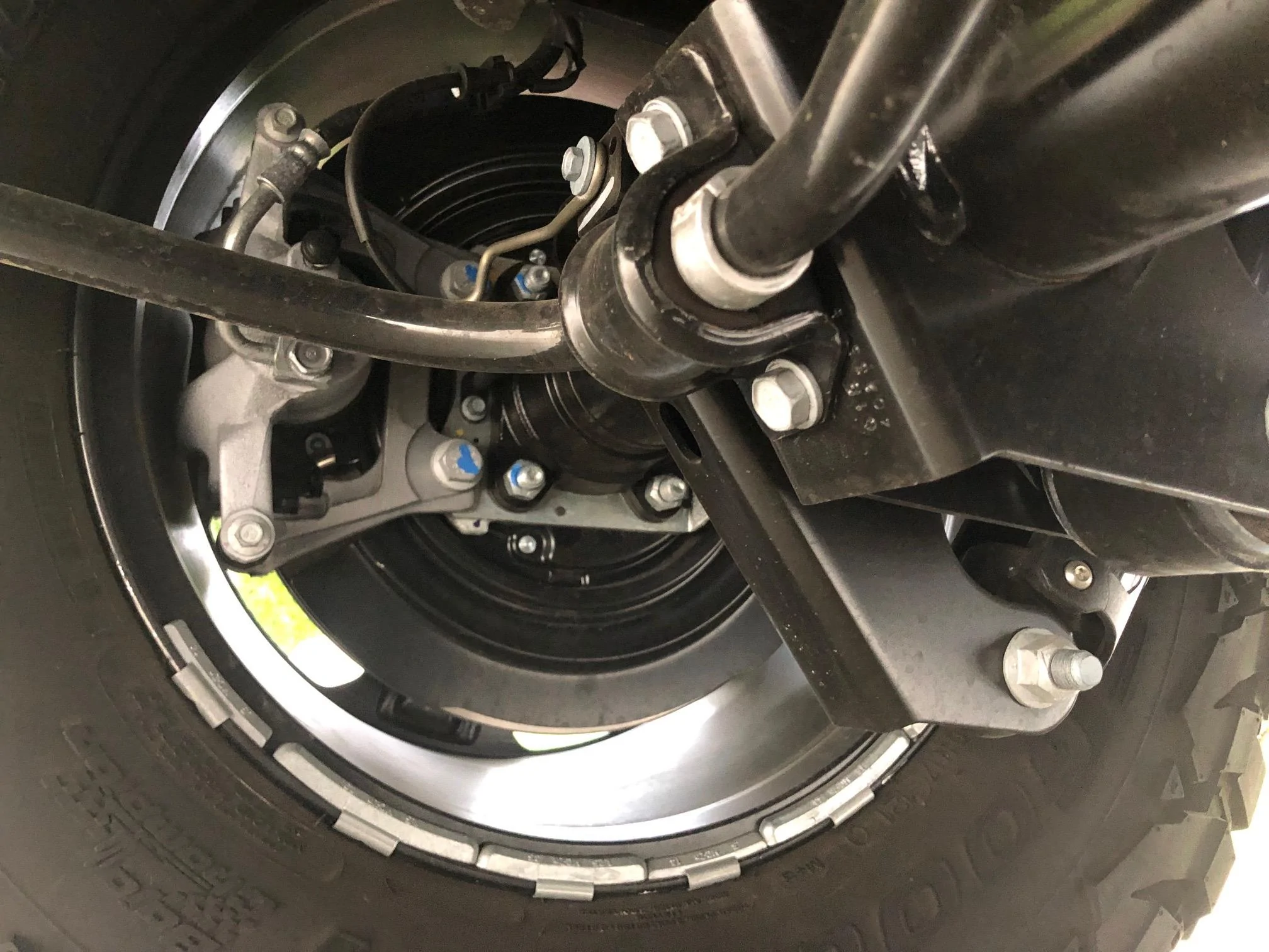

Here we go again, plus an interesting development if the dealer isn’t full of it.
I took my truck in to have the little battery checked because I was getting an error message for the start/stop system. I asked them to take a look at the axle seal as well because it looked like it was leaking again (noticed it about 5 months ago). We were all hopeful that it was residual from the first repair.
It wasn’t, definitely leaking again. However they couldn’t order the part. It took them a day of phone calls but apparently DANA is redesigning the axle. So the dealership told me that once they can order the new part they will fix my leaking axle. Until then they have determined that it’s safe to drive. Which is funny because they had my truck for over 2 months last year since they were worried that it wouldn’t be safe.
Does anyone have any insight on this axle redesign or is it BS?
Others here have gotten the same message - orders are halted, it's in engineering or something but they can no longer order these parts. At least a couple of others have heard the same thing.
Obviously the numbers hit some threshold, they were finding that replacement axles were not doing the trick so they started replacing entire axle/differential assemblies, that wasn't a total fix........
It all still makes me wonder - why not the 2020 model year? Why 2021? What changed?
Have we seen ANY 2022 model year JT with axle leak?
Have we seen ANY 2020 model year NT with axle leak?
If not, why not, what's the difference, and if the above two questions are "no" then why not go back to the 2020 rev or move forward to the 2022 rev?
Or is all of that wrong and there have been 2020 MY leaks, or 2022 MY leaks?
But if not - then I would think the solution was simple - back up a couple of years and use the 2020 revision?

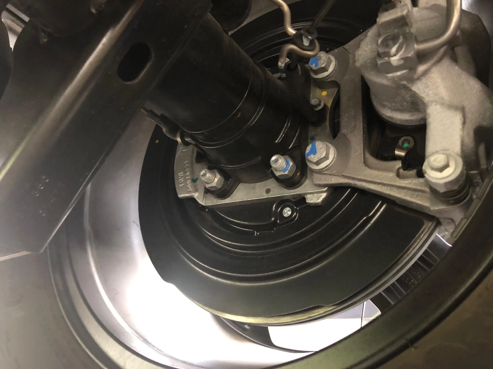

2021 Overland Diesel with 12K and I have the leaking right rear. Was told I had to wait till June for parts availability. Hopefully it will be an improved version.

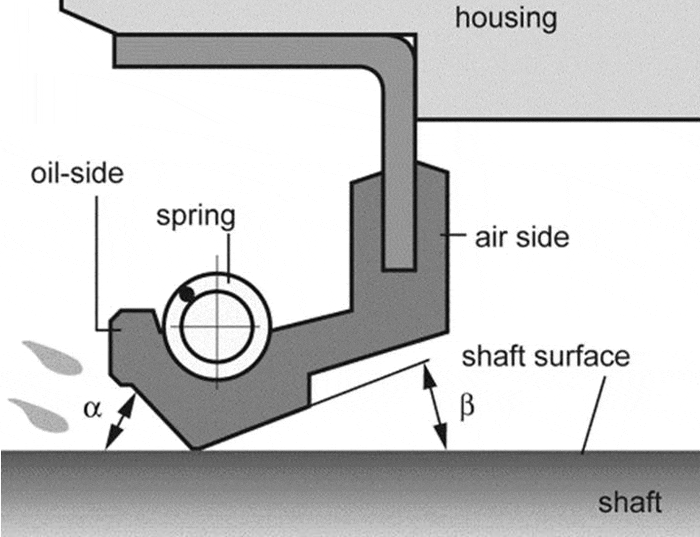

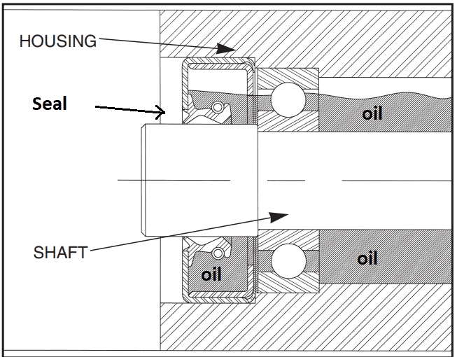

LOL - I see your "logic" but that's not how these work.
Seals seal even if they are sitting fully under oil or lube.
They could be up to half-way under oil, or even fully have the backside covered in oil and it won't matter. They can also typically hold back at least 7 pounds of pressure. In fact, a little pressure holds them tighter against the shaft.
But think of a crankshaft oil seal, or the seal on the vertical shaft engine sitting on a rotary lawn mower - all of that oil is above the seal.
There are plenty of applications where seals like this work partially or fully in oil, submerged, etc.
There's also some out there that are already running a bit low.........
And then you have some roads that have little crown.
