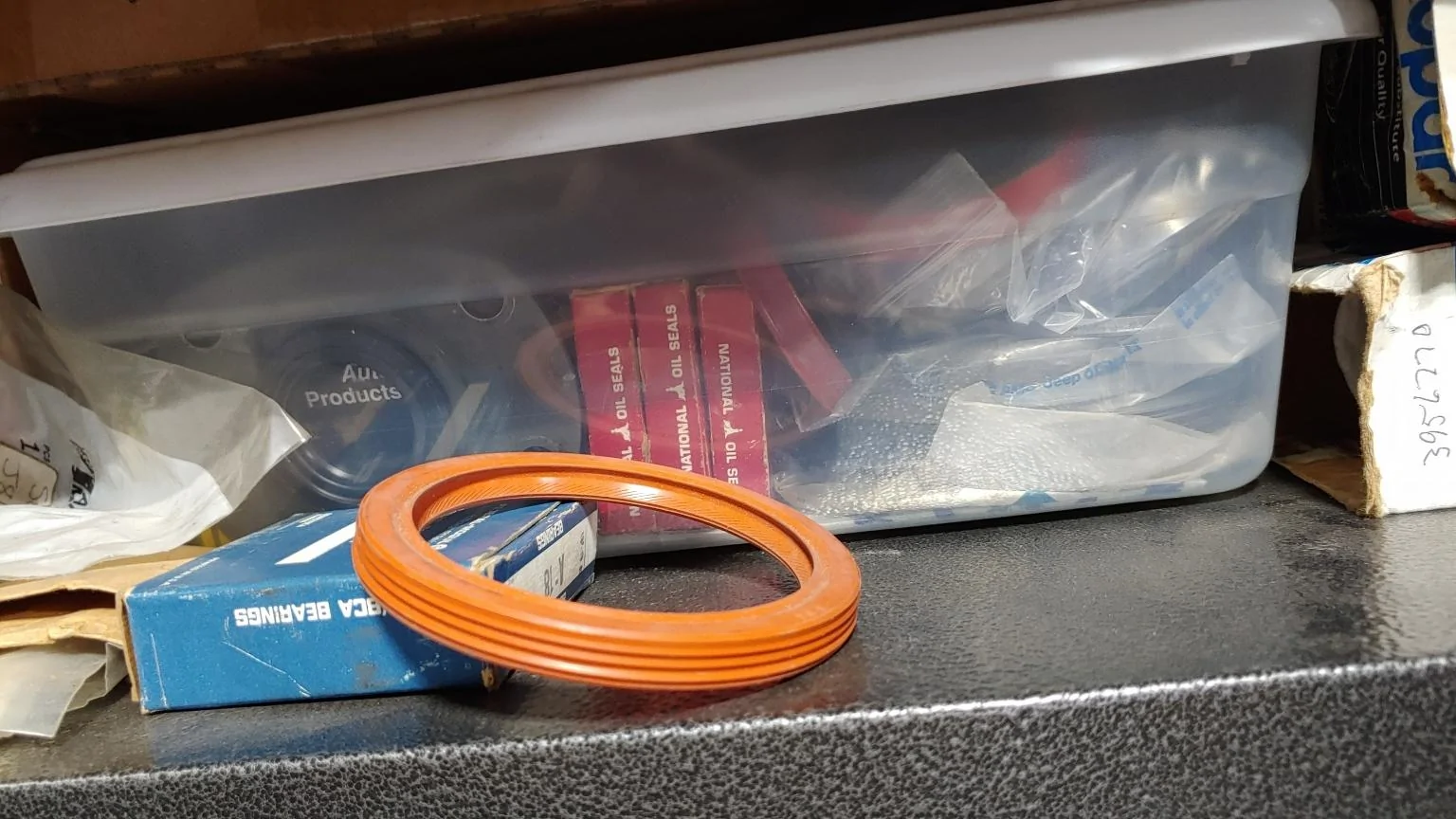

Jeep Gladiator Leaking axle seal? 20220225_145535

LOL - I see your "logic" but that's not how these work.
Seals seal even if they are sitting funny under oil or lube.
They could be up to half-way under oil, or even fully have the backside covered in oil and it won't matter. They can also typically hold back at least 7 pounds of pressure. In fact, a little pressure holds them tighter against the shaft.
But think of a crankshaft oil seal, or the seal on the vertical shaft engine sitting on a rotary lawn mower - all of that oil is above the seal.
There are plenty of applications where seals like this work partially or fully in oil, submerged, etc.
There's also some out there that are already running a bit low.........
And then you have some roads that have little crown.
