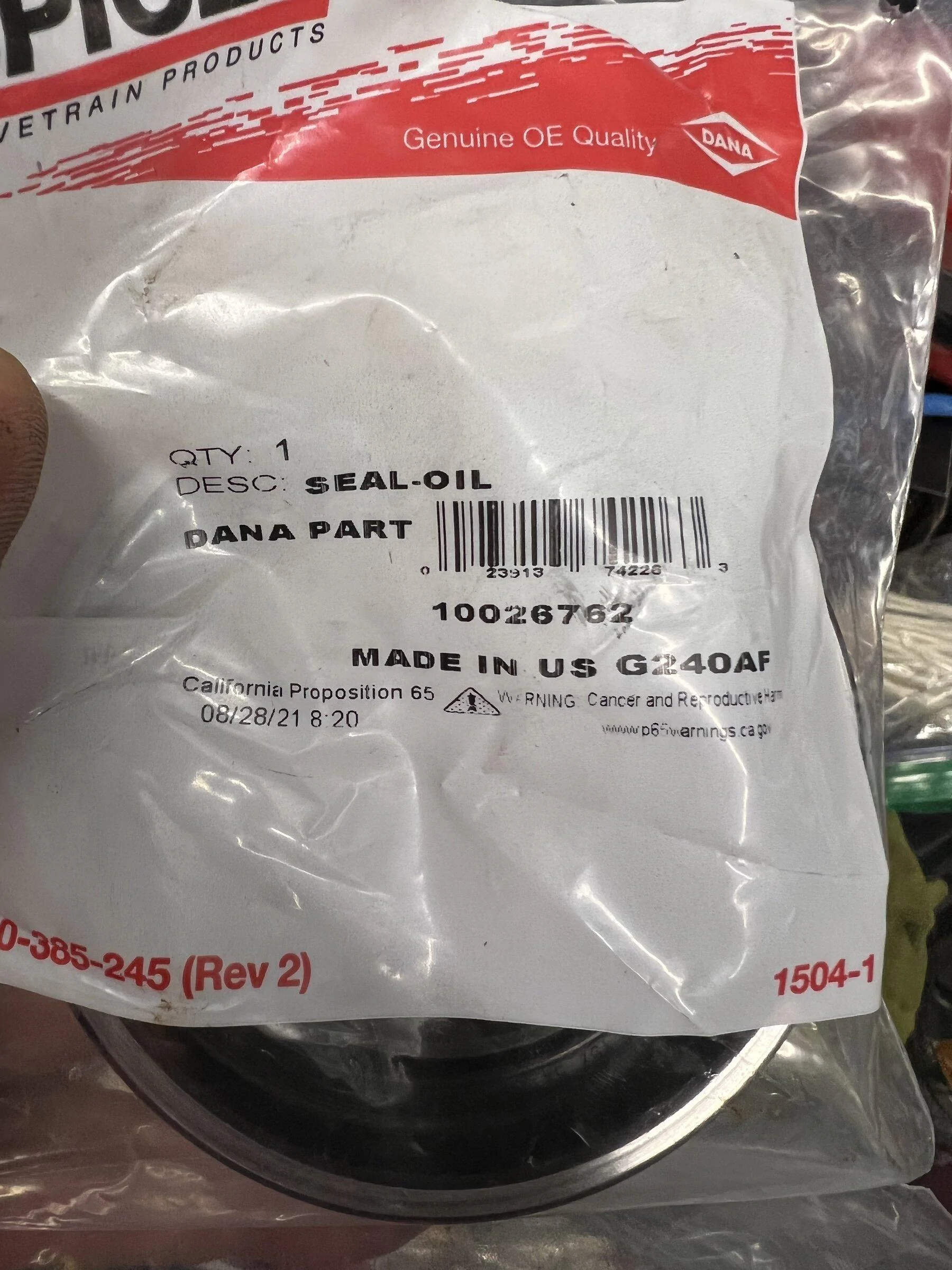

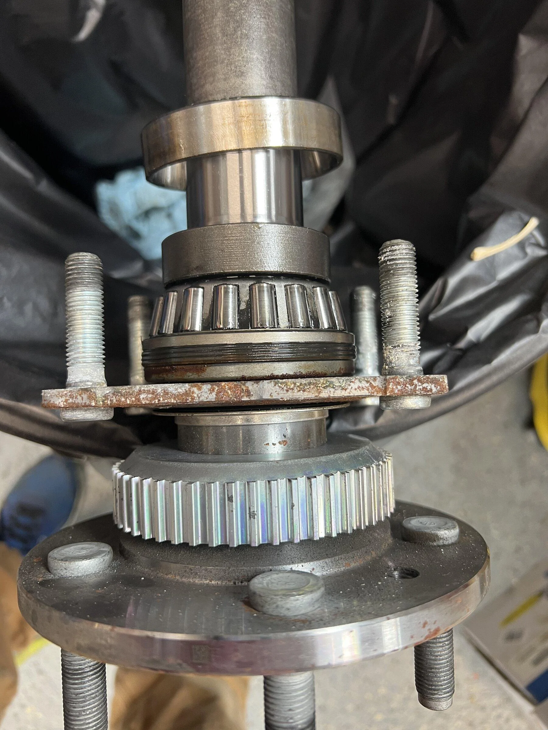

This is the axle pulled out. Grease is used before it is pul together and their will be a bit left in the tube. there will be dark black stuff all over in the housing and tubes.

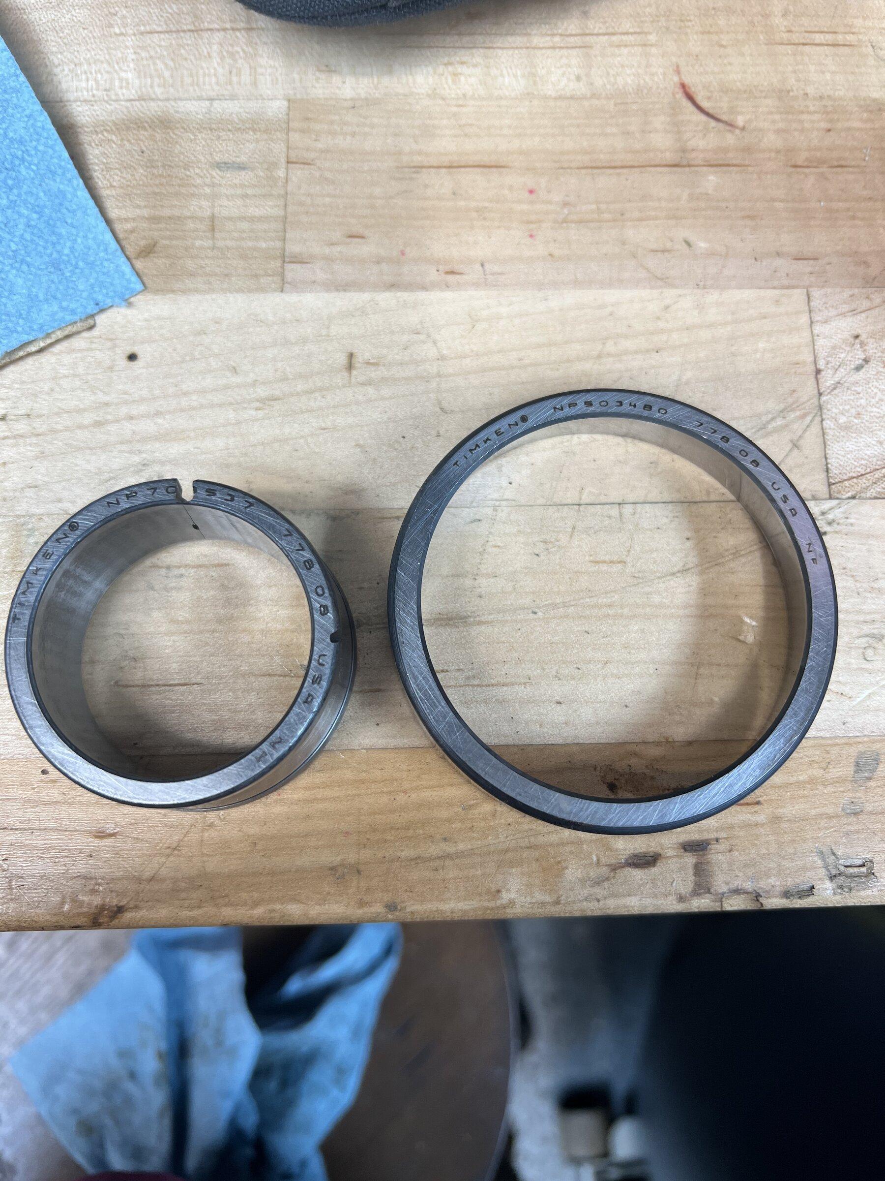

on the narrow axles I have some information on. I was unable to source new bearings but I could find seals. They are like $8 each. Several online vendors list wrangler axles as fitting. They do not, the bearings on a gladiator rear axle use a larger bearing. It measure around 3.15 inches. Timkens catalog is 700 pages long and I didn’t have time in attempt to decode everything
bearings timken Np703537 , race Np503480
seals Dana part 10026762
Parrking brake shoes Z941 or just 941…..mopar uses these on multiple other vehicles
i ended up ordering a replacement axle to get me back on the road. One day I’ll source a bearing and have a trail spare

Yeah, that's pretty much as I've posted or said before - the bearings are pre-lubed, packed if you will, similar to the way car front wheel bearings are. So there will be grease inside - on/in the bearing and in the axle tube, but nothing outside.
The grease the bearings are installed with has nothing to do with any "grease" found on the outside. There will be bits of it in the tube and on the bearing if you disassemble it - pull the axle out of the housing.
The configuration is the same basic configuration used with Dana axles for decades - only the size of the bearings has changed and a slight change in the seal configuration - it has a spacer on the outboard side of the seal that presses against it instead of the retainer itself (the part with the 4 studs) pressing and holding the seal in place.
Look at the ribs on the outside of the seal, it's just like seals of the past.
Bearing retainer ring, bearing, seal, seal spacer/retainer ring, retainer (with 4 studs) and these have a dust shield - thin small steel ring on the washer between retainer and tone ring.
Nothing magical or different or unique or strange about it - other than the fact they leak.

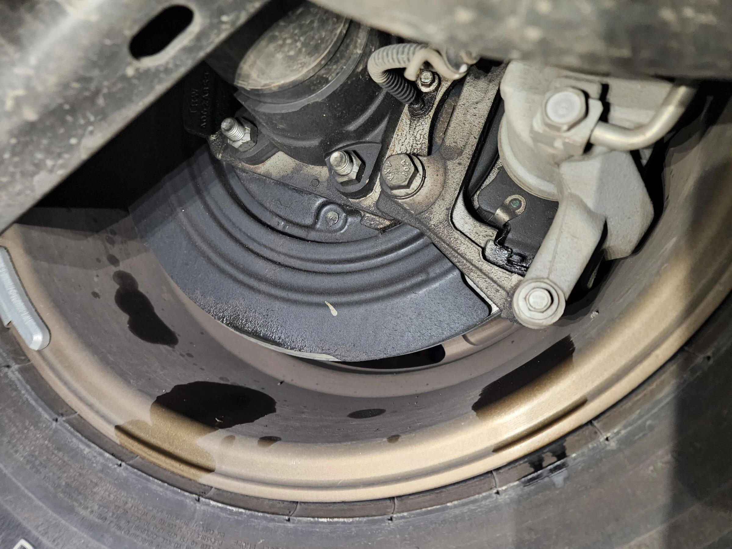

After getting the ESS fixed with a new aux battery I'm looking the truck over because they left the fender liner screws
hanging by a thread. (made another post about that) . And there's a wheel vibration at 70 since they rotated the
tires . I'm glad I did.
Jeep Gladiator Leaking axle seal? 20220418_141822
I remember when I first read about this
issue here months ago I checked things over and all was fine . 3000 miles ,
now 7000 .
Doesn't look like it's been leaking for long or I'm thinking the whole rim would
be coated . Called a different dealer than the one that did the aux battery 2
hours ago and of course got voice-mail.
Waiting for a call back.
My question is, will they let or want me
to drive it till they can fix it ?
Expect a rental if they don't want me to drive it while maybe waiting on parts ?
Wait for an updated fix ?
Looks like I'm doomed to have all the
common issues. Not sure what the next likely problem might be .
I still love this truck .
How does this look compared to others ?

It's not leaking bad enough to not drive it.
Don't expect a rental - Jeep Wave does cover first day rental if one is available.
The updated fix is a must and dealers can't even order parts until the update is out. (like maybe in a week or so? Sounds like the engineered fix is coming soon, we hope. )
