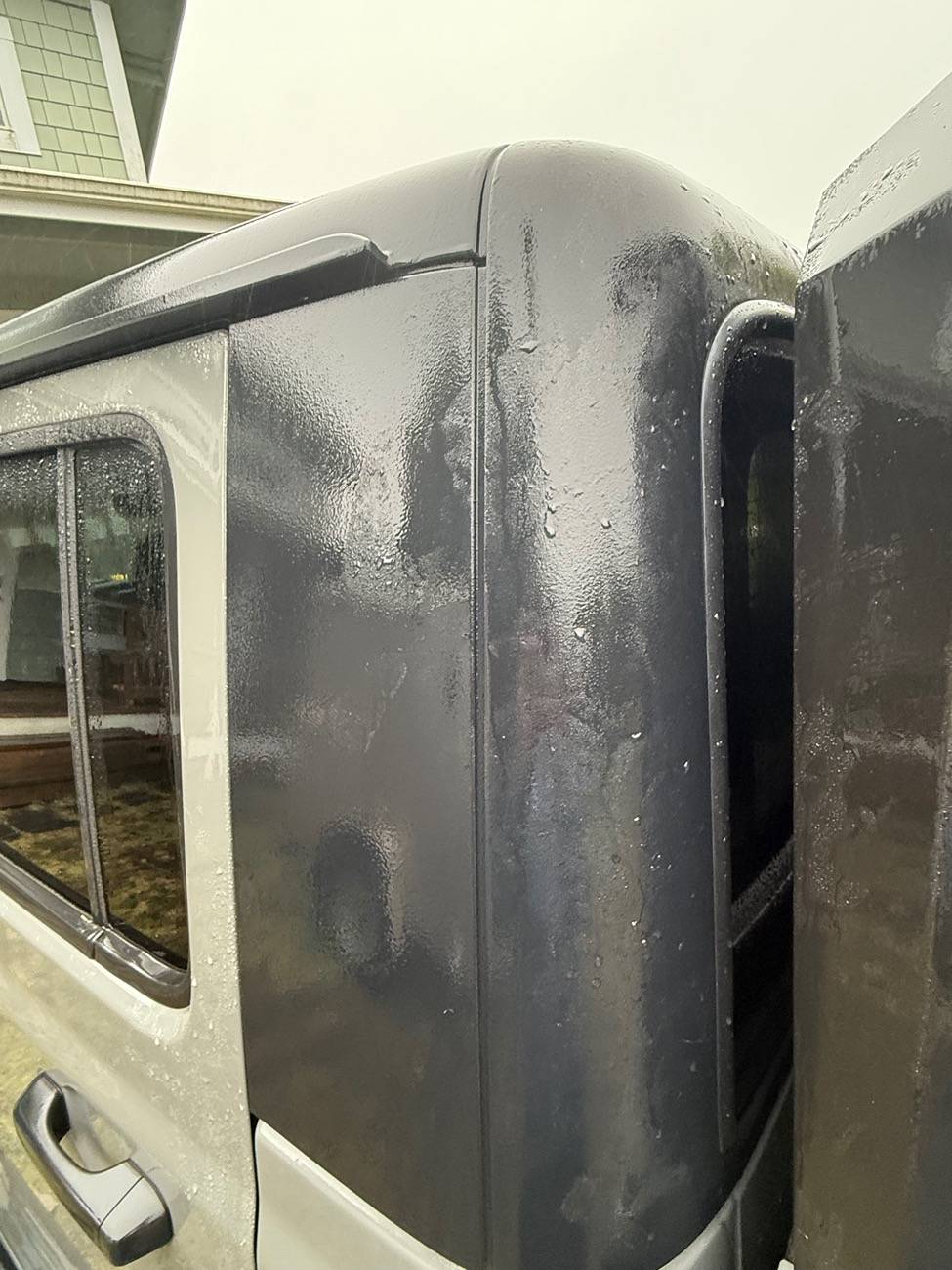

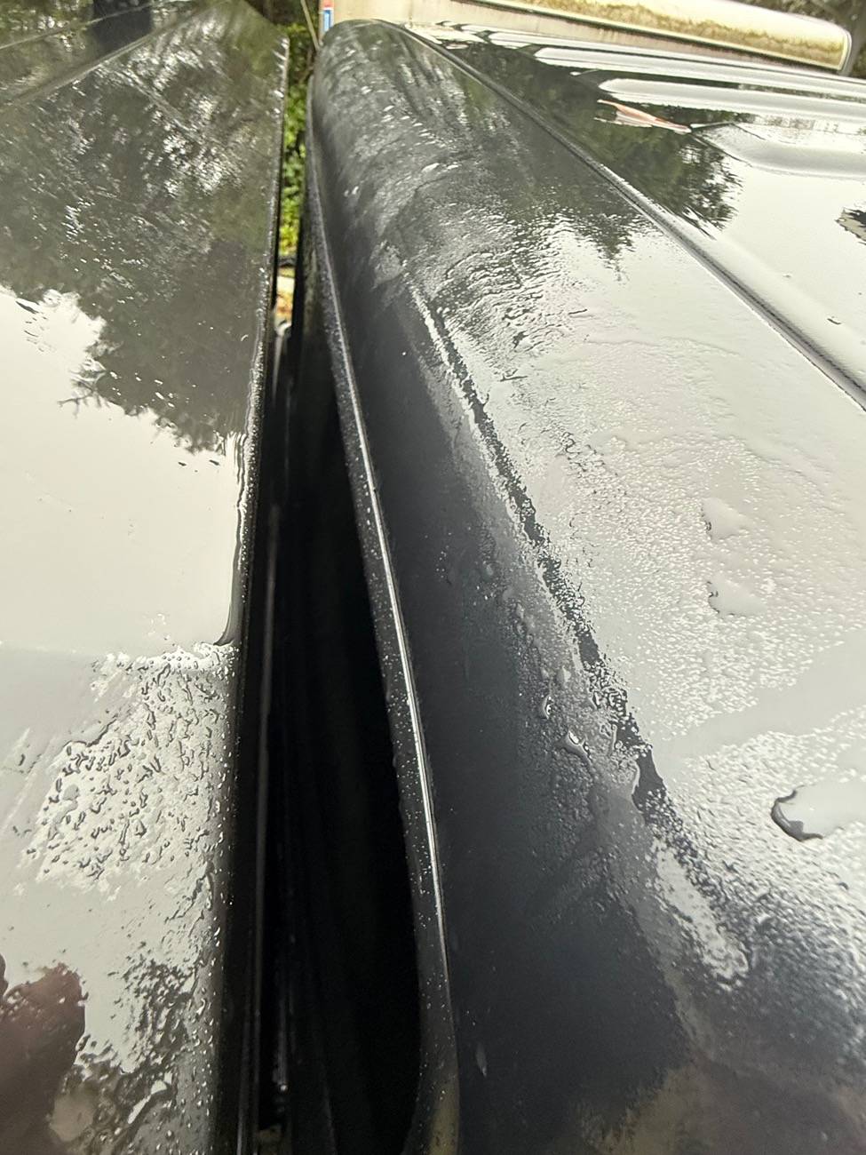

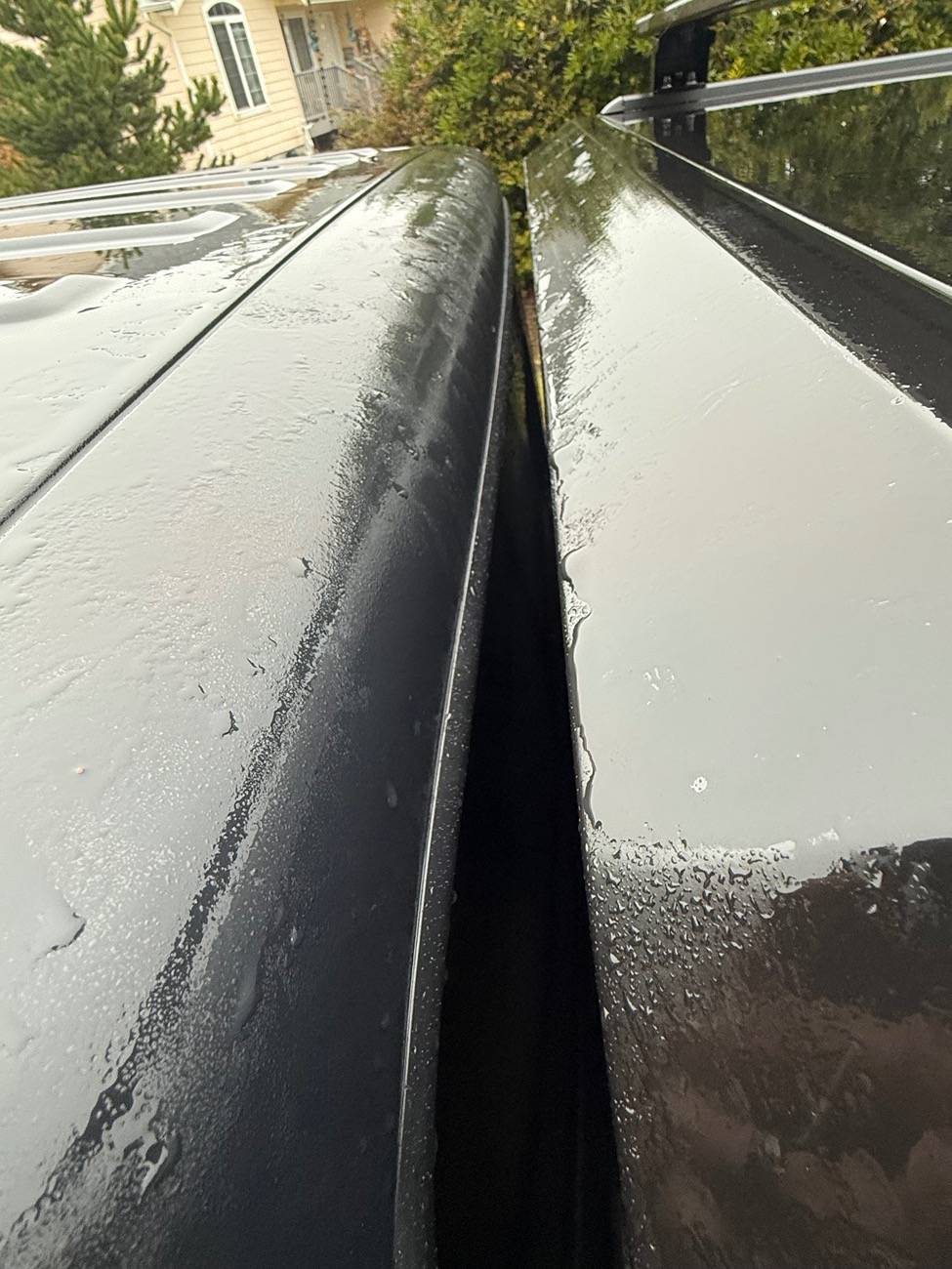

I have had the leak for 2+ yrs and gone to the dealer 3 times for resolution. They had the window replaced, then the leak reappeared within months. It’s just a terrible design. I have tried the Amazon 1/8” vacuum hose fix plus multiple vacuum hose sizes as my top gap was so large the normal fix didn’t resolve like it did for others.
Congrats to those that have resolved with smaller vacuum hoses or other methods, but mine kept leaking. The normal 1/8” vacuum hose didn’t fill the window gap due to a shitty install job on the supposed Window swap fix. After all the time spent, and a dozen times drying my smelly carpet I found the below gasket that seemed to resolve my issue. Hopefully permanently, but not enough time to verify. Hope this helps others where other posted fixes didn’t resolve.

Jeep Gladiator Leaking Back Widow IMG_2831
Jeep Gladiator Leaking Back Widow IMG_2828
Jeep Gladiator Leaking Back Widow IMG_2830
Jeep Gladiator Leaking Back Widow IMG_2829

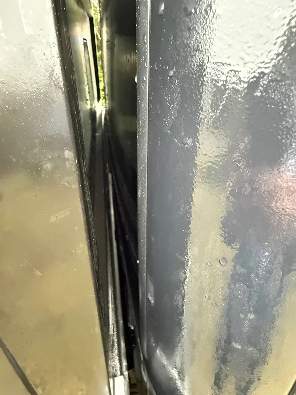

Hard to tell by the pictures, does the gasket fully surround the glass?
Fully surround? In what way? From the below picture the left side nub is what’s contacting the hardtop frame while the right side does fit over the glass thickness. So, it does seat over the glass with the left filling in to the rest of the space Between the glass & the fiberglass top.
Jeep Gladiator Leaking Back Widow 1740278760819-5
