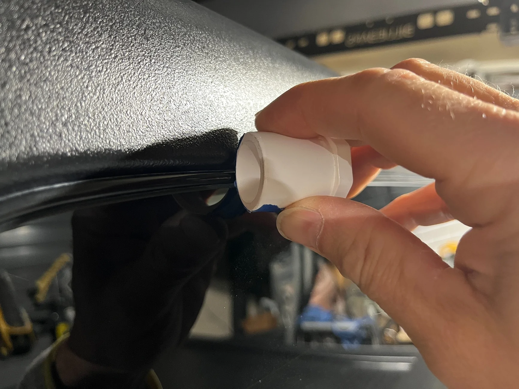

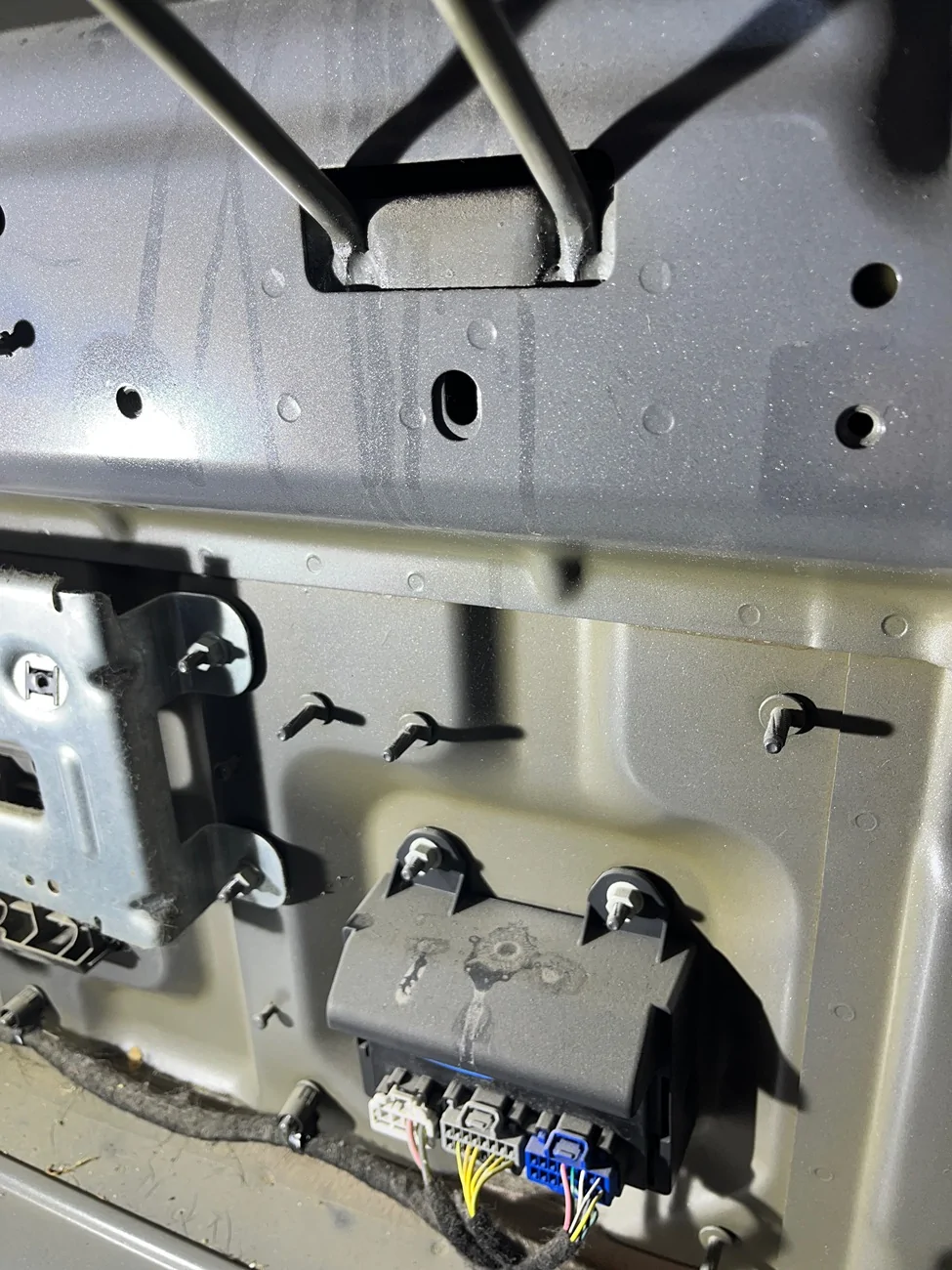

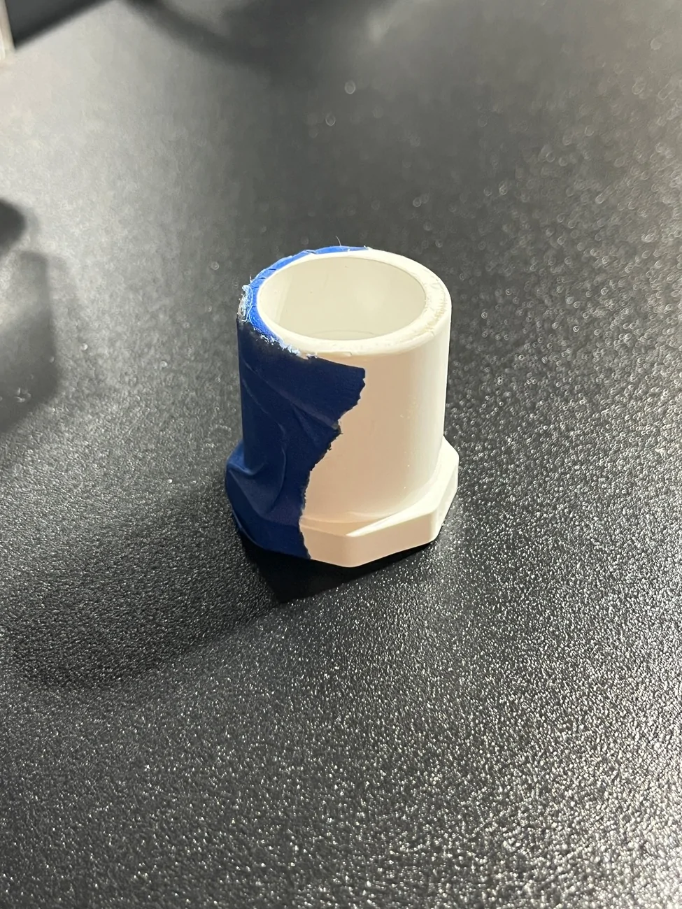

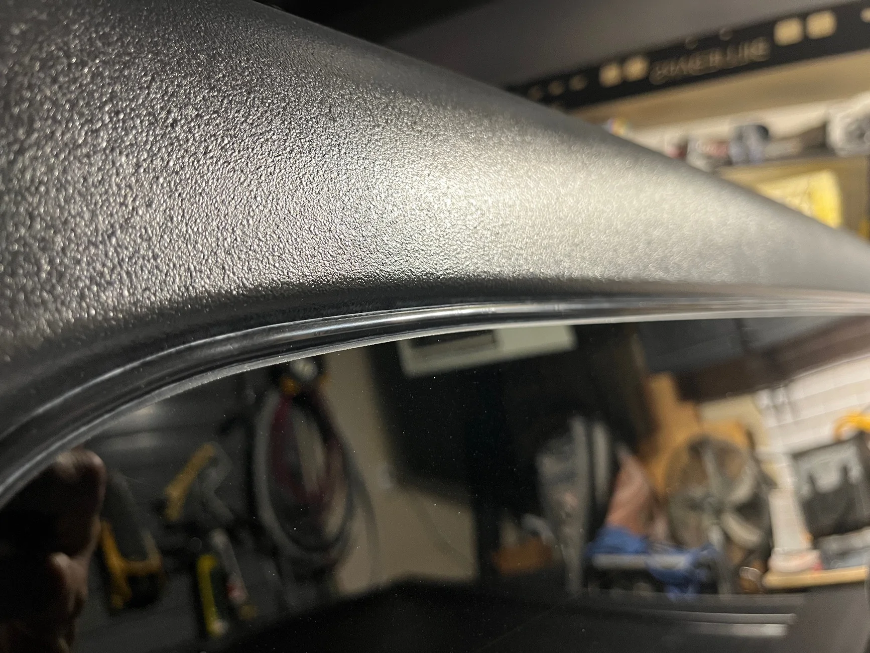

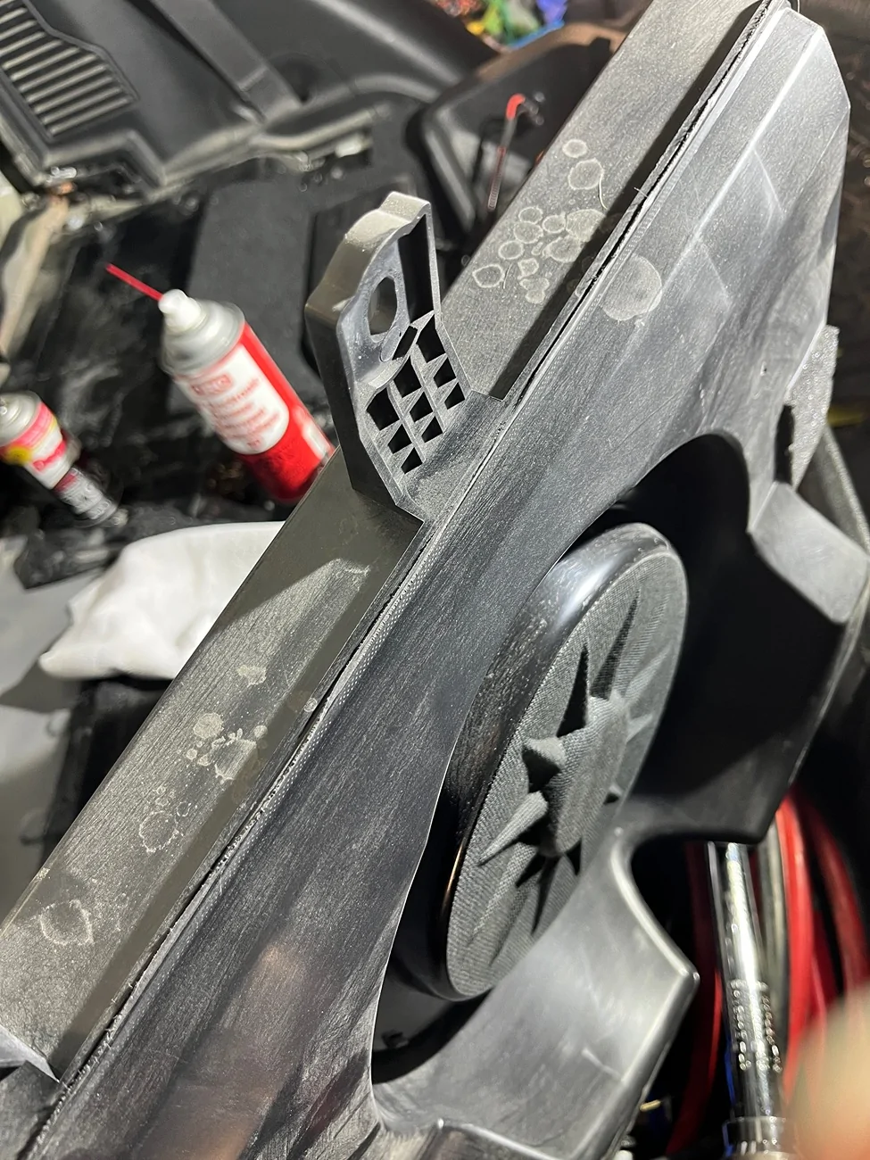

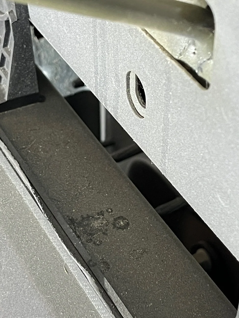

I had the leak back in 21 and I believe it was in 2022 I picked up the 7mm silicone vacuum tubing, a 1” long 1” pvc pipe as my guide press tool, sprayed window cavity out with water and alcohol, wiped it clean and dry, then soaked it down with same solution and slowly set the tubing in place with the tool I made with the pvc pipe. Don’t pull the hose along, set it straight in, keep it hydrated and run the tool along.

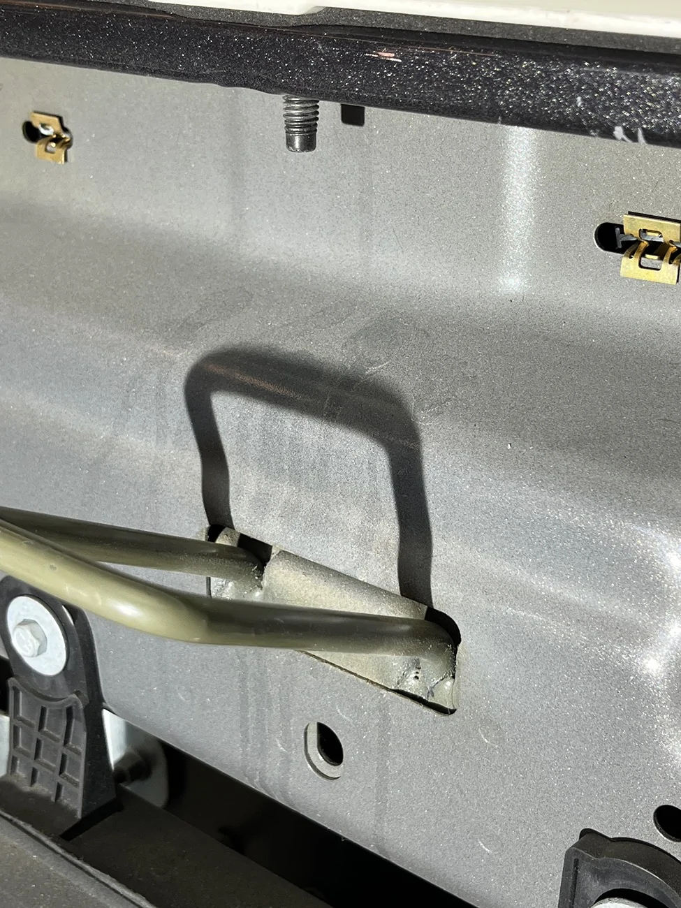

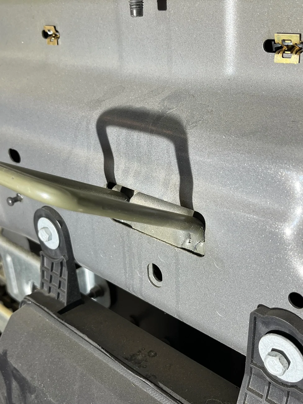

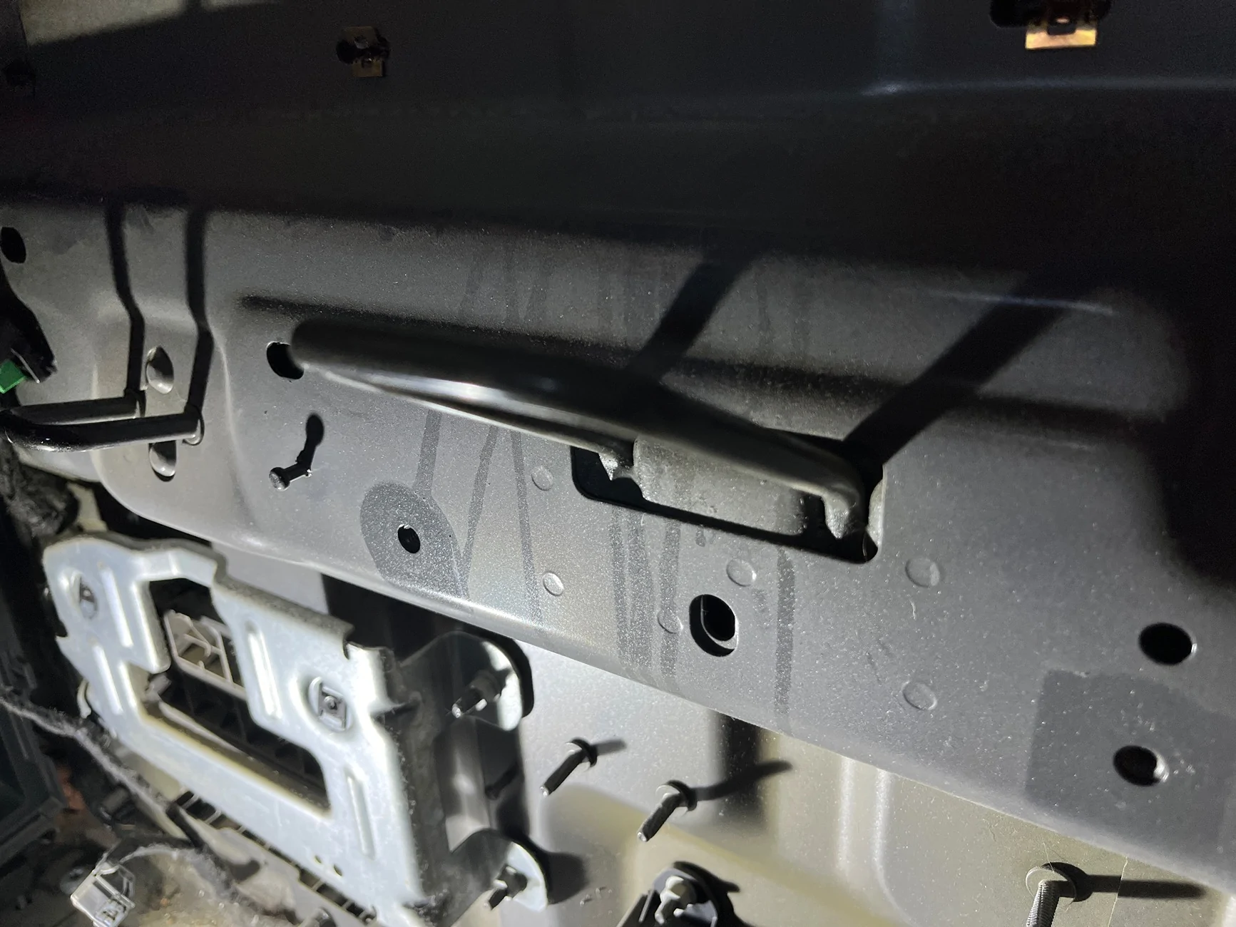

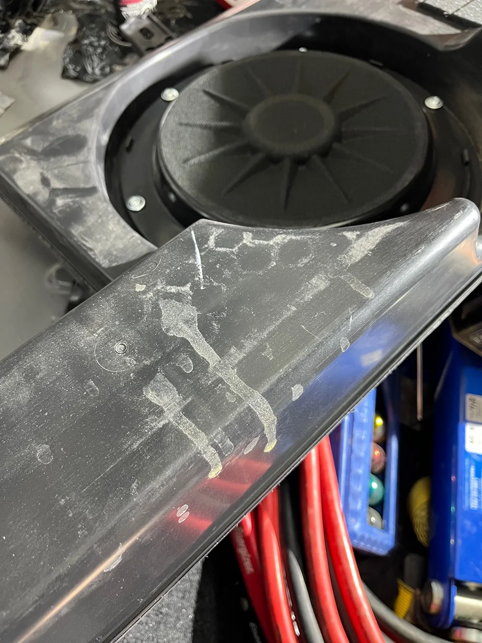

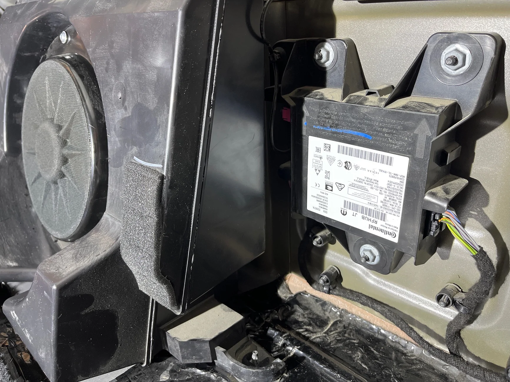

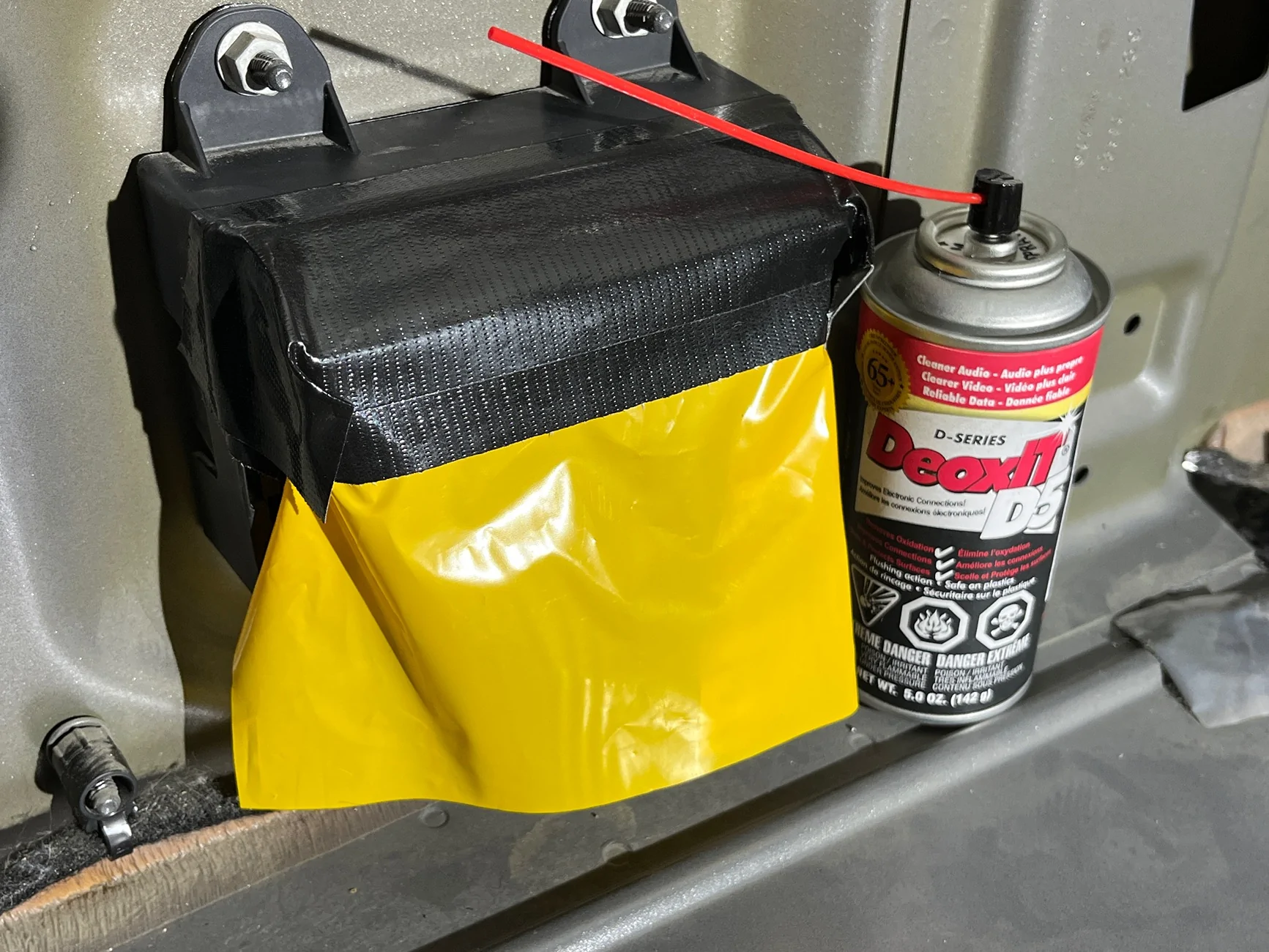

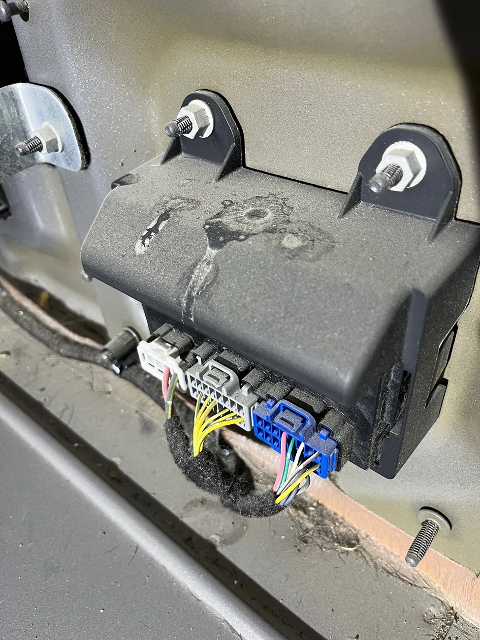

Now then,…the fallout of having this leak… the water drains down behind the back plastic panel where the subwoofer is AND there’s two very critical modules as well that can get wet. One module is the Alpine module that is directly behind the woofer and the second one is your DTCM (drivetrain control module). If this one gets wet, it’ll do things to your truck that’ll leave you stranded and you’ll swear off jeeps for the rest of your life. But hey! Have no fear because knowledge is power and now you have an action plan.
But let’s hope you can deal with the water (that got in and ran down the wall) on to the woofer and modules!
I accidentally found where the water was sitting on my stuff when I took the panel off to inspect my DTCM. Taking the panel off is a B!$ch if you don’t understand what’s got it pined in there and I went all HULK on mine and broke it in a few places but it can be UPGRADED later and it’s all sitting back on the wall, no problem. If I was to do it again, I now know how not the break the top of the panel.
Let the techs take the panel off to inspect for water damage or threat to connectors.
So thats where the RF Hub is located

No sticky side, just set it in place, spray on the water/alcohol solution and rub the tool along it
Seems as though marine grade clear caulking would do just as well.
