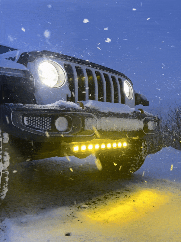

Looks great! Are you happy with the snow performance?
They've been great so far. Already been through a few dense fog mornings, a few thick mist mornings, and numerous intense snowfall drives and I've been pleased. Waiting for one of those heavy wet falls where normal headlights are useless (blinding, actually) to put my final question to rest.
Do recommend.

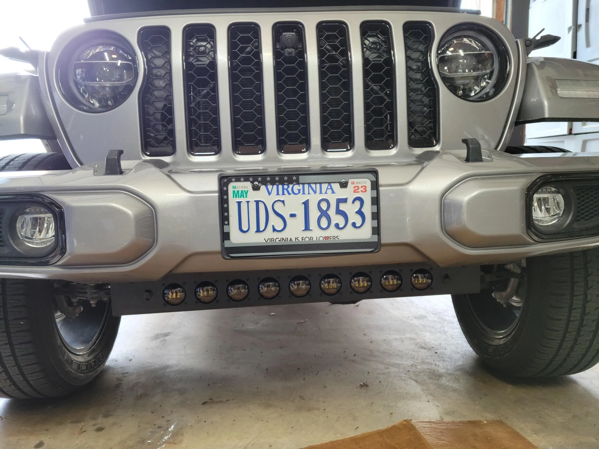

Why does the fuse blow when I bolt the skid plate to my bumper? Lights work fine until then.

Installed mine a couple of weeks ago to the factory switches. Its working great so far.

How do I do that?
Make sure the positive wire is connected to the output from the switch, and the negative wire is connected to the frame. If they are reversed, attaching the light assembly to the frame creates a direct short when the switch is turned on and blows the fuse. If the wiring is correct, check each light in the whole assembly for errors like bare or reversed wires.
