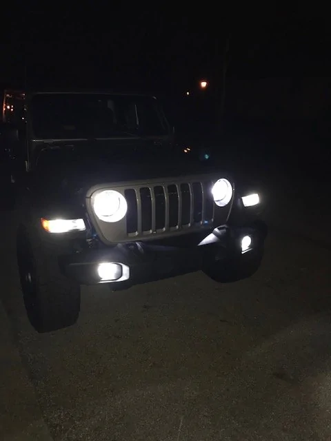

Just installed the headlights and fog led bulbs listed here and wow! What an awesome difference! I had a sport s w halogen bulbs.
Easiest way for the headlight swap is to remove the front grill (6 plastic pop ups and a row of snaps along the bottom) and then 3 bolts per headlight. Much easier and faster than trying to do it from the rear!
I did the fog lights as I was swapping bumpers.
