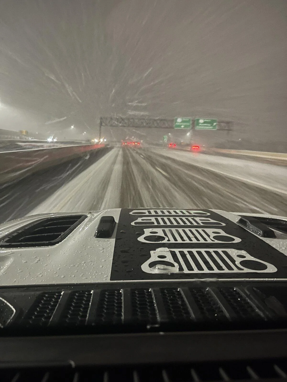

LED Headlight reflective blindness in Heavy snow

This happens with any type of headlight in heavy snow, thick fog, or heavy rain. That's reflection is worse when you run high beams, that's why fog lights usually shut off the high beams when turned on. Also, LED's are a poor choice for wet snow because they aren't hot enough to melt the snow and the lens get's covered up. Some LED headlights include heaters to prevent this.
You probably noticed the reflection more with the LED because they are brighter than most other halogen and standard headlights.
Also have a KIA Telluride with LED’s and have not experienced anything like what I experienced in the Gladiator in similar conditions. One of the jets I fly has LED landing lights and at 200 kts and much heavier snow with no blinding reflection. Must just be the design of where the lights are located that attribute to the issue in this platform. I was mainly interested in knowing others experiencing same issue and to see if any corrective actions helped with reducing the reflection.

Driven a ton in the snow and don’t recall ever having any issues….only time I had an issue was once when I drove a hundred miles through the mountains at night and couldn’t see well when my lights normally illuminate everything… turned out I only had the DRL’s on the whole time ?
DRL’s were the only way I could see anything in that snow.

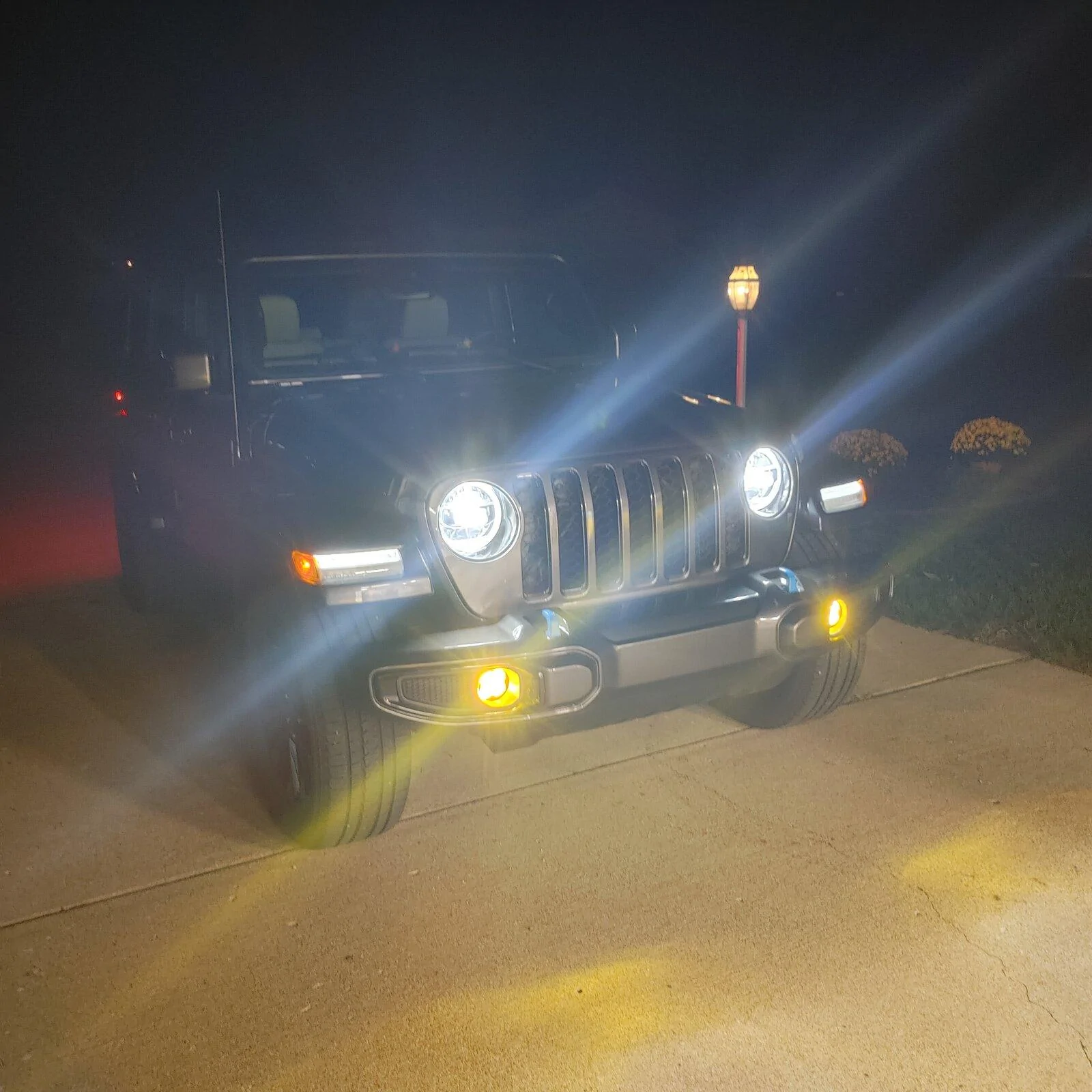

My buddy who had a similar issues got an amber light bar and angels his lights a degree or two below spec for winter.
40,445
53,879
Diode Dynamics SS3 factory fit ambers will fix it right up. My wife requested them after she drove my jeep, with them.

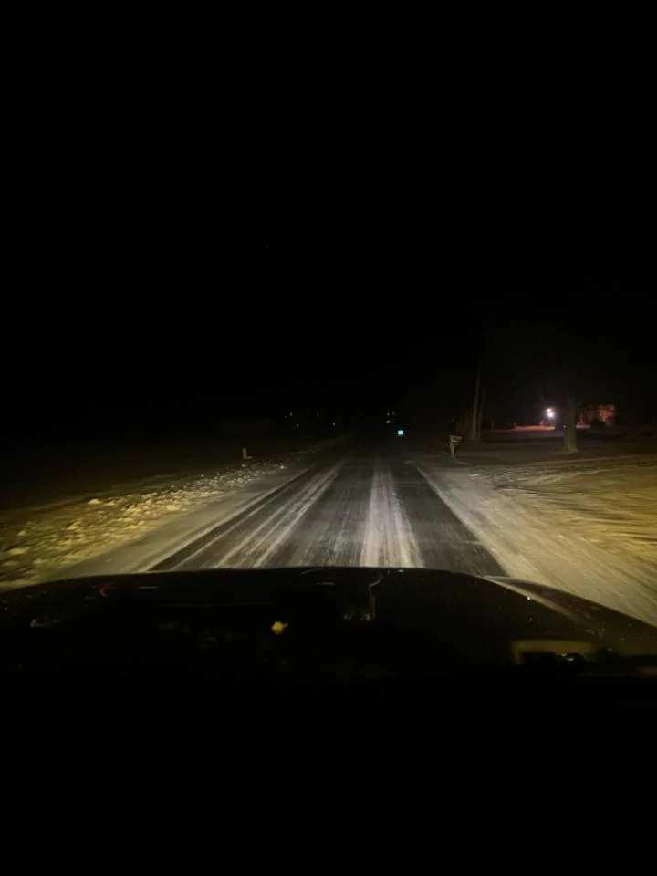

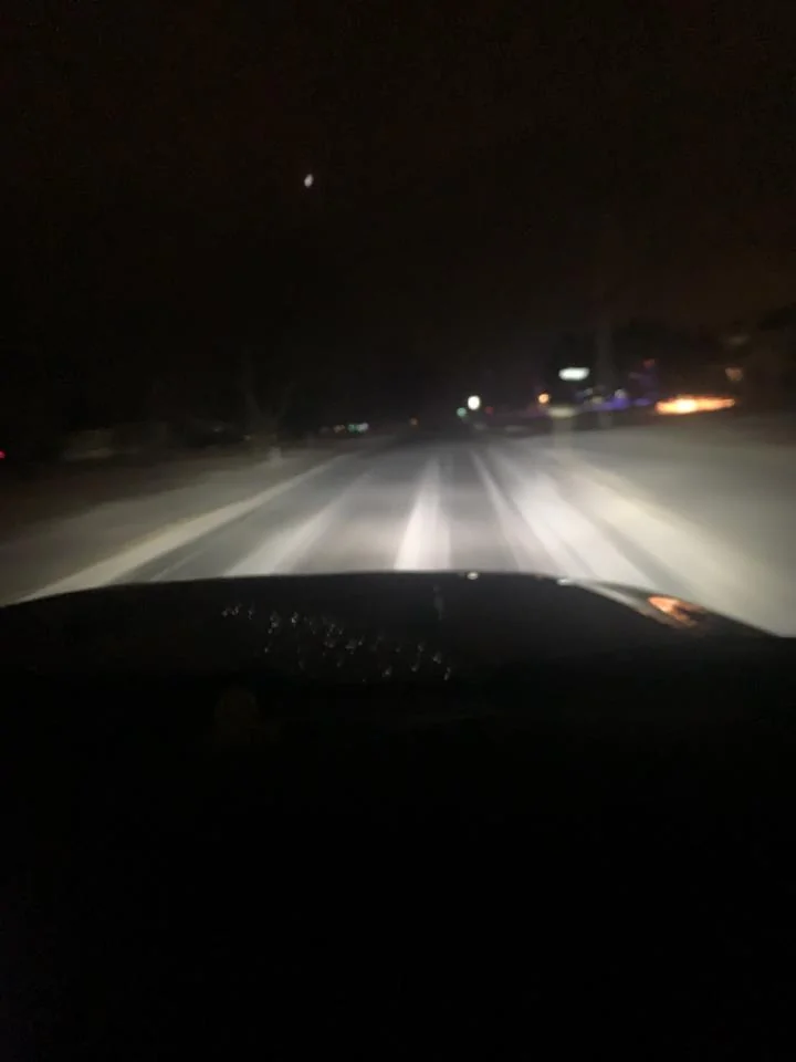

Here is a with and without. While I enjoy a good read, real life experience has given me a strong preference to have these fog lights, as I can drive at night with minmal strain. Diode Dynamics says these light are DOT.

Here is a with and without. While I enjoy a good read, real life experience has goven me a strong preference to have these fog lights as I can drive at night with minmal strain. Diode Dynamics says these light are DOT.

If I recall they have three versions - last year I was considering their better level in yellow, may still as factory fogs aren't great.
Which version do you have? Sport/Pro/Max?

That picture isn't bad at all. In fact it looks like our last several vehicles, including my Silverado, etc.
IF things always looked that good in winter I'd be happy.

Nothing will penetrate heavy snow and yes you will get more reflection off of it with brighter lights. Just like throwing high beams on in the fog make it worse for vision. There is a small reflection off the hood from the A pillar lights, but I have them aimed more to the ditches.
Heavy snow or fog I just go low beam LED and amber bumper lights.
I’m used to driving in the blinding snow, just like today was. I drive a plow/sander truck in the winter on highways. Just drive slower and don’t over run your light beam.?
Well on your aircraft they are usually nose gear or inboard of the wing correct? Location makes a difference for sure. As mentioned maybe dial the OEM’s down a bit, they may be set too high. Any Mods done?
Tires, lift?
Maybe try driving on instruments, you know adaptive cruise control.?
Tires, lift?
Yes 2” on 37’s. Set at measured headlight height from 25’. Will dial down a bit more and see if that helps. Thx
