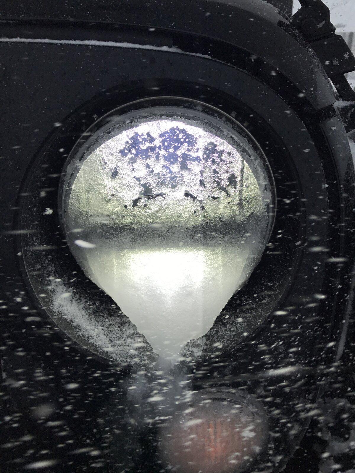

I don't remember what brand these were, but I'm pretty sure JW Speaker. Ice happens. This was on a JK, but depending on where you travel/live ice will happen.
Jeep Gladiator LED Headlight reflective blindness in Heavy snow Icy J
