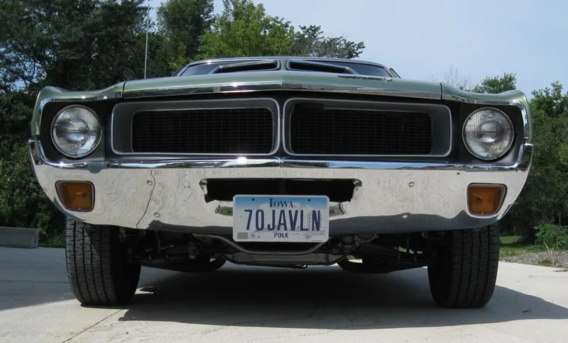

It's not the shape - it's the cold. My Javelin headlights sit back in the bezels, my first car had recessed lights, I've had other vehicles where the light was in almost a cup. Not as big a problem, the heat melted ice most of the time. I could see snow build-up being worse because of the shape but then my other vehicles with lights shaped in recesses like that didn't build up this bad.

Tell me these round headlights don't sit back in a hole - they never built up ice or snow to the extent LED does -

Those are definitely sit back, but appear to have a lot smaller of a flat ledge for snow to sit and build up on.
Definitely seems that ice and/or heavy wet snow are the main problems. Ice on the lenses itself, and snow on the recess ledge.
