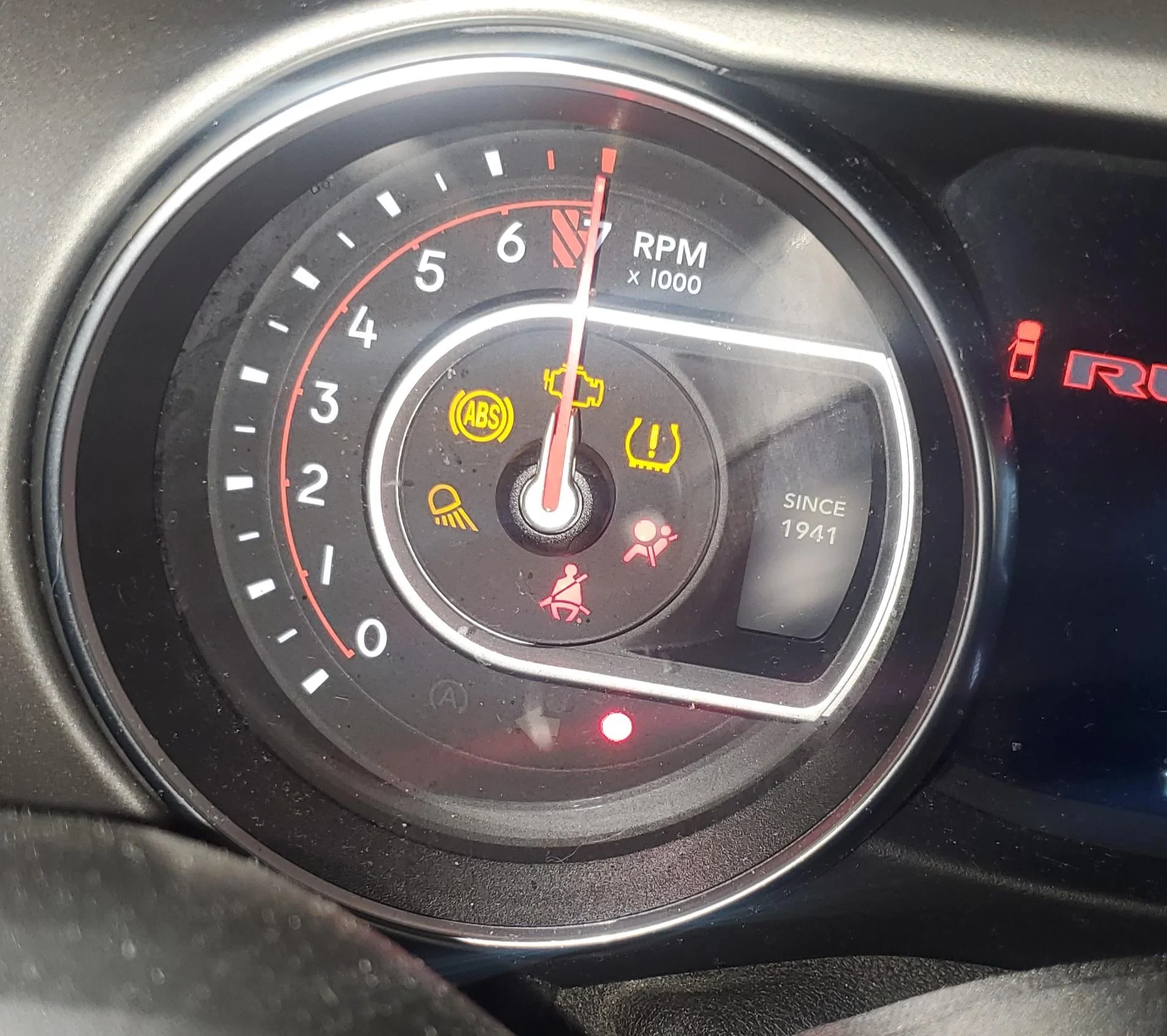

Very strange. Does the truck have an ABS Light??
NachoRuby
Chad
Apr 28, 2021
2,992
4,428
Pennsylvania
You wrote:
My question is why did you get a "check engine" light? I get not getting the ABS light, but the check engine?
That was my thought. But when I got the CEL (not an ABS light) I scanned the truck and the only DTC there was was U0415-00, which is an ABS sensor problem.
When I cleared the code, the light went out.
There is an abs light. It's below and between 4k and 5k on the tach. It should light up every time you turn on the jeep. As to why your situation didn't cause an abs light, no clue. But there is one.
