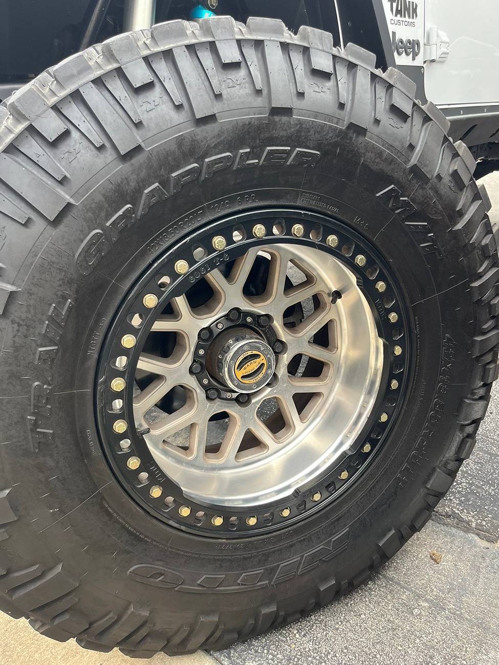

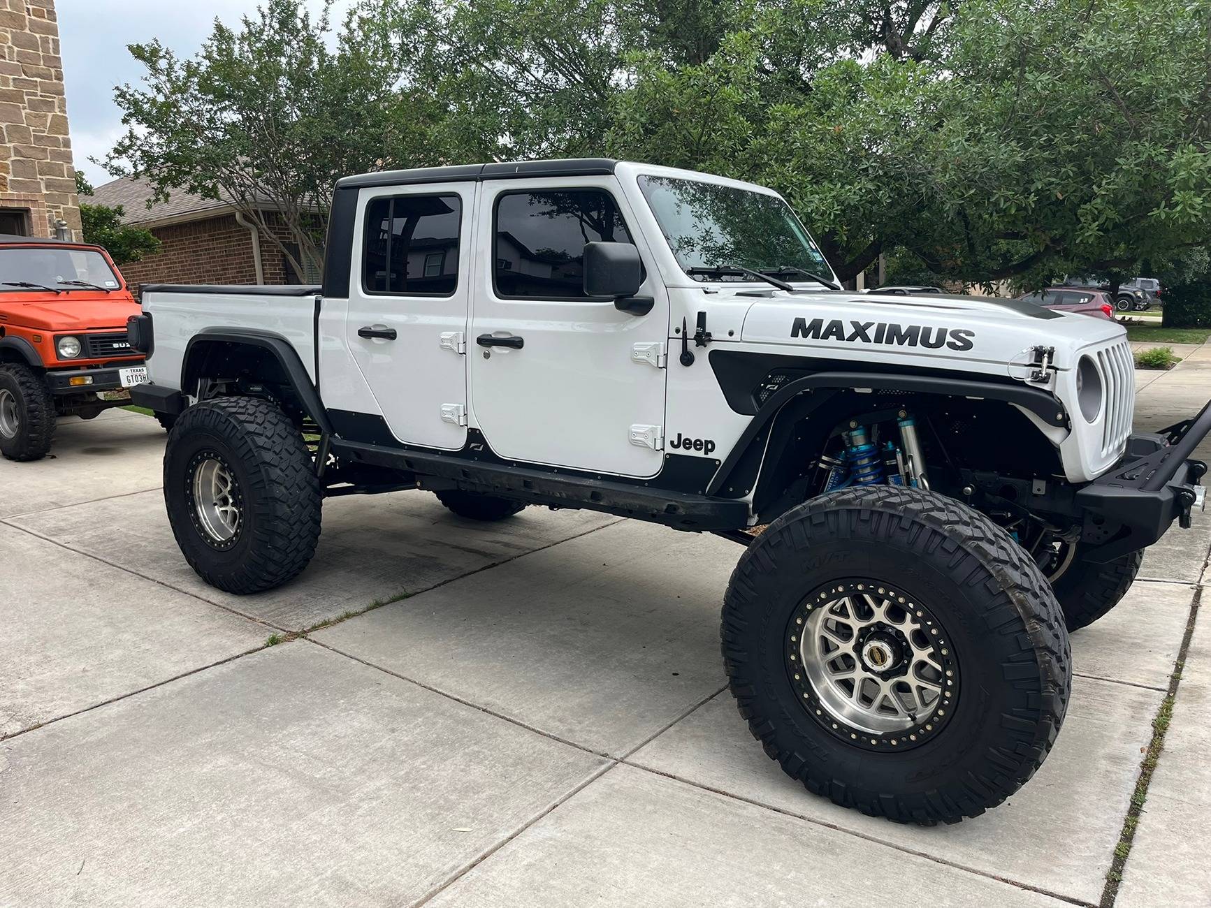

So i am looking at the kmc grenade beadlock wheels. I like them and want them but am a bit concerned about the beadlock part for use as a mostly pavement vehicle. Does anybody have any personal experience with these wheels good or bad to help me out with making my choice ? I already know there not DOT approved.
I am running a set of 42x13.5 on 20inch KMC Grenades and so far have no issues. I just completed a 3K mile road trip on them with no issues.
Thanks for the input . we just ordered mine today. Do they have any kind of coating on them to stop from oxidizing ?
I can't say for sure but I don't think mine have any oxidation on them. I bought my Gladiator used with them already on them and as far as I know from the build sheet the wheels and tires are almost 2 years old in that pic and I've only had it about 5 months now. I would get you a current pic but it is at the dealership currently. I can post a current pic once I get it back if you want.
