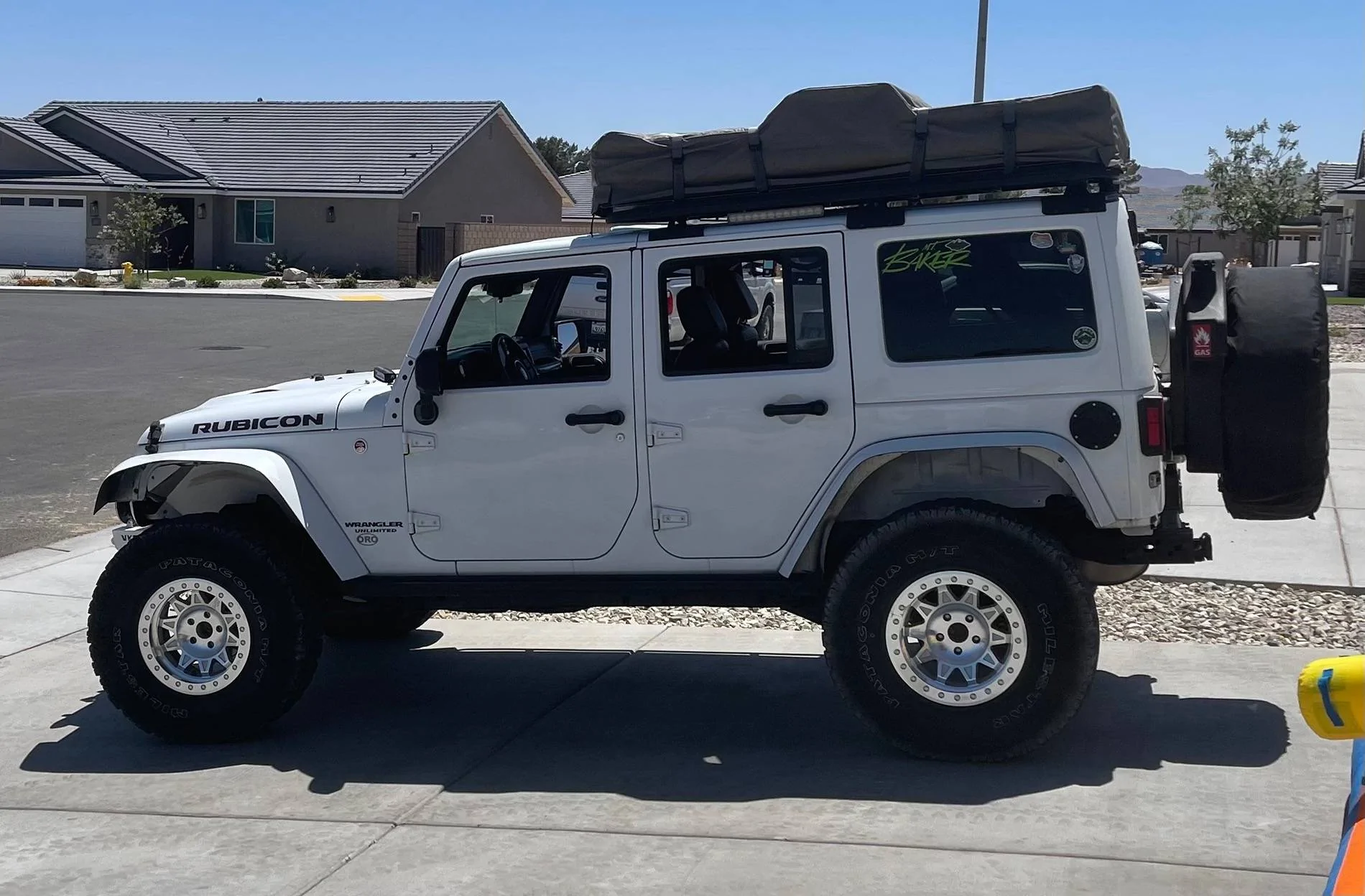

Not on my Gladiator, but I have been running Raceline Rock Monster beadlocks on the TJ for years here in Colorado, including long drives to Moab and Hurricane, Utah with no issues.

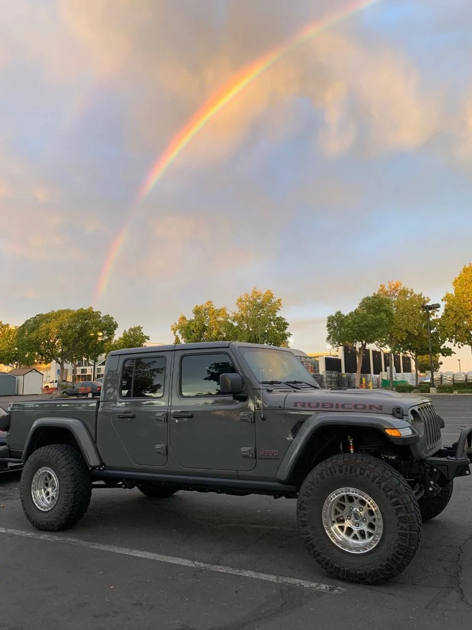

I will say…. We run “bead grip” wheels on our two newest jeeps and are happy with the performance…. The beadlocks obviously have a place on the JK when the top is off and it’s on the rocks…. But otherwise we are much happier running the 25# bead grips on the daily on our newer jeeps. Have ran them in the snow @4psi for sure being mindful of turning…. But have not de-beaded yet.
MY $0.02…. Unless you Reallly need the beadlocks- just not worth the fuel economy hit, ball joint wear, or lift when you need to change them out. 37’s with dirty life’s come in @ 137# rech and Patagonia’s run “light”.
