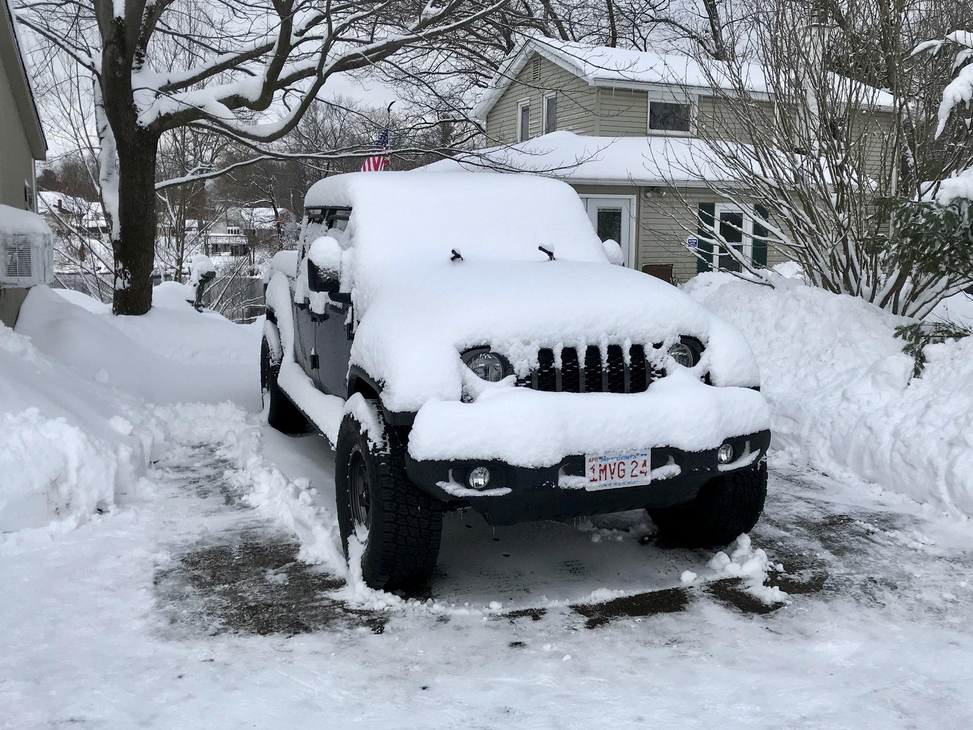

Snow and go... my first winter white ride! It sure was fun! I love the way the snow piled up on the tires beyond the fender flairs!
Jeep Gladiator Let's talk about winter issues EDACD554-3A1C-4064-94C9-4BCA99587926
249
40,525
54,135
My wife would be envious - she wants SNOW now.
And I'd rather drive in that deep stuff than what we had.
She kept saying how disappointed she was, she didn't want it to stop.
