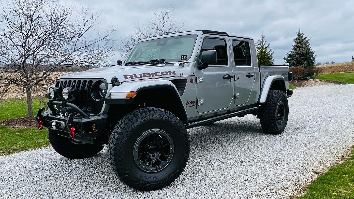

Making the switch from a mix of a Clayton and Rock Krawler lift to an all Rock Krawler setup and I have a question for anyone running the 3 inch springs. Did your level it and how much spacer did it take to level? I am currently running the 1” spacer from the Teraflex kit with the Clayton 2.5” springs but not sure if I need to go with the 1” or the 1/2” spacer with the RK 3” springs to level it out. Let me know, thanks!

If you have a winch on the front you will need the 1-1/2" spacers. That is what I have 3" Rock Krawler and 1-1/2" Terra Flex spacers.

Thanks, just seems like a lot of spacer for the lift but whatever it needs. I don’t mind a little rake, I may go the 1” route and leave 1/2 to 1/4 of rake in there. I do also have a winch but my steel bumper is pretty light for a steel bumper (Rugged Ridge Arcus).

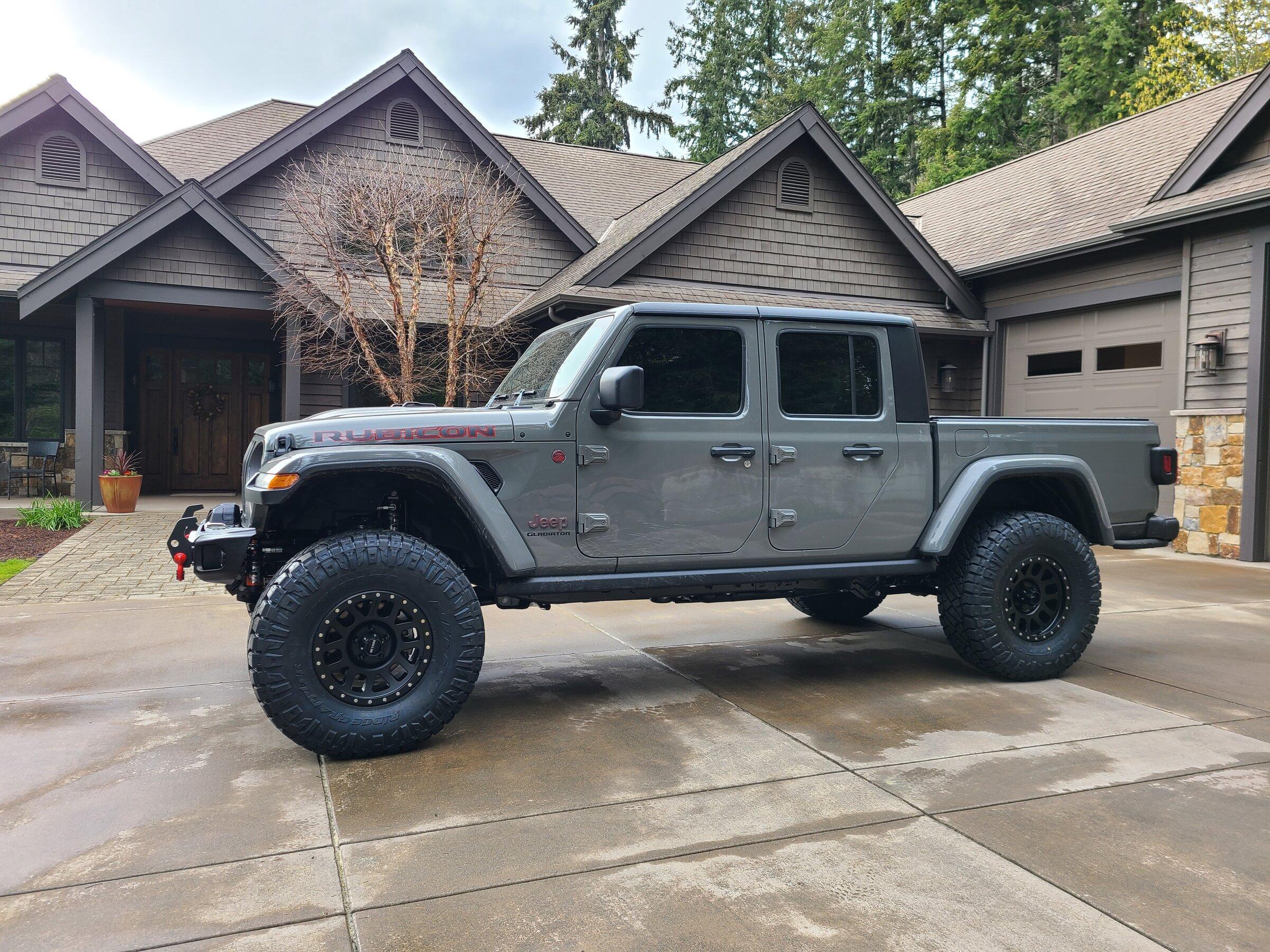

Installing a 3 inch RK X-factor on my diesel Saturday. Thinking of either 1/2 or 1 inch spacer. I want to leave a touch of rake. Lighter Arcus bumper and Warn 12s.
Did you guys get any photos you could share?

Just saw this post, this is a Rock Krawler 3” with 1/2 inch spacer in the front with Arcus bumper, a 10k Smittybilt winch on it, and 37s.
Jeep Gladiator Leveling a Rock Krawler 3 Inch Lift? 254191EC-733B-414C-9DB0-3D2DD6CDE630

Appreciate it, I ended up going with a 1 inch Terraflex on the front with Arcus and 12k Warn and a full size spare underneath. Measuring the rock sliders, I still have just a touch of rake. If I did it again I'd install a 1/2. I bought both but did the 1 inch last second. With the front fender being taller than the rear you do get the feeling it is high in the front, even though it is not.
Jeep Gladiator Leveling a Rock Krawler 3 Inch Lift? 20220421_155650
