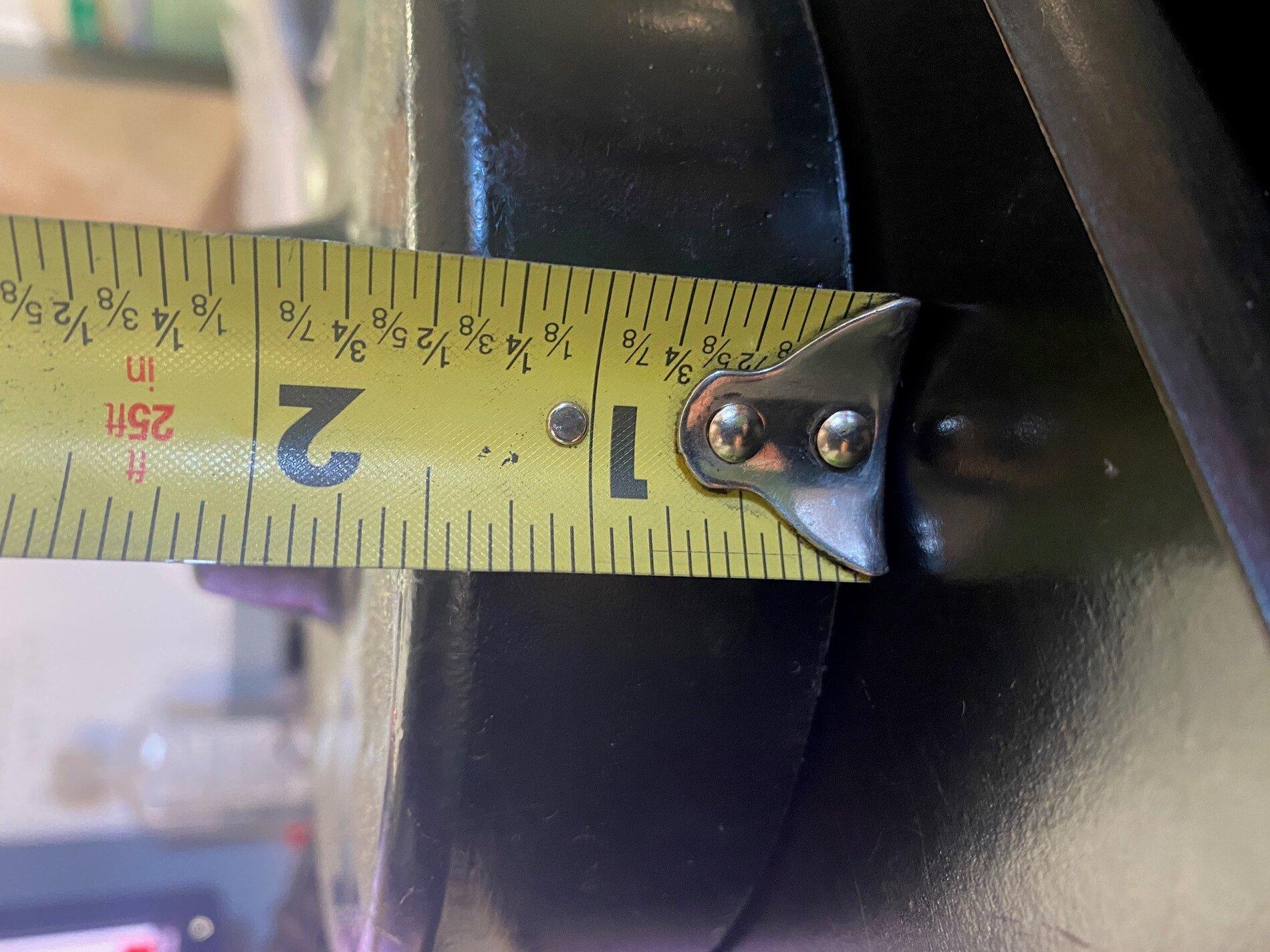

When I contacted RK and asked about this 1.5" BB i was told the rear spacer is 1" tall . Post #4 stated 1.5" all around. Anybody know the thickness of the rear spacer . TY
The rear spacer is absolutely 1.5". This picture was just taken, on my messy desk, in the last 5 minutes. I apologize that someone misspoke.

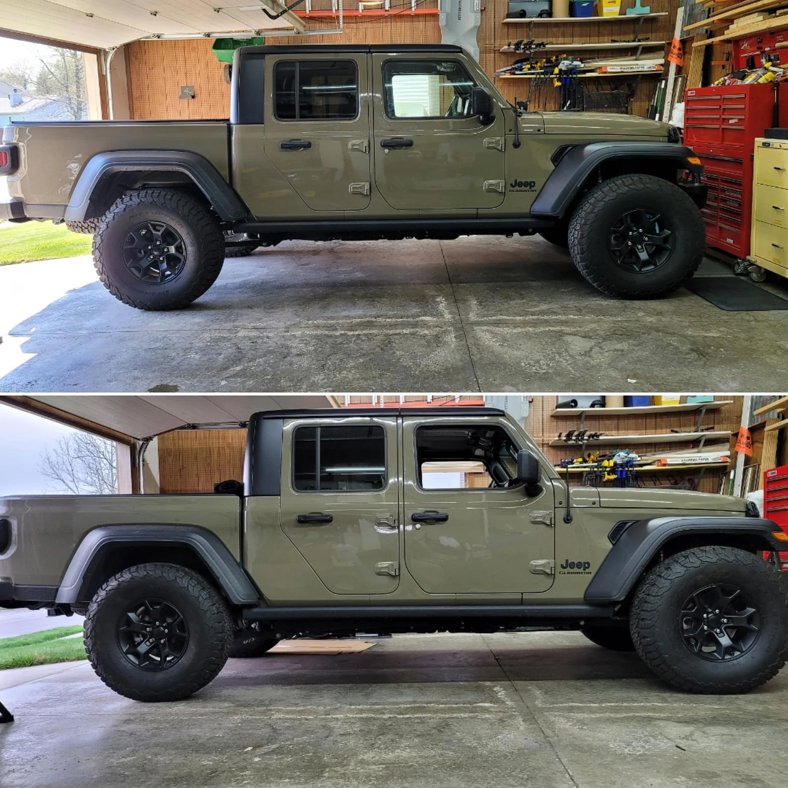

Done ✅ took about 3 and a half hours... The rear was a pain but I am happy with the results, the picture doesn't do it justice. Hopefully this will hold me off for a bit while I save my pennies to buy a real lift kit ???
