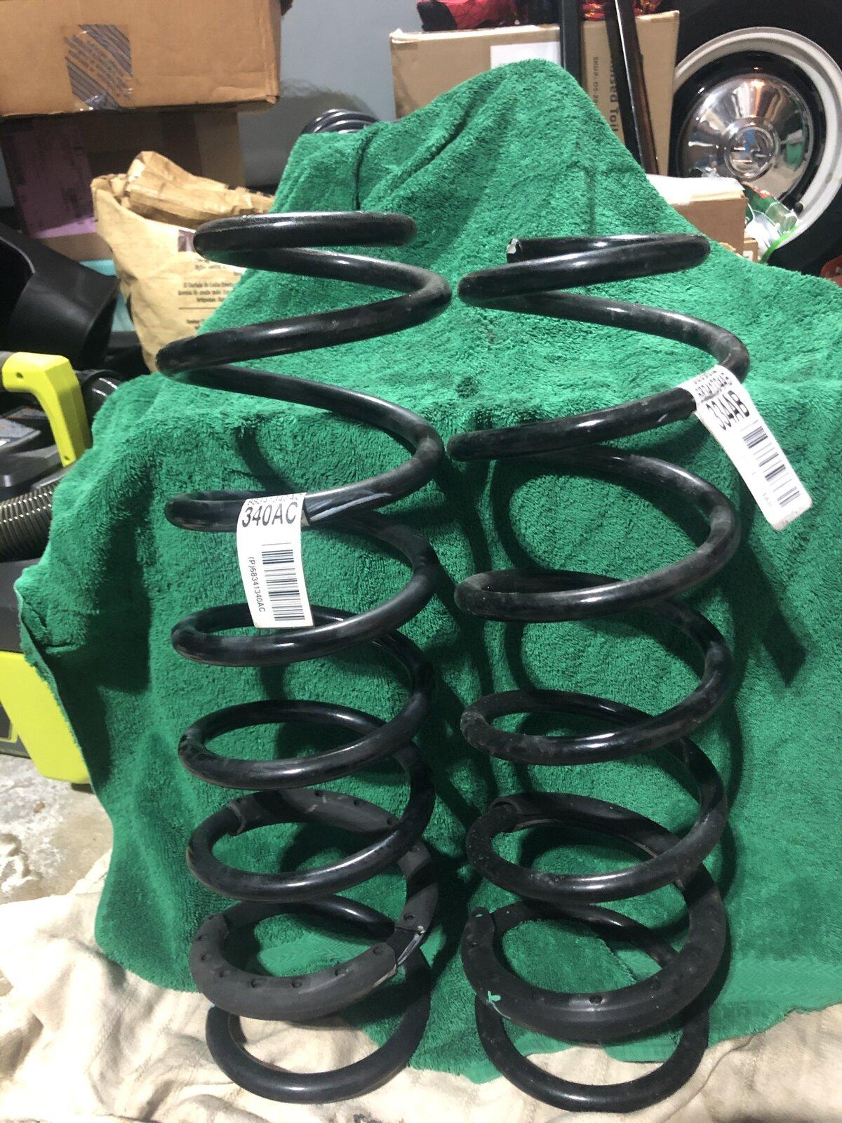

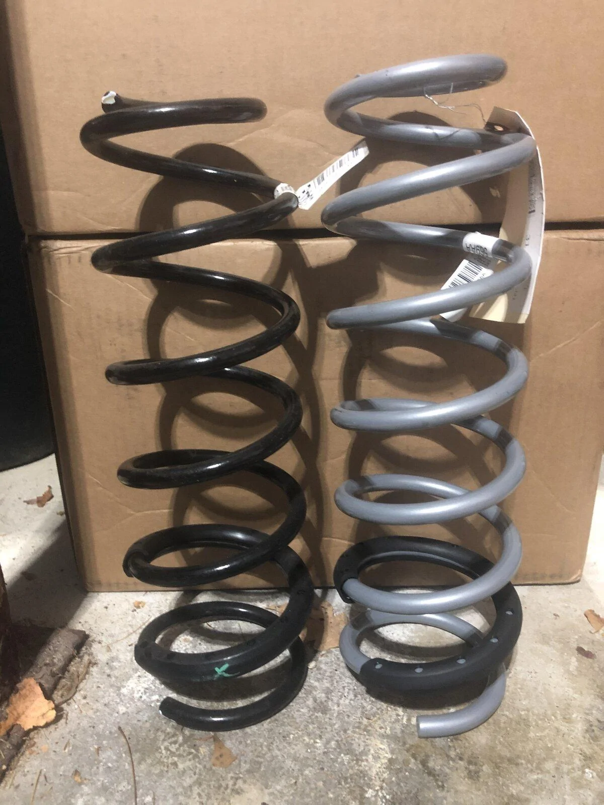

Funny, I bought a set of Mojave springs new, they they got all chipped up in shipping sent them back and got another set and it was the same thing so I gave up and got a set of Rubicon take off local. Picture of the Mojave spring next to my stock sport spring and Rubicon spring next to my sport spring. The Mojave and Rubicon springs are thicker, heavier and a little taller. The Mojave’s are grey.
