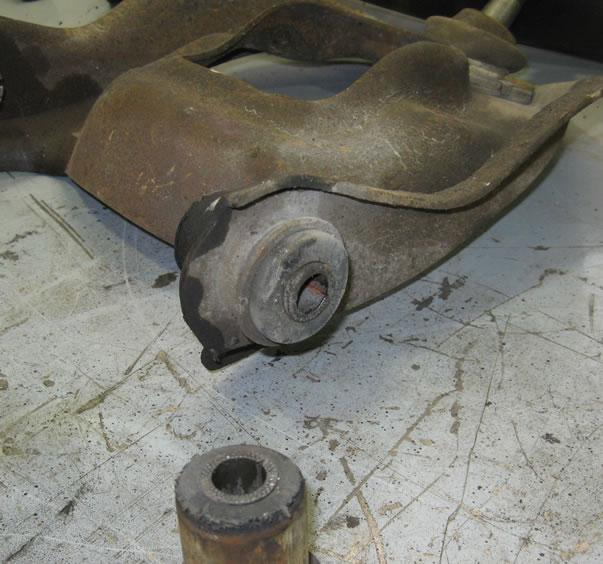

Take note of the bushings in the photo below - pic taken in 2010. The car is a 1982 Eagle, 160,000 miles on it - it was abused. The left front spring had a coil busted off, both of the leaf springs were busted the rear differential was barely hanging on. So, 28 years, 160,000 miles.
Miles and years will vary wildly. But unless you do off-roading and really push the suspension, why won't the springs go 200,000 miles and 30 years or more?
