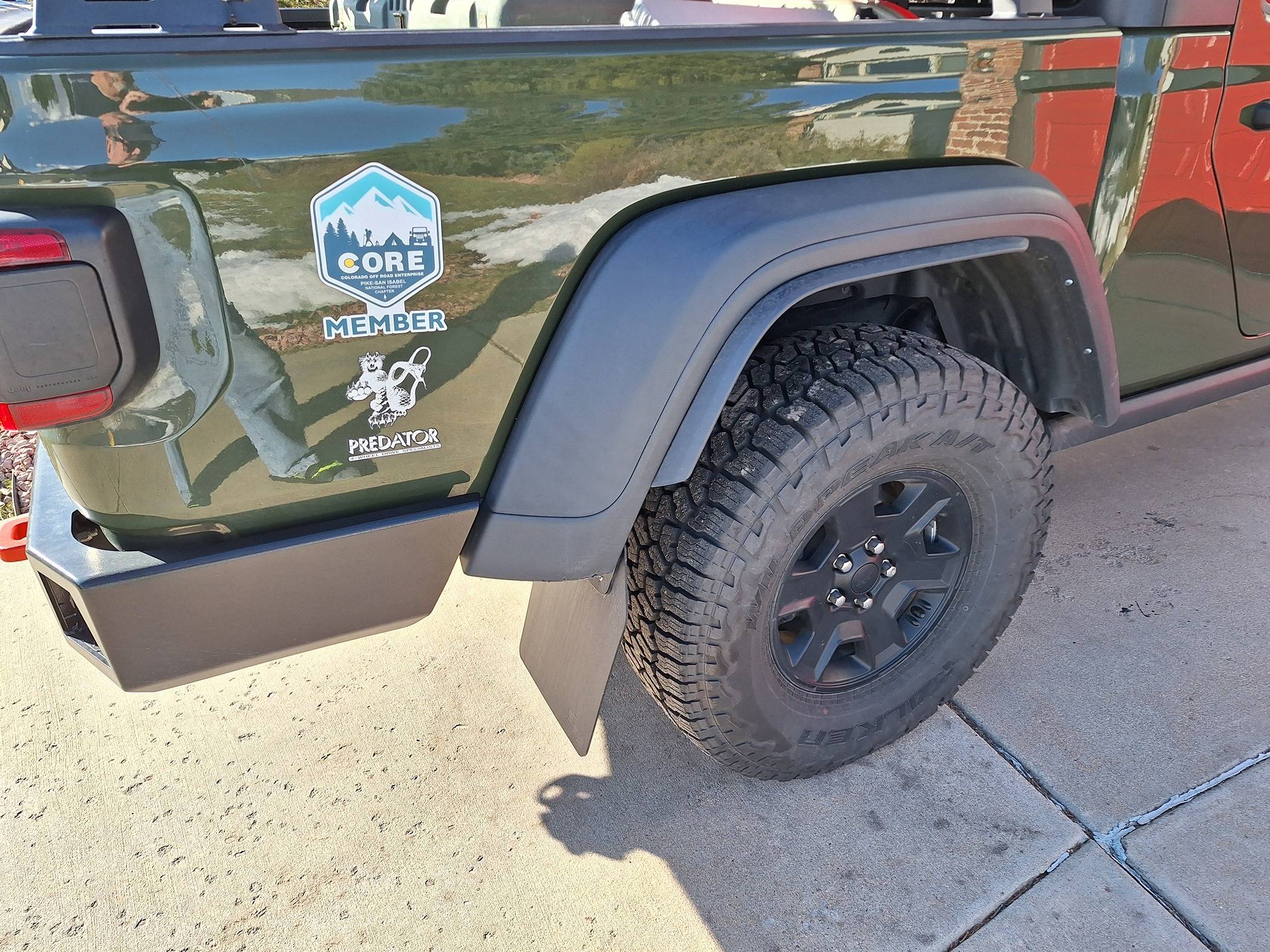

you can buy the mopar fender extensions for about 100$. Easy install and plenty of info on here. I also made a post when I did it. Adds 2ā€ to the fenders. No more sling on doors

The ones you have must be different that what they sent me. I may have 1ā€ at best…more like 3/4ā€. I lined mine up and put them back in the box and haven’t put them on yet. Unfortunately I got the full set front and rears when it looks like I need two sets of rears so when I’m ready to do it, I’ll have to call the man.

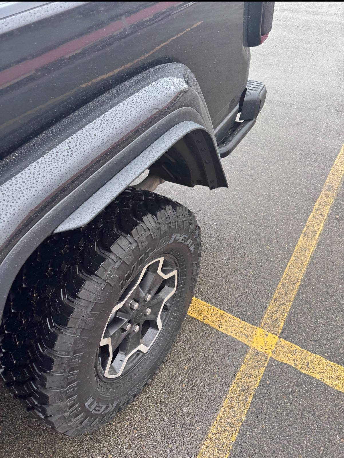

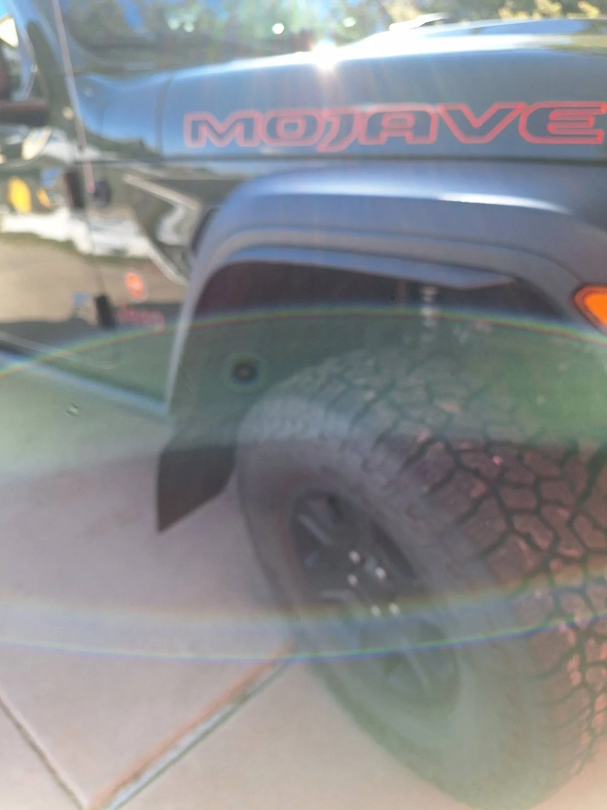

You have to notch the rears. You were likely sent two front sets. That’s just how they come.
tbh line the rears up at the bottom hole and just drill new holes the rest of the way up.
This is how mine look.
