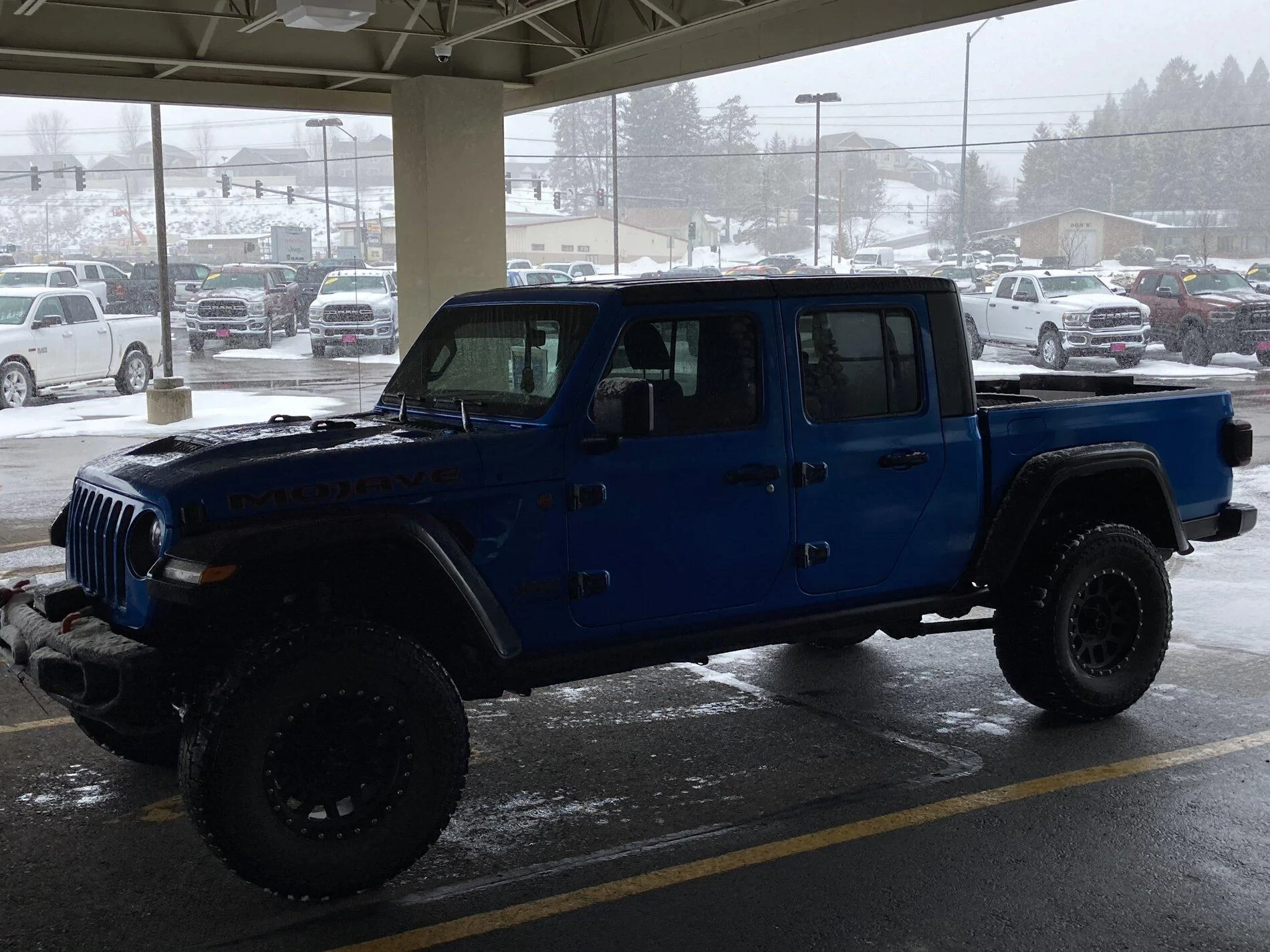

Jeep Gladiator Lifted the Mojave 3" w/ suspension parts from Fabtech, Clayton Off-Road, Rock Jock, Rock Krawler, Teraflex, AEV 5117204A-05B8-4C3D-ABE3-60C4A611AE29
This is with the 2in lift from FabTech. Rubicon steel bumper, hinge covers, Black Method Rims (5) of them, 35” tires.
Now I might have to get the 37”s soon. I am over dumping money in this thing lol.

Nice man!
Im pretty sure this lift was 3”
