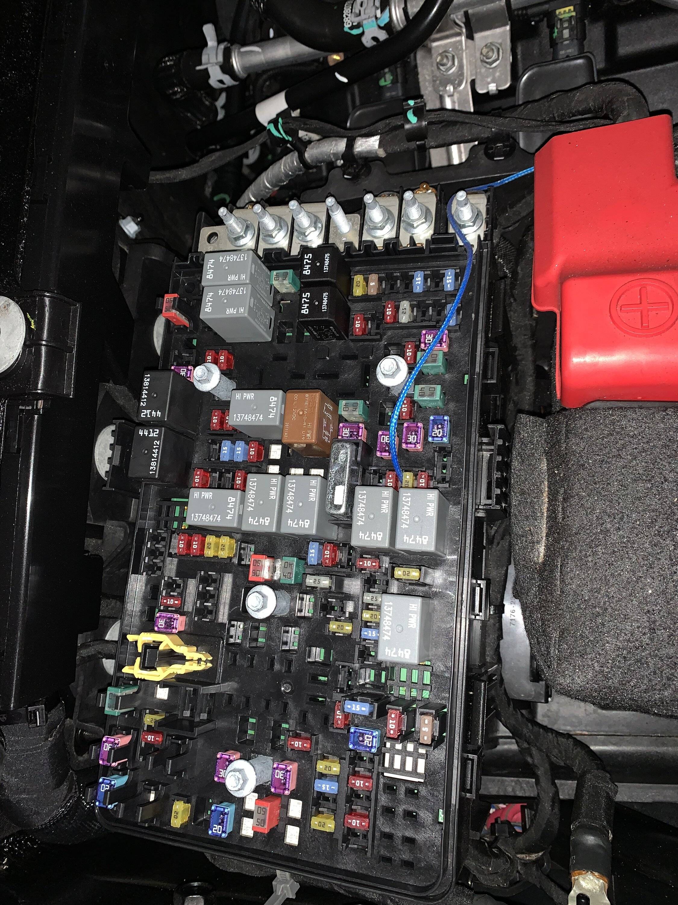

While I sit here waiting… do you guys recommend trying the relays just in case? Which ones?

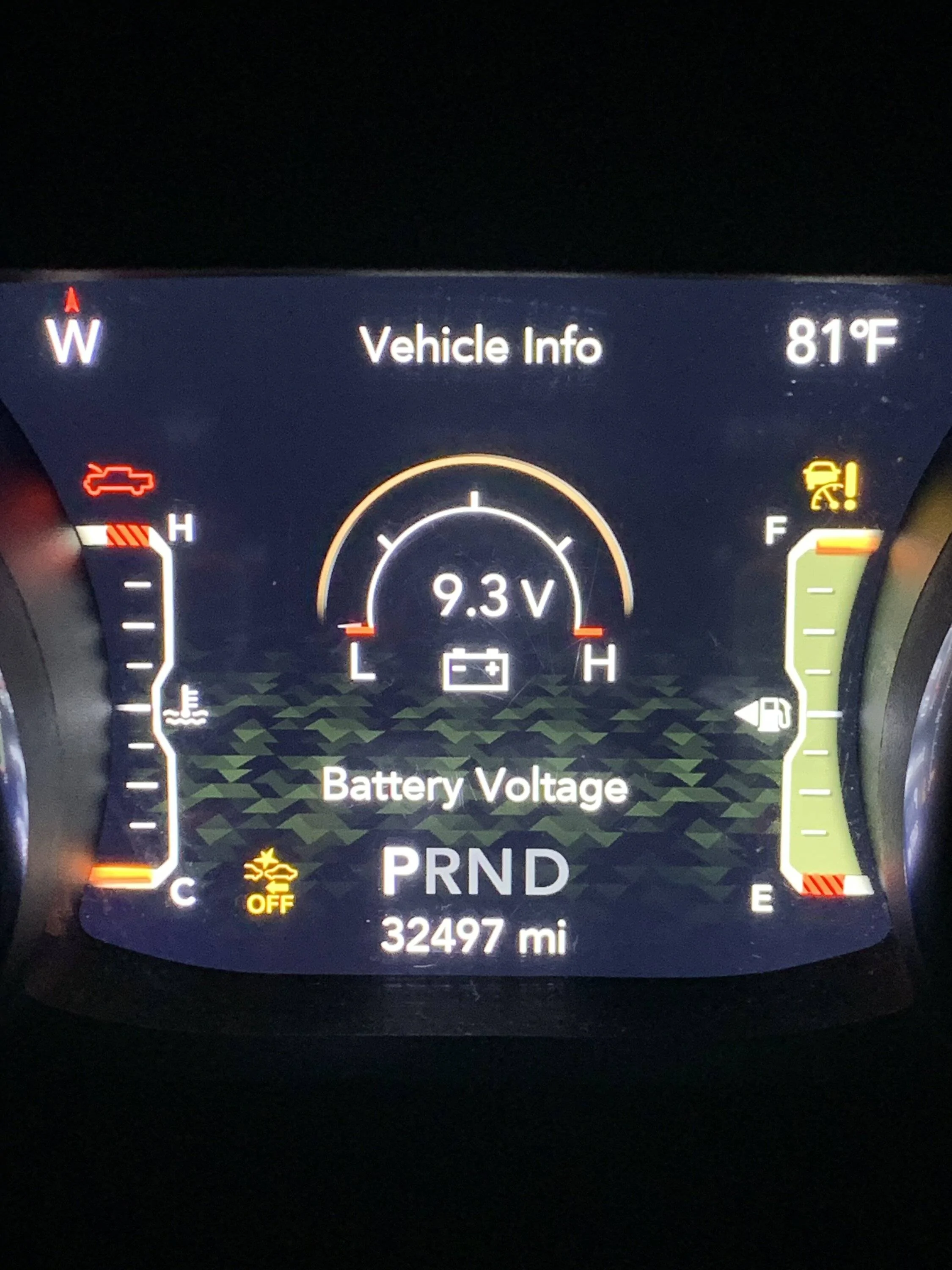

20min connected to donor car … voltage is lower.
Now it won’t let me lock it or turn off.. says it’s not on park but it is.. great!

That is not looking good. Maybe a call for the tow truck. Isolating the batteries and checking fuses would be my next step. If you throw a main battery at it, and you have a bad aux battery, you could be in the same place you are now. If you have a volt meter, you can at least test for voltage of the aux and your fuses.

Both batteries should be connected in parallel unless you had another failure. When you have the jump cables connected to the main battery it should be connected to the aux as well. One of your main fuses f3 could be blown preventing the aux from receiving a charge. Hard to say without testing with a meter.
Edit... above I said f3. N3 is what I meant to say. If this is open for some reason it could prevent the Aux battery from being charged. Putting a trickle charger on N1 and ground would charge your aux in this situation. You would not want to jump start being connected to N1, other fuses will open.

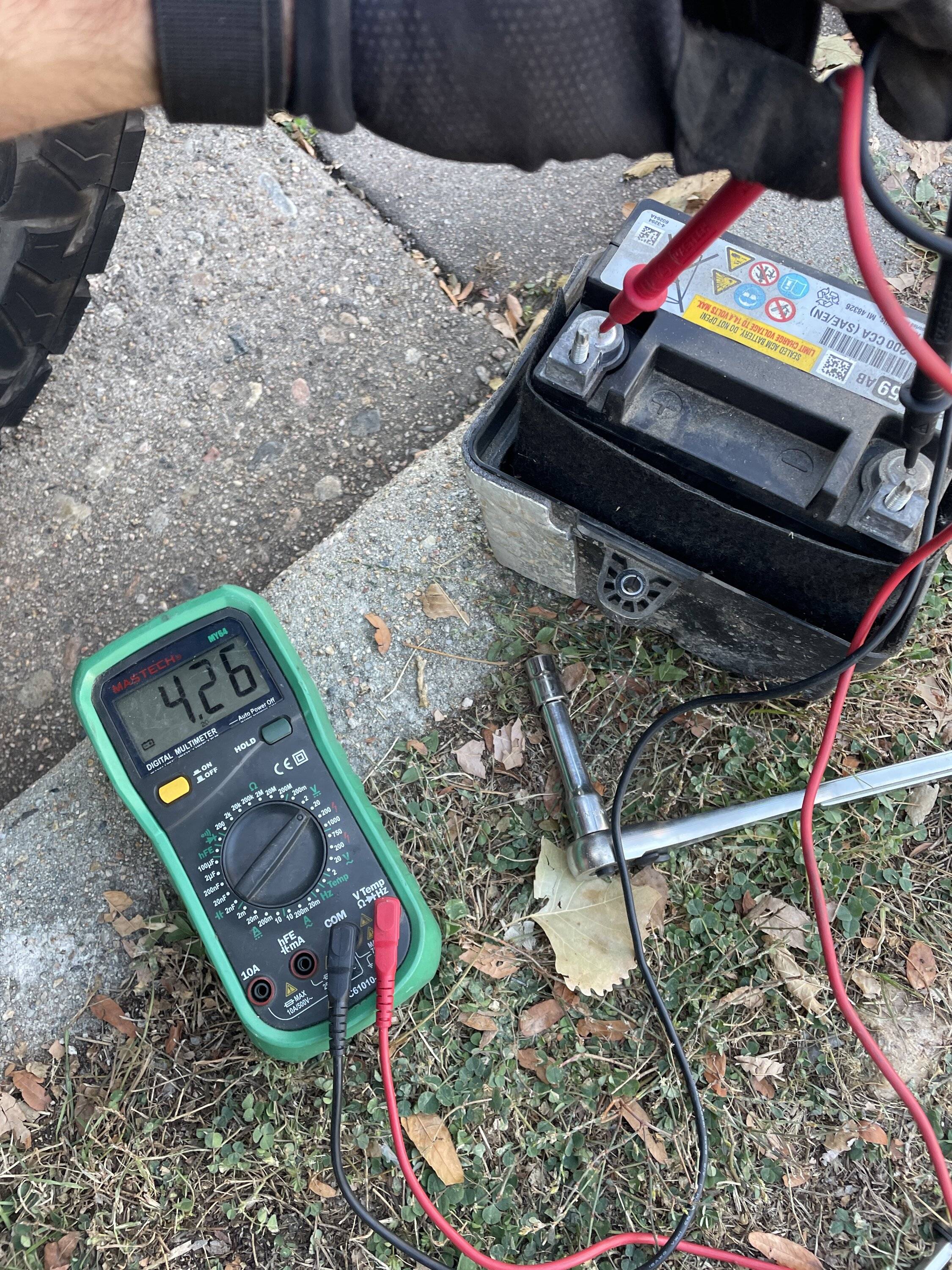

you could absolutely do this in the parking lot. I did this street parked in front of my house with the curb in the way. Just disconnect the negative terminal from the main battery before doing literally anything.
What would cause the battery to be trashed after only 2 1/2 years? 2021 with 32k miles, original OEM battery... thought they lasted around 5 years. Don't have any mods that would put strain on it either.
Seems like the aux batteries are kind of junk then kill the main. My aux is currently reading 4.2V….that is beyond dead and destroyed. Supposedly agm too, just a trash one subject to heat right by the cat converter.

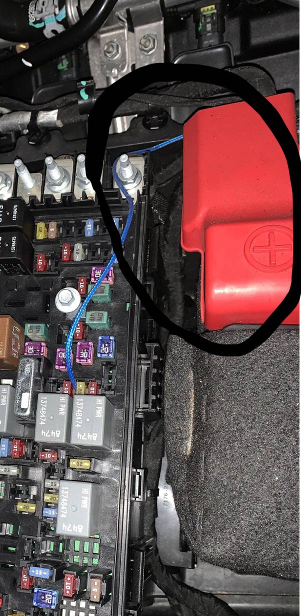

You say there is nothing extra connected - what is that blue cable going to?

Looks like my photo. The OP was just using it to ask a question.
