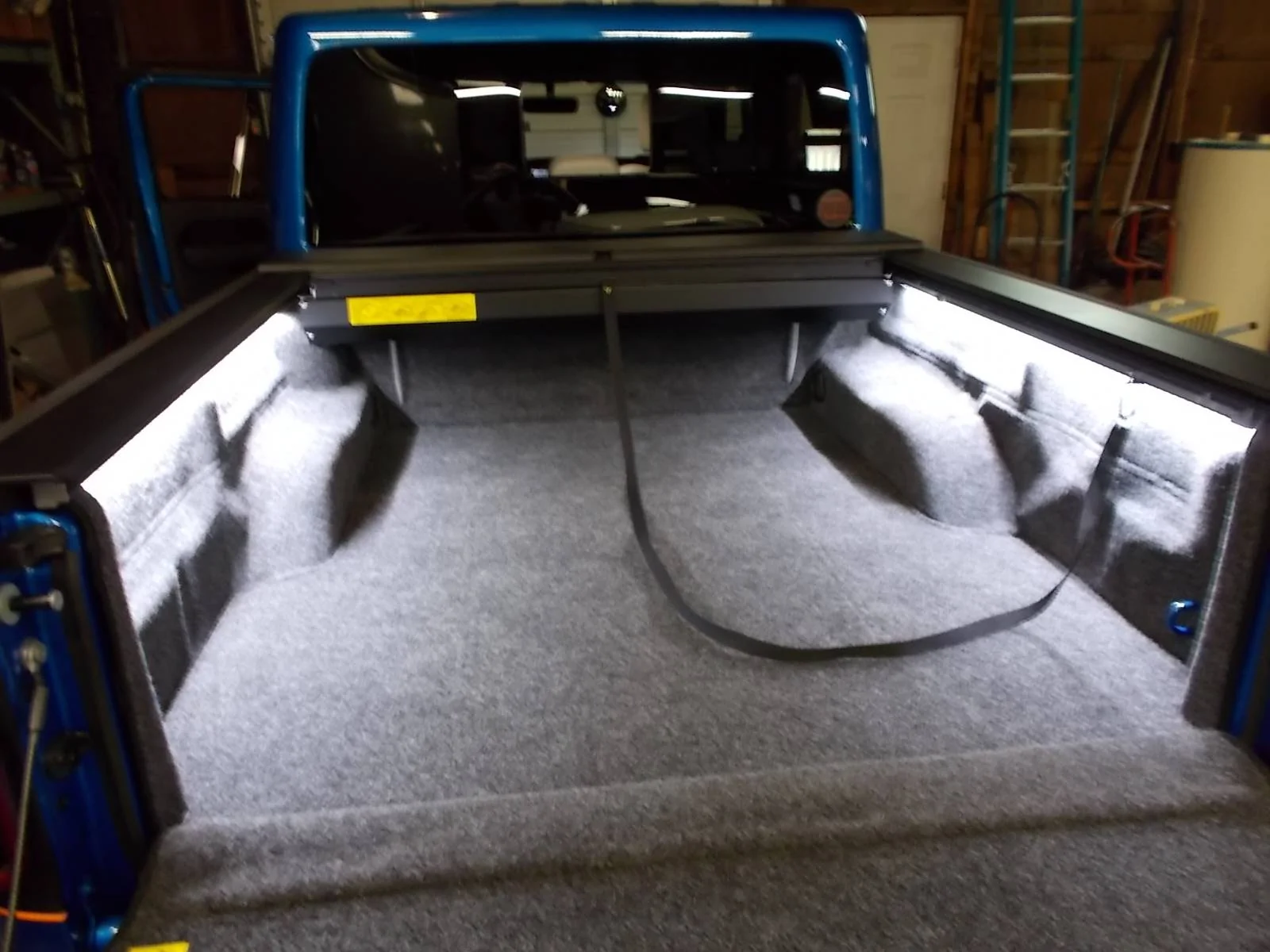

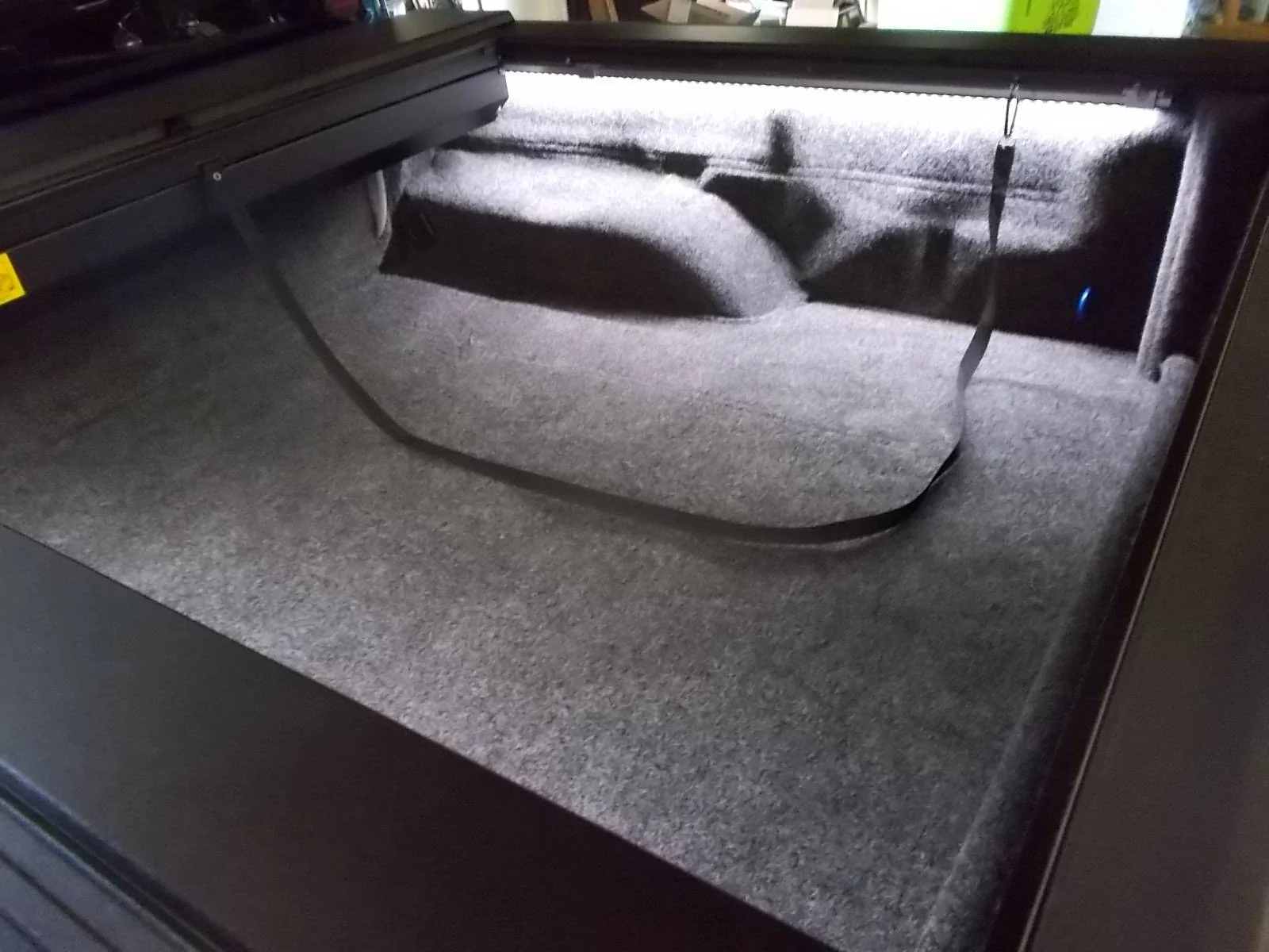

Oracle 60" LED Bed Light Strips cut to length & mounted on the bottom surface of the mount rails for my Roll N Lock.
Switched using one of the OEM factory auxiliary dash switches.
Much more usable light.... problem solved.

Yep, I did the same thing. I have them tied to the bed light circuit. With Tazer, pressing unlock 3 times makes them stay on for (up to) 30 minutes. Works perfectly for night loading/unloading or even daytime use when I don't want to roll the tonneau cover back.

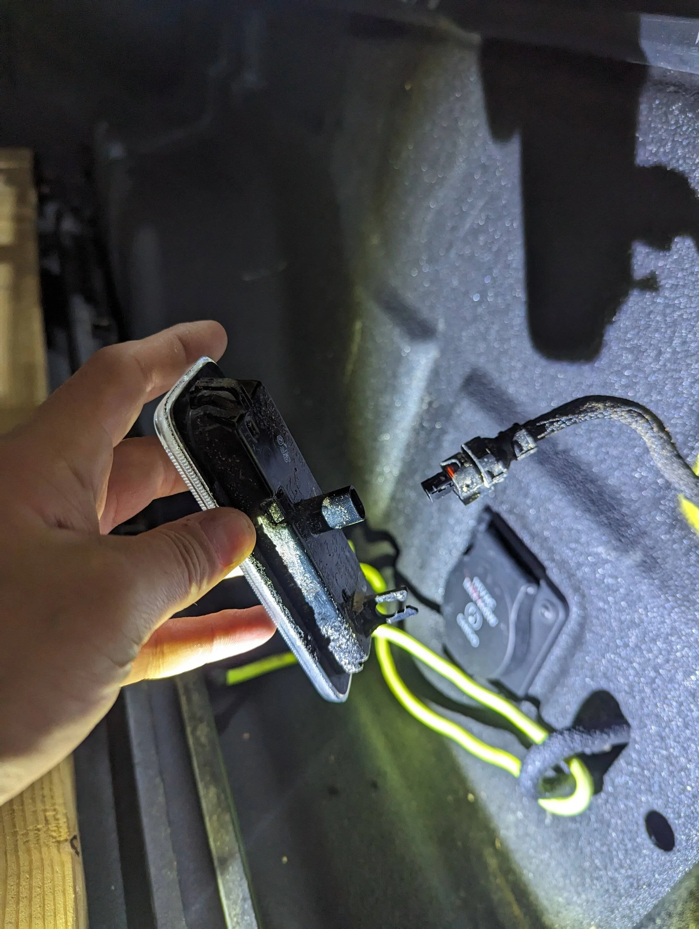

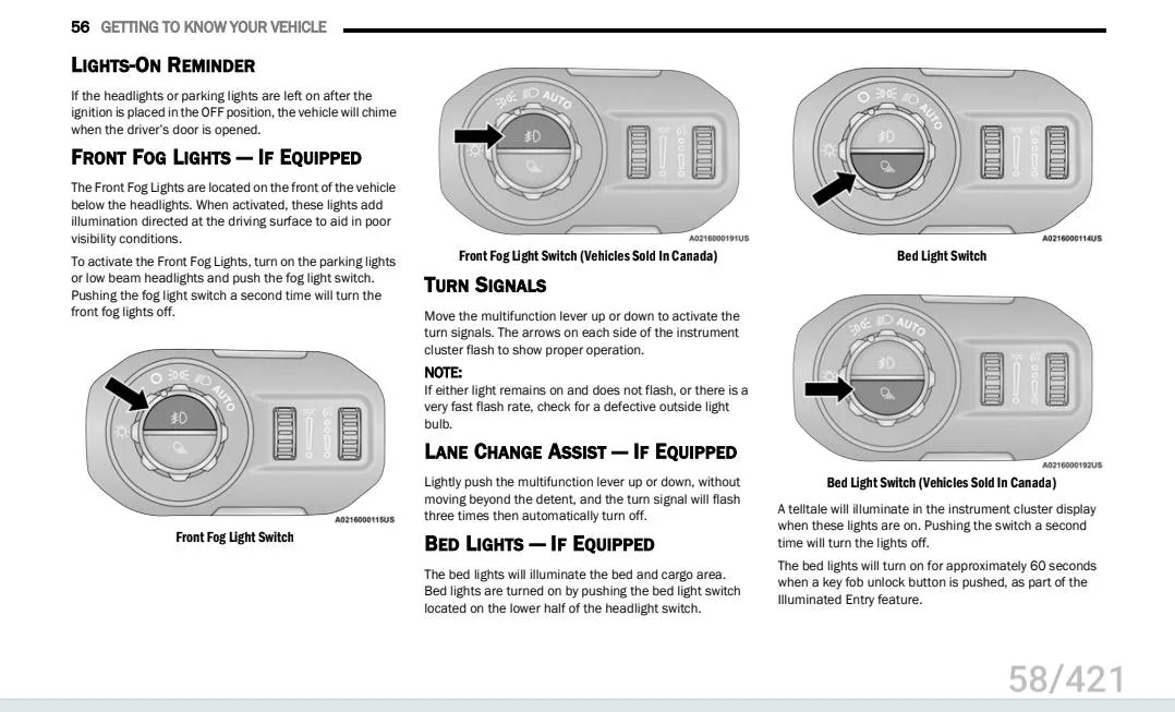

My JT came with the bed LED lights. They were working when I got the truck. They sprayed on the bedliner a few days ago; the lights don't come on anymore.
I read somewhere that I had to push the light to turn them on. I tried that; the lights don't do squat.
So how do you turn on the stupid lights?
If the following doesn't work, take it back to where you had the work done.
Left side light switch . Push the top button or lower button one is foglights the other bed lights .
