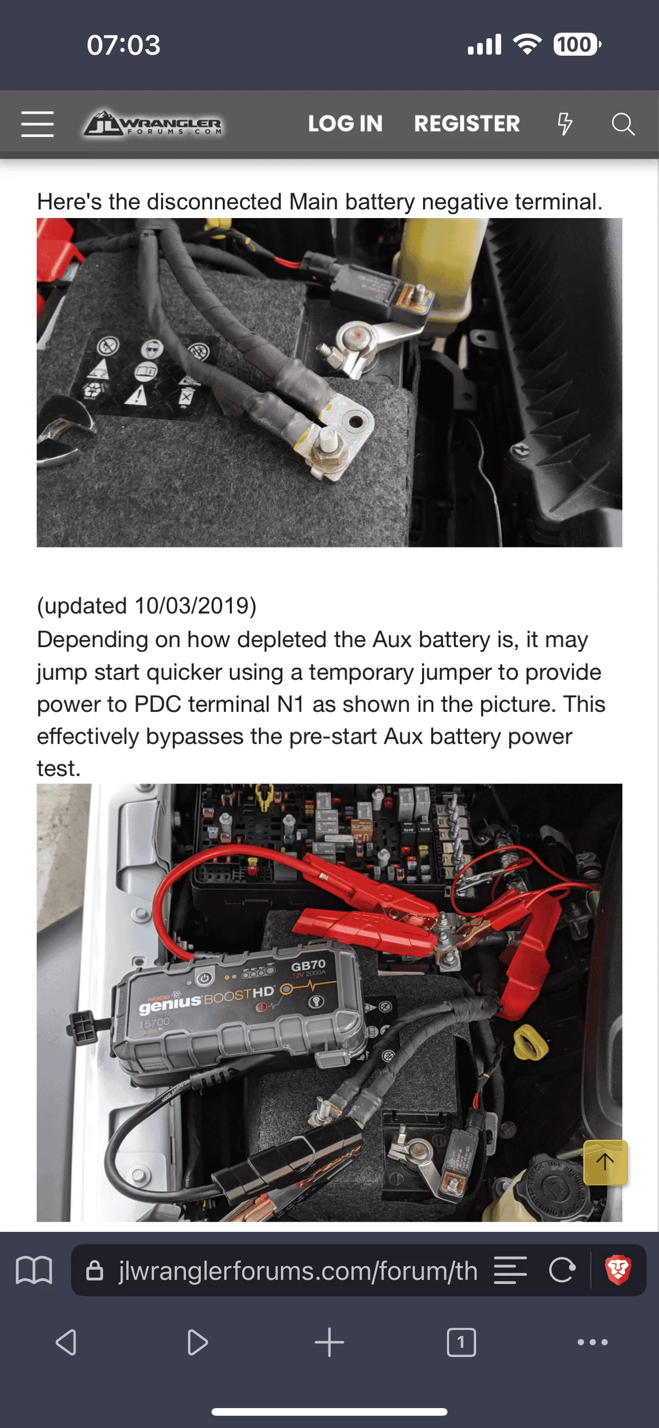

Here’s one I saved that shows the mini-jumper cable to expedite jump starting. Haven’t had a need to use it yet, just saved the photo

I’ll get a meter tomorrow. Are you suggesting I clamp to both f1 and the main? Or directly to f1 only?
Edit: I misread your message, parallel should be its current state, meaning it does both at once. Copy - eyes are burning from research.
A meter will be very helpful. Check N1, N2 and N3. They should all be the same. If not, you have an open fuse or open pcr. If you put the positive jumper cable on N1, you can put a charge on the Aux, but don't try to start the engine. Too much current will be going the wrong way.

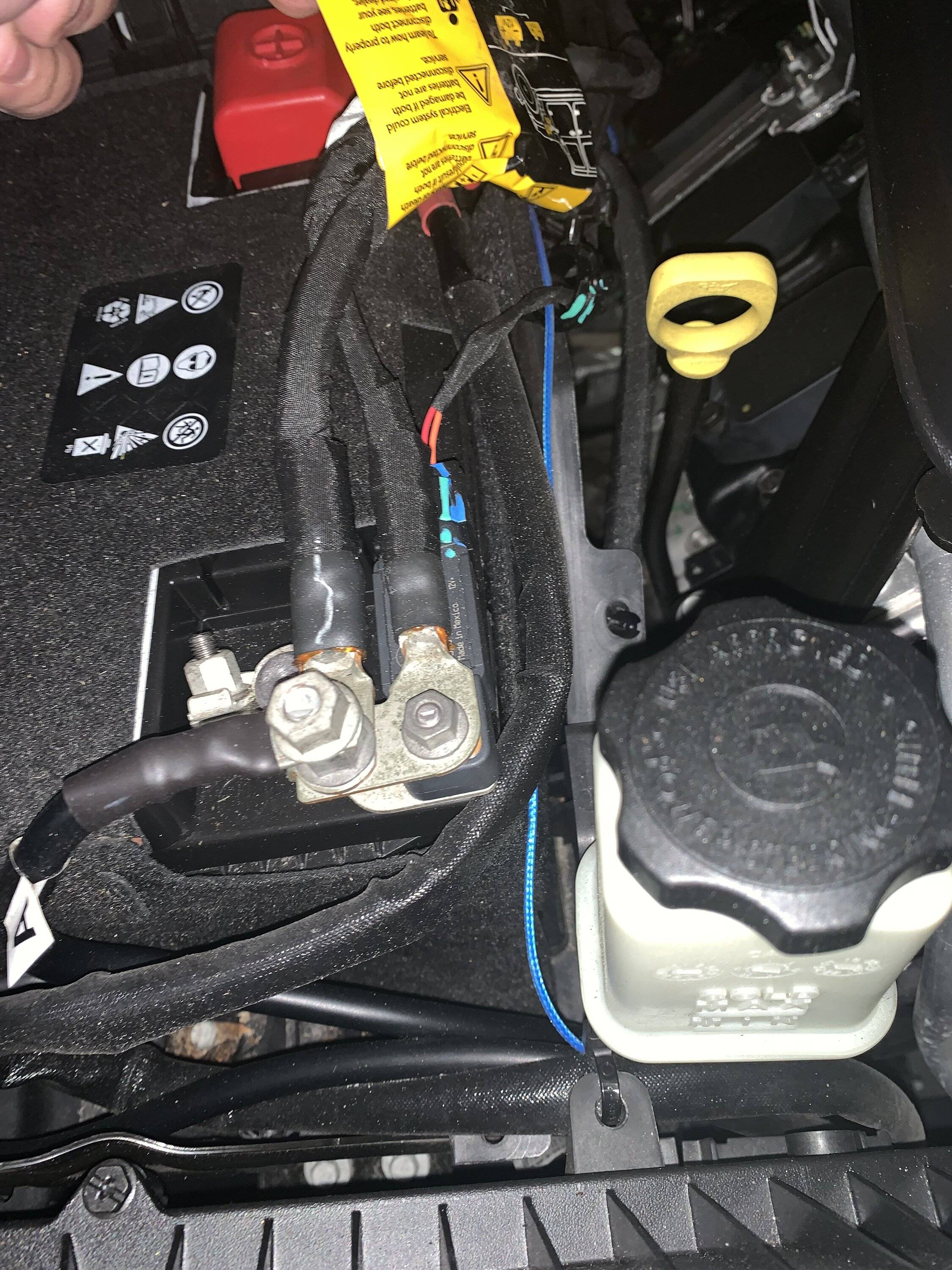

You say there is nothing extra connected - what is that blue cable going to?

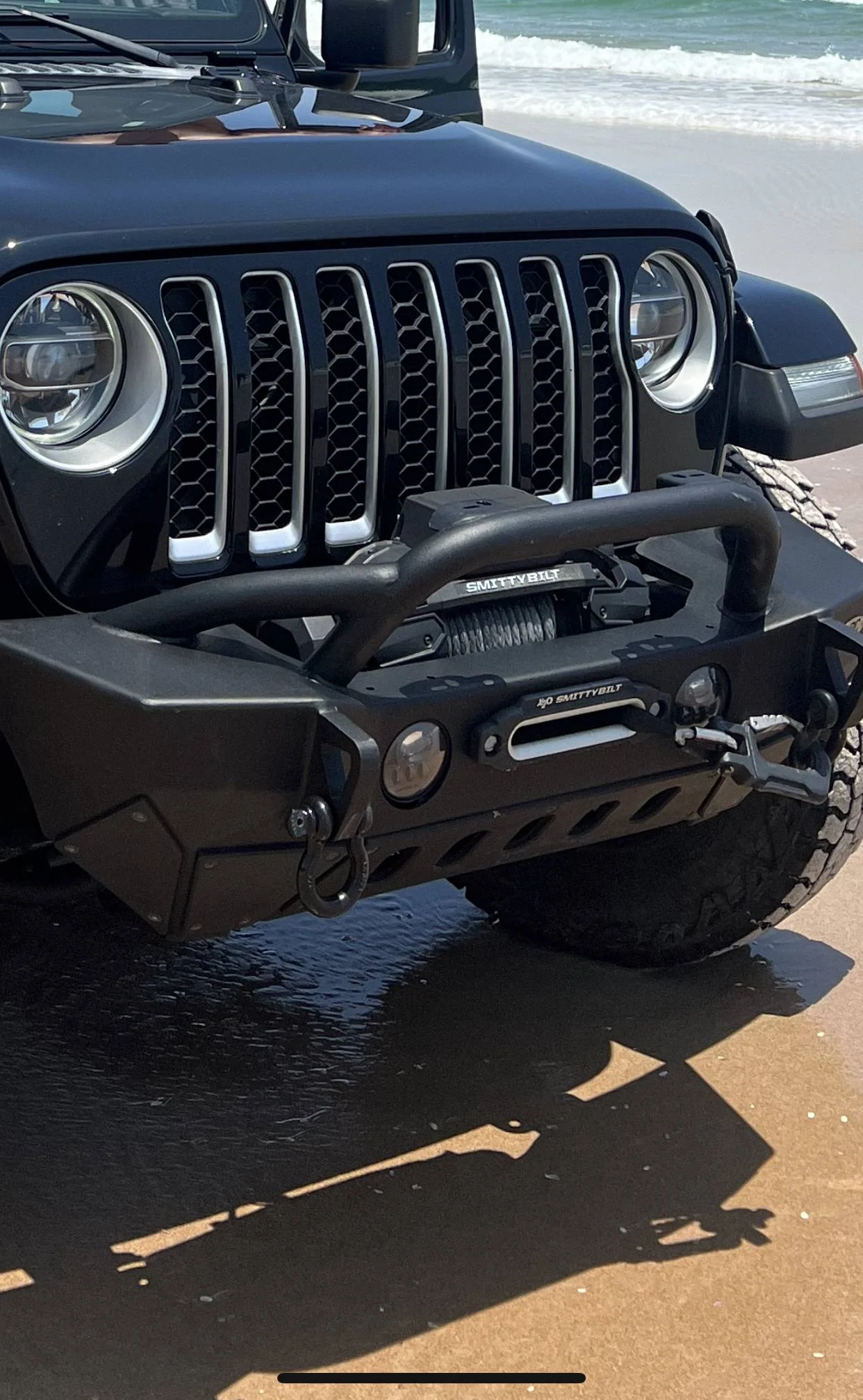

I honestly don’t know, I would need to get under it to see where it leads. Maybe the winch with fog lights? Bought it used, only one owner.
I was under the impression the fog lights on the front bumper were powered by the winch, could be wrong.

Well, one thing is sure. You will need to learn more about how all this works (its not really very hard) once you get it back running and sorted out.
I thought you said it didn't have any electrical mods, but now we see it has a winch and aftermarket fog lamps. Sometimes, electrical mods can cause issues it not installed correctly.

Thanks for the update. By the way, your winch is powered by your vehicle battery. That box on top of the winch is just the control box for the winch, it is tied into your vehicle battery.

If it came with OEM fogs then it would run from the panel switch. The winch probably has a relay to energize for it to work from the main battery. If it is connected to the aux battery you wouldn't be able to pull yourself out of a parking space.
