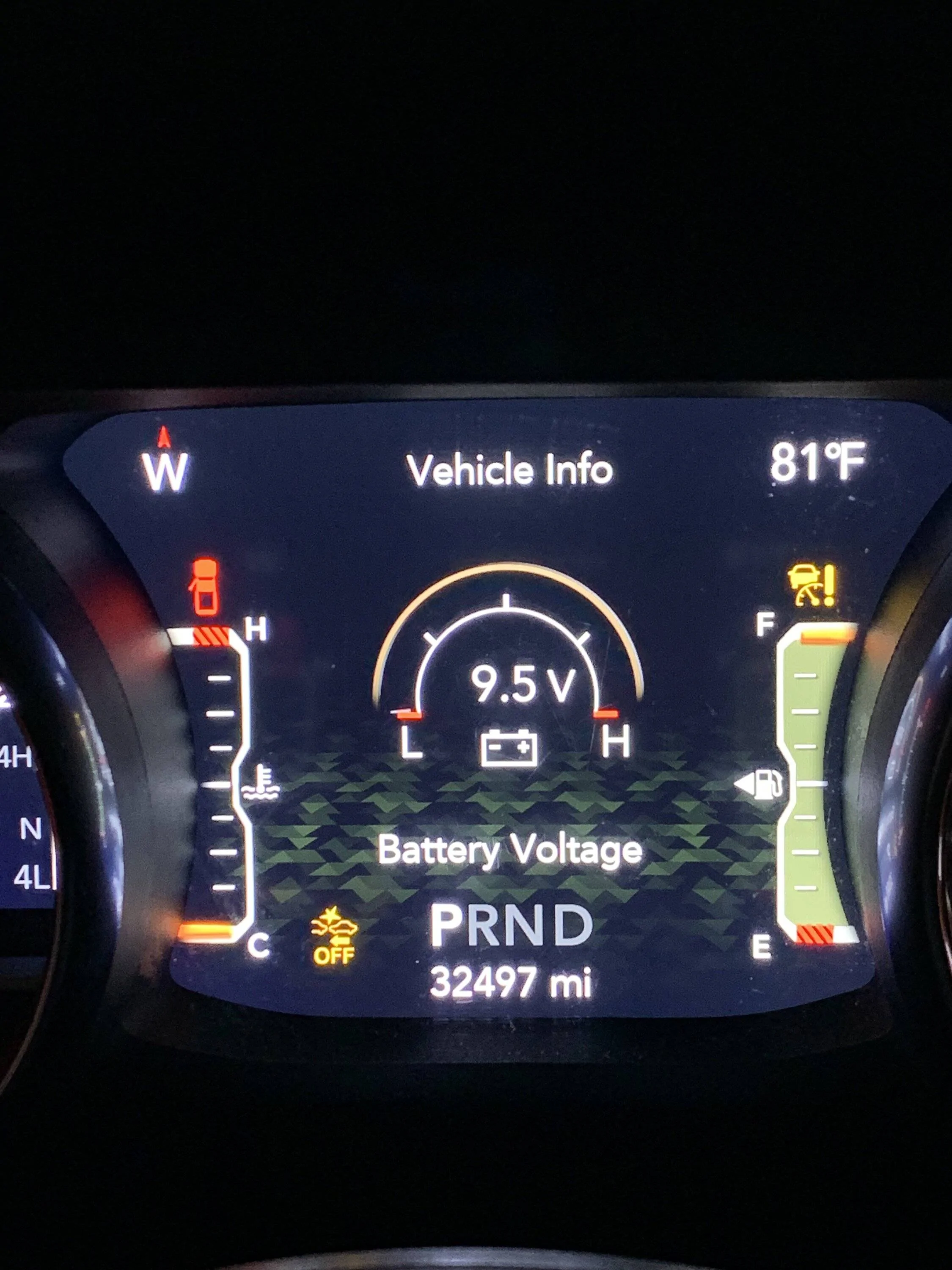

Update time folks... picked her up from the dealer. They swapped both main and aux, covered under warranty. Runs just like she did before. ESS now works as normal, 14V while driving then 12.4V when stopped. If I do disengage ESS every time I get in the car, will that cause issues again with aux battery?
Funny enough... fog lamps on aftermarket bumpers work now... also, I had noticed the lock button on the driver door would sometimes require 1-2-3 pushes for it to actually work. Now, it's picking up normal one touch and go (not sure if related though).
I asked for a diagnosis of the vehicle, but they said they need to bill Jeep for the service then will email me the information ... wonder if I am home free or if they still have time to argue the mods vs warranty... though, it's just couple batteries, nothing major or expensive.

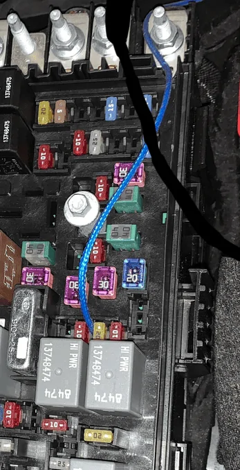

I am inquiring about switch and let's see if they'll honor it. I will also do more research to trace the connection to make sure everything is correct per @djthumper and @kb5zcr recommendations.
I did quickly watch a install video and noticed they also had this blue cable - based on the comments section, it appears it's supposed to light up the logo on the wich... haven't confirmed if this is true or not and will do more research, but it does lead to the fuse box here.

I don't like how that wire is terminated in the TIPM. I would rather see a fuse tap used and that lead fused correctly. Between you, me and the lamp post, that wiring is a hack job.
Their response was: The blue wire illuminates the light on the front of the control box. It usually is wired to a fuse or headlight wire so that it only comes on with the ignition. It can be wired directly to a power source, but a fuse is always recommended.
They are also sending me a switch replacement for free. Let's hope that does it - will inspect connections prior to switch install.

That is good news.
What I would do with that wire is get a fuse tap and use fuse 52. That is an ignition controlled fuse and it's the one recommended by many manufacturers for an ignition con trolled source. This way, you get a solid connection, and the ability to fuse the light.
It looks to me like the installer just wrapped the wire around one of the fuse prongs and shoved it back in. OK for an emergency but not for everyday use.

Will do as you instructed and advise - the winch doesn't illuminate so clearly the rigging ain't good anyway!
